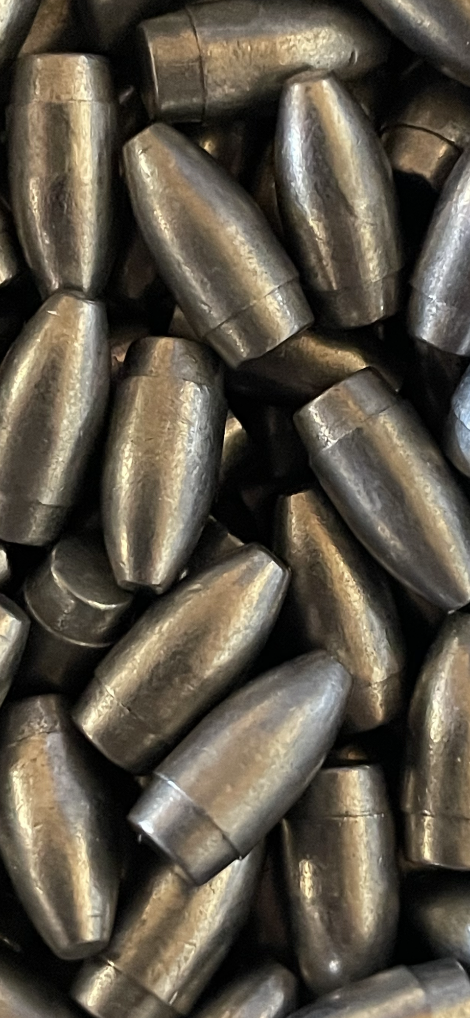

The ShortRangeTarget slug is a pure lead 40gr .2185" design that Is made to excel at 50y BR from airgun barrels.
The slug exhibits a G1 BC of between .140 and .150 at 50y using velocities of 750-900 fps from an appropriate barrel. Twist rates from 1:15 to 1:17.7 are needed depending on elevation. It tracks extremely predictably in the wind and this will be the slug Team USA will be using for the 50m Unlimited class at the World Benchrest championships in Finland this year.

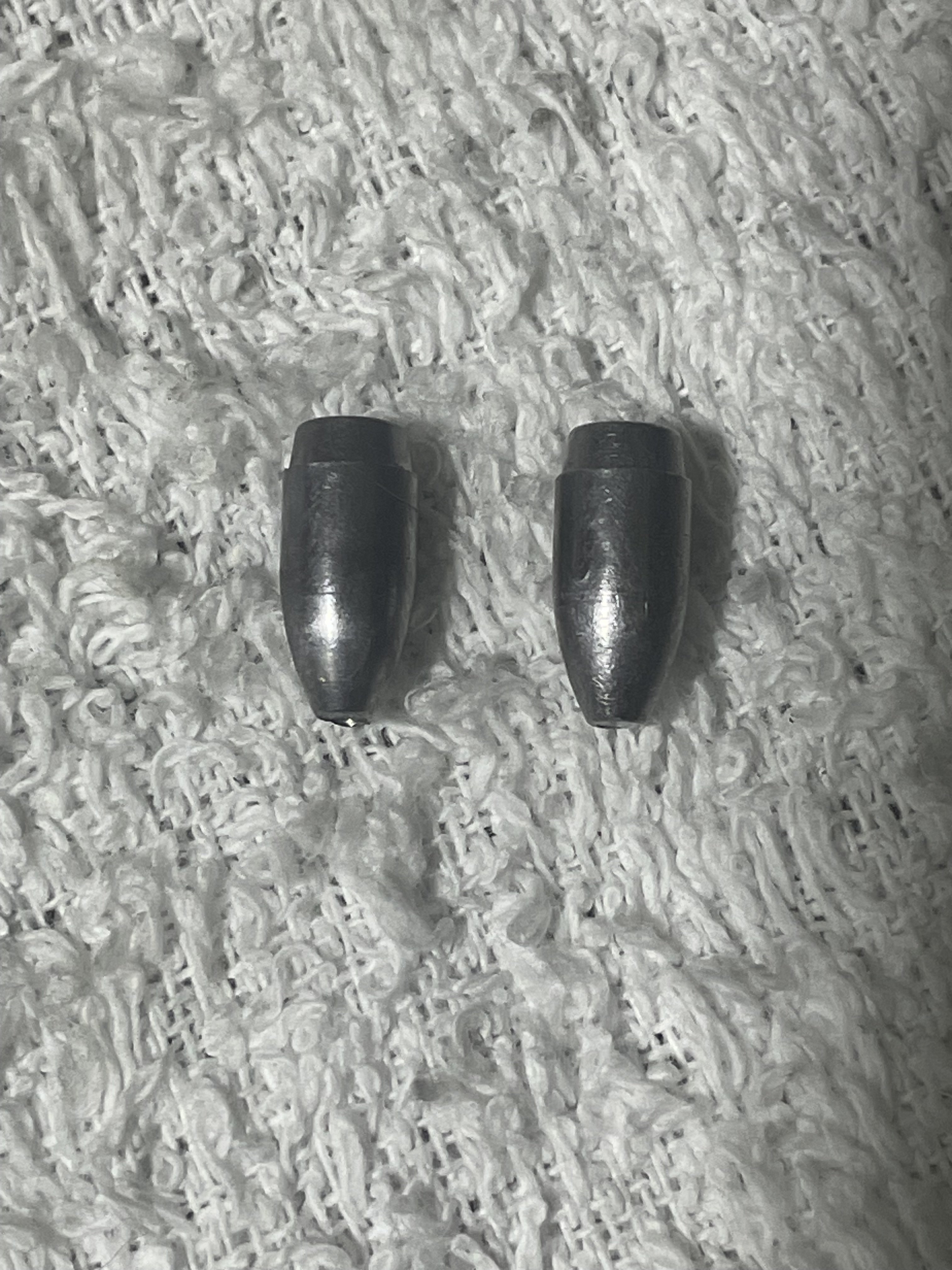

The Thomas slugs are formed, tumbled, then final swaged.
If you swage a rebated boat tail in one pressing...you trap air in the die. When the air escapes...and it will...it tears a section of the shoulder. It may look 100% intact, but it will crumble off with very little effort. The best situation is that the small piece of lead that is separate from the main body falls off prior to shooting. The missing piece doesn't cause huge problems, usually. If the piece comes off when chambering and gets between the slug and the barrel its usually a massive flier.
After the first forming press, the slugs are tumbled so all the pieces are forced to fall off. On the final pressing there is no air trapped because the slug is already fully formed....but just a little bigger than final. The slug shoulders will now be solid and if you throw the final pressed slugs in the tumbler again you will not find any of the crescent moon slivers that are prolific on the first tumble.
You can take 2 seperate pieces of lead wire and press them into a single slug which will look flawless and even stay together with mild force. It will separate with enough pressure, though.
The slug on the left is 2 pieces.

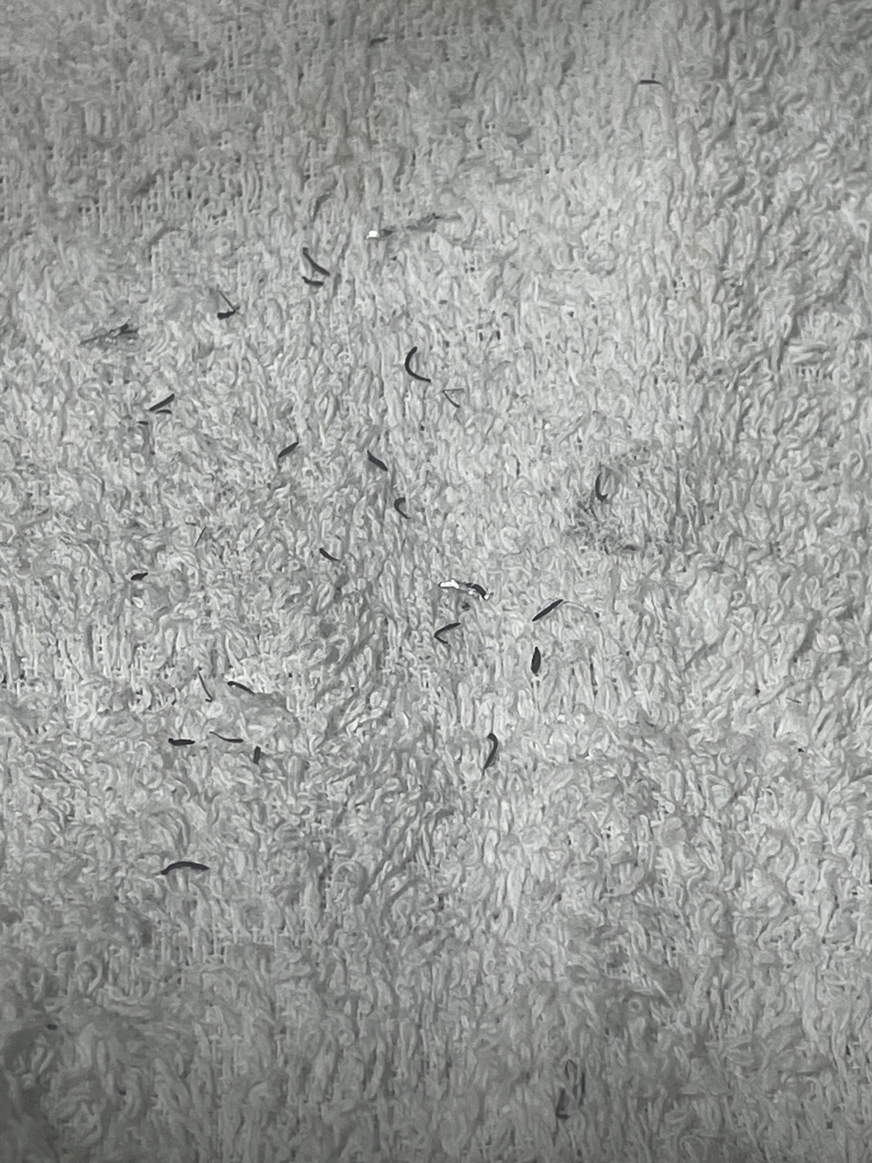

The little slivers in the other pic are the shoulders that appear attached but fall off after tumbling.
There are things you can do to minimize the air problem...but it's not 100%. Tumbling and repressing are a 100% solution.
