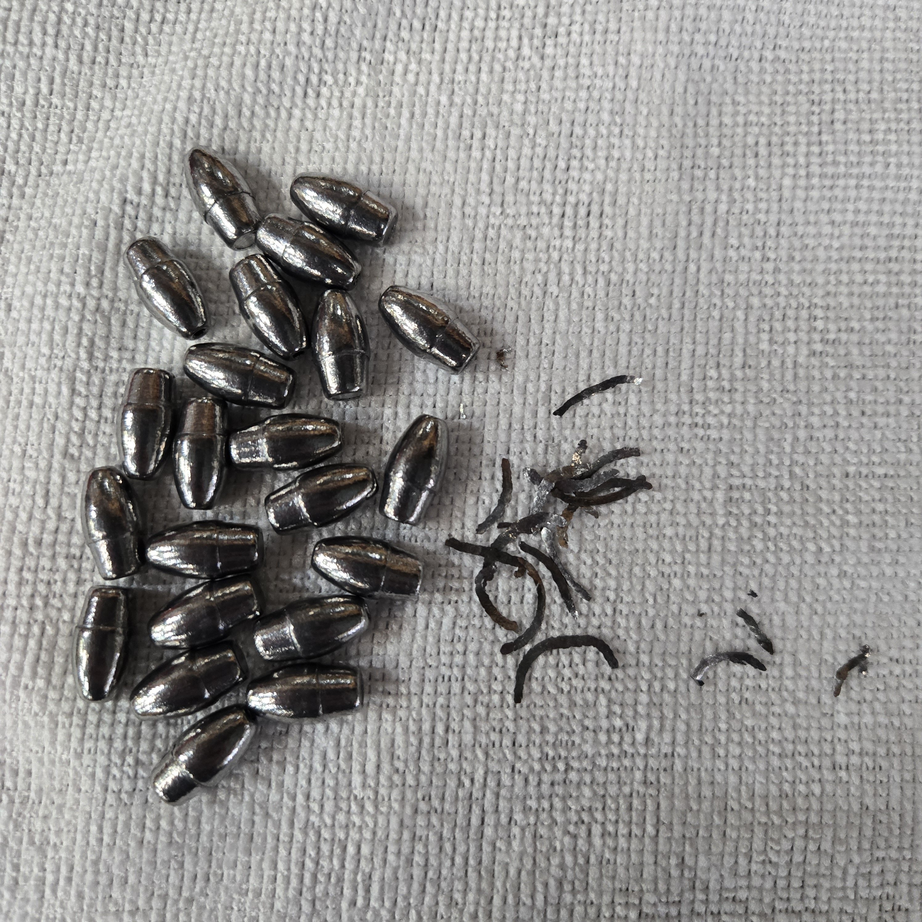

Wow. I just tumbled some of my .357 135gr slugs. They were all clean when they went in. This is what they looked like after.
