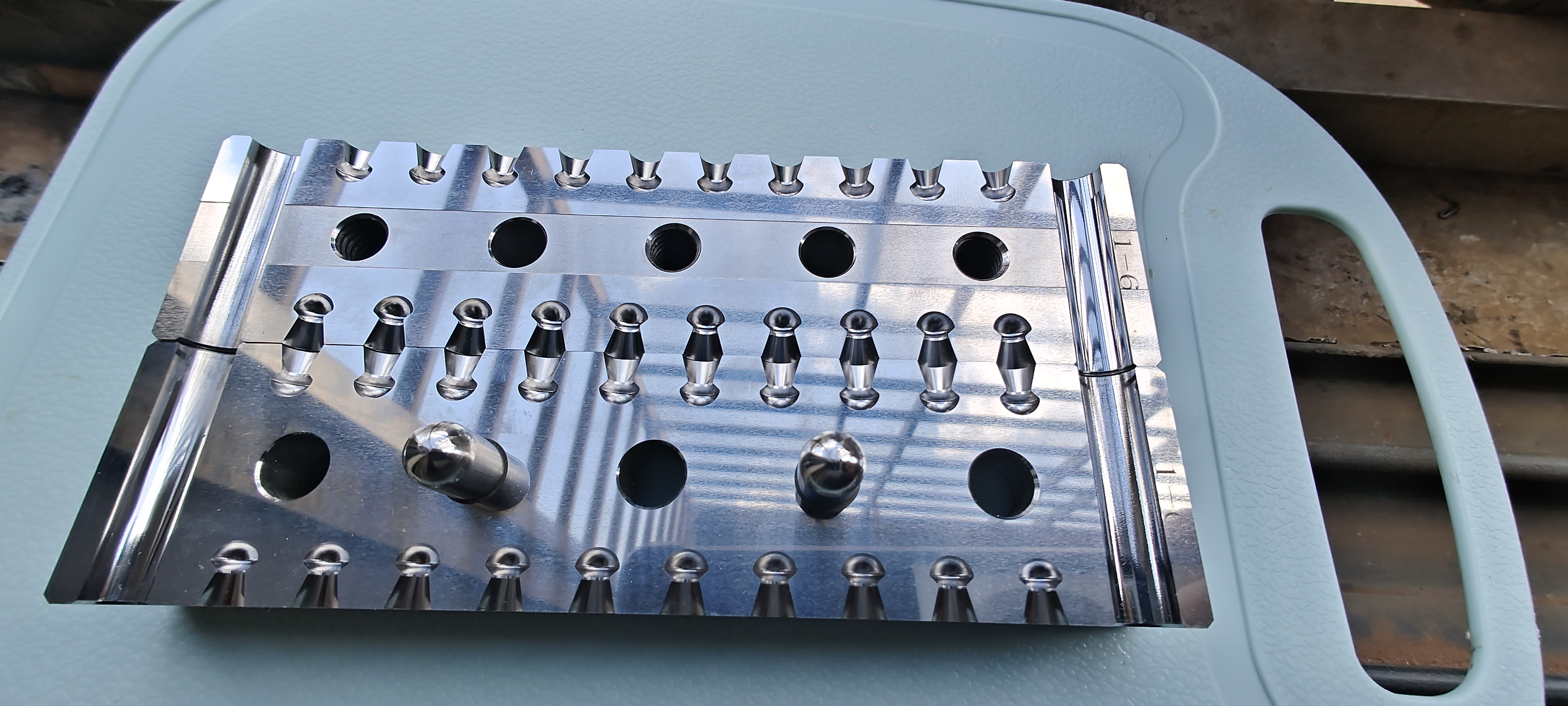

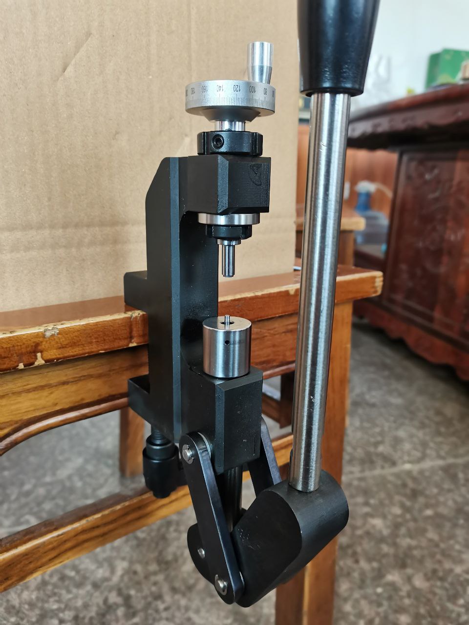

Thank you for your attention to ThorMolds. We are a company registered in the United States and are produced in China. I have been making and selling molds for 5 years. I will officially join the AGN Forum in a few days (approved by the forum)
When I officially join the AGN forum, I will give away press slugs and pellets molds to everyone, thank you
Will your product be sold and shipped in the US? Or will shipping be direct from China?
