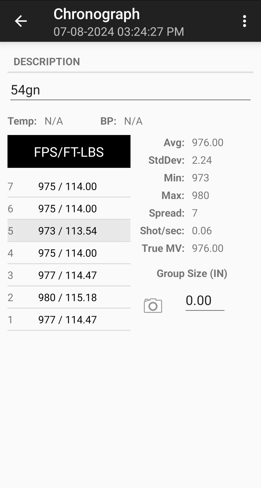

Although another step and expense, you could try a NOE resize die. Take a .305 and polish it up a few .0001@Ta-Ta Toothie No Complaints here either, slugs have been consistent. Only complaint was die was too large. The Vulcan 3 was supposed to be .3063 but mine actually is .3055, I slugged my barrel. Stupid me should have done that first before ordering the press so that is why the slugs are so damn tight. As long as I shoot light slugs the breach closes ok but I do like shooting 65gn slugs for more penetration on coyotes but haven't seen a damn coyote forever so no biggie. Closing the breach on a 65gn slug is way too hard, afraid I'll bend the probe so lighter slugs it is. They still group great. Here's what I'm shooting now ...54gn
