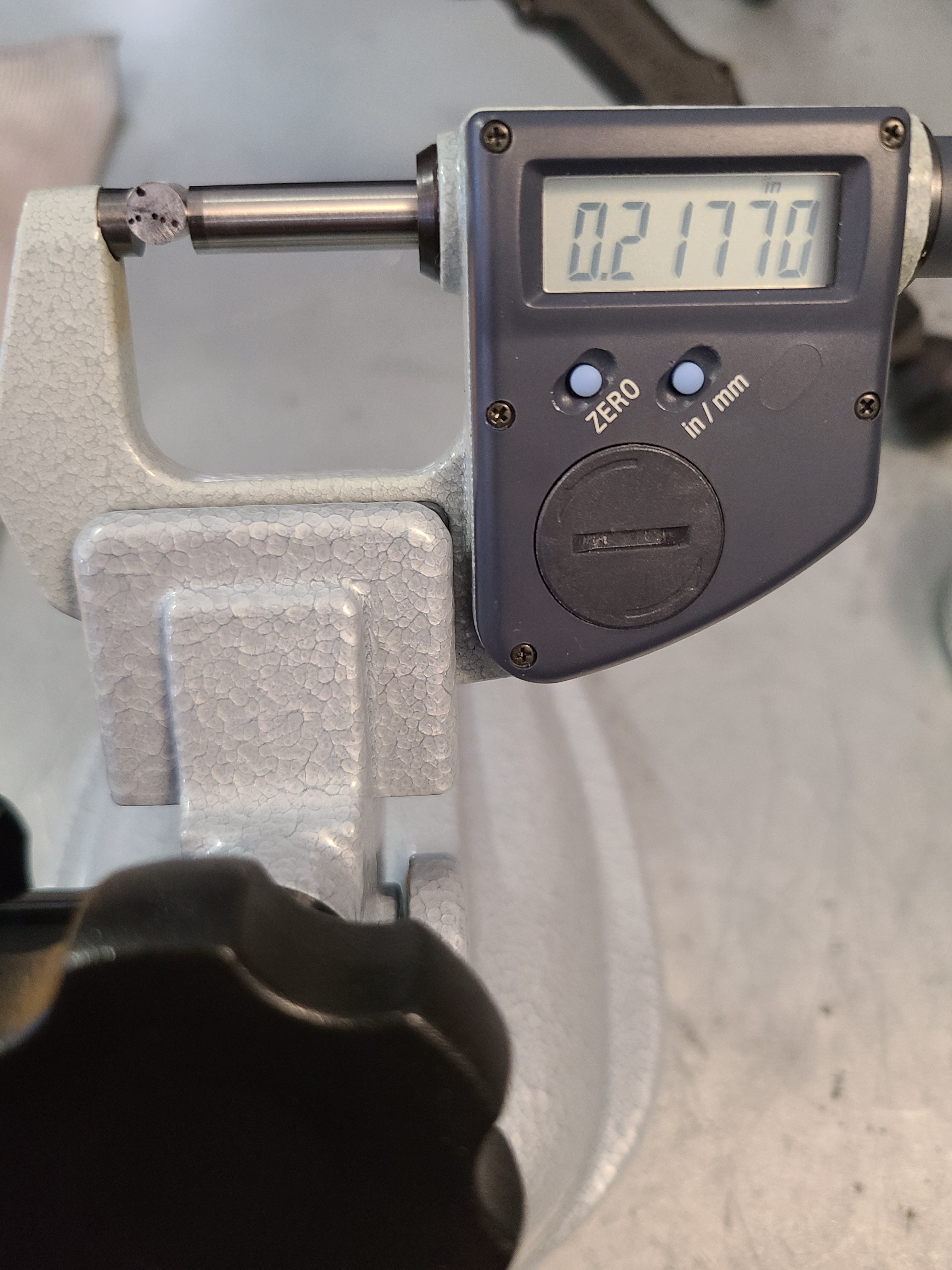

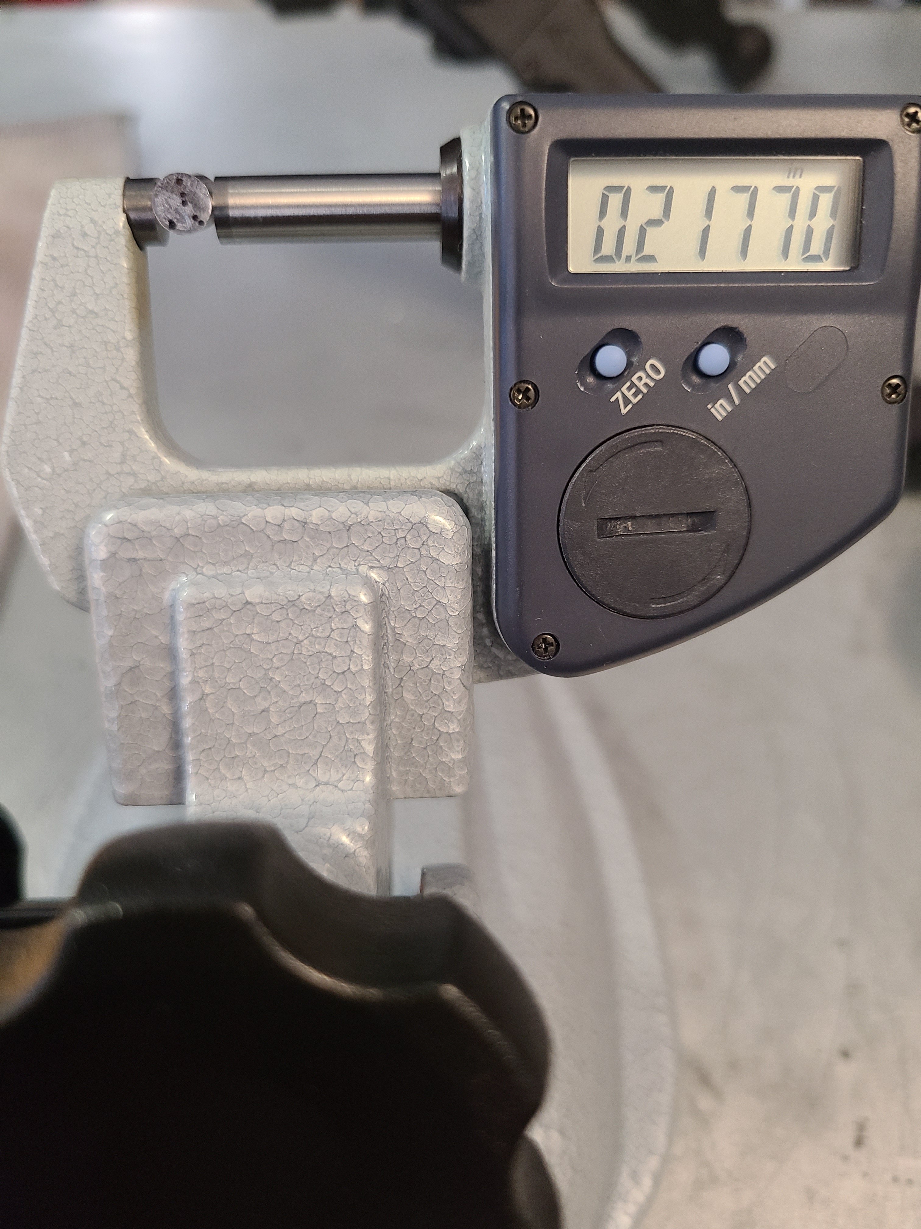

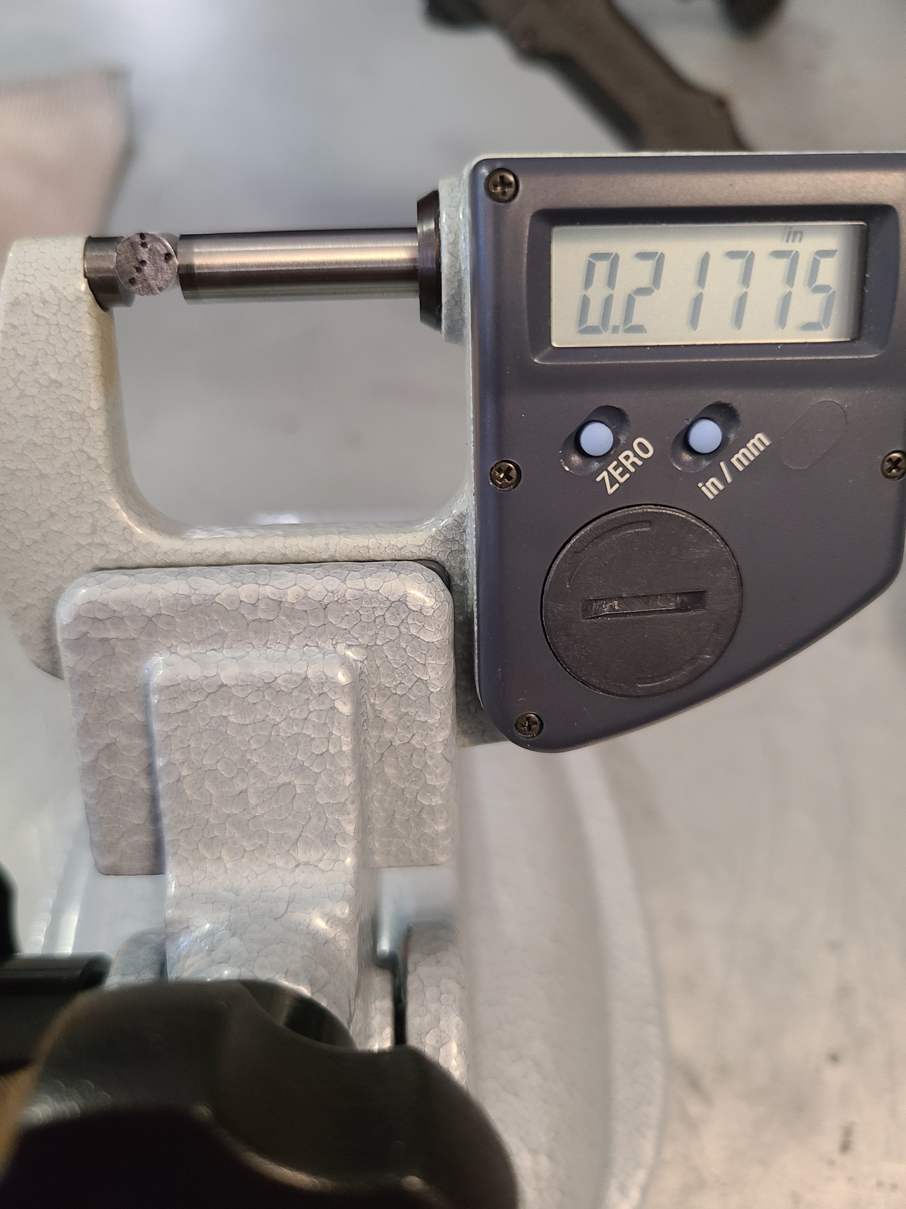

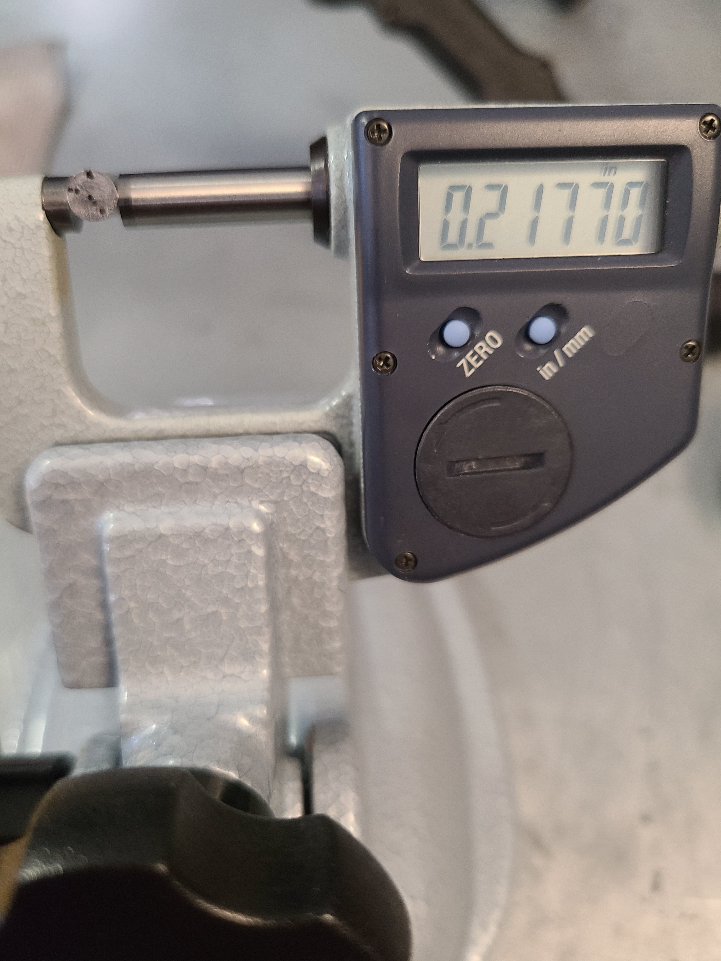

Thormolds, anyone swaging with them?
Reduced .0008 and very consistent.
