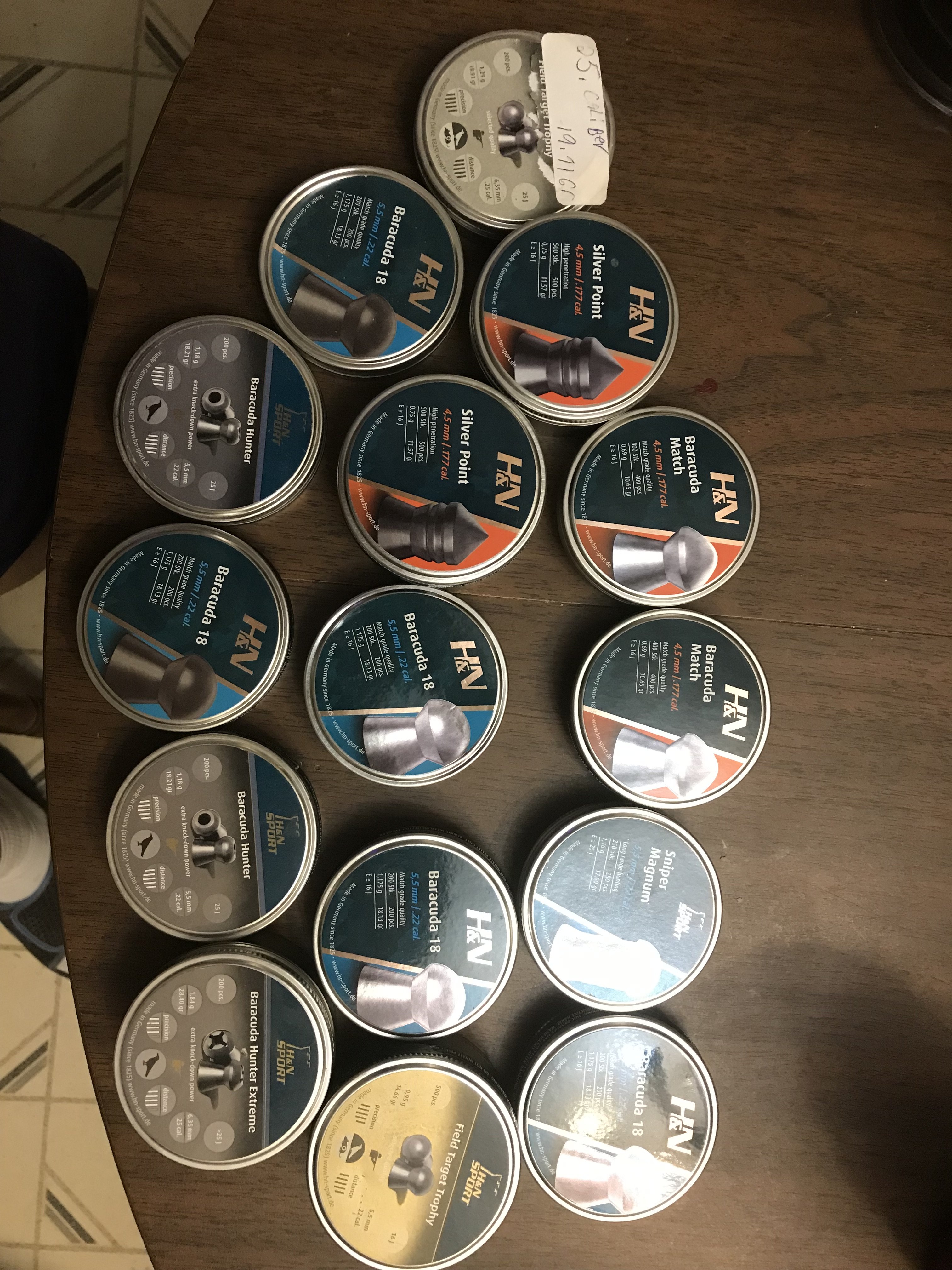

Thought my gun was broke, Crazy pellets
Kinda of apples to oranges , But I heard you say H&N Mine is 177 Uragan is my H&N pellet gun just because I got so many H&N 177 10.65 grain, Gun has always been a super accurate gun, for over a year shooting the H&N Then gun started shooting all over the place coffee can size groups at 48 yards, Open a can of redesigned H&N same thing cleaned my barrel again,, Dam I thinking some wrong with my gun.. Picked up a can of my Vulcan gun JSB pellets EXACT HEAVY DIABOLO 10.34 gr. One ragged hole at 48 yards 15 shots, loaded another magazine same thing,, Something changed from one can to the other in the H&N pellets, I even opened up two more new H&N tins same thing,,, So its not my gun its the pellets.
Not sure I am going to buy any thing H&N again, I just got to many pilling up in the back of my pellet cabnit Just add the 177 back with the 22 and 25 H&N tins of pellets my guns don't shoot ,

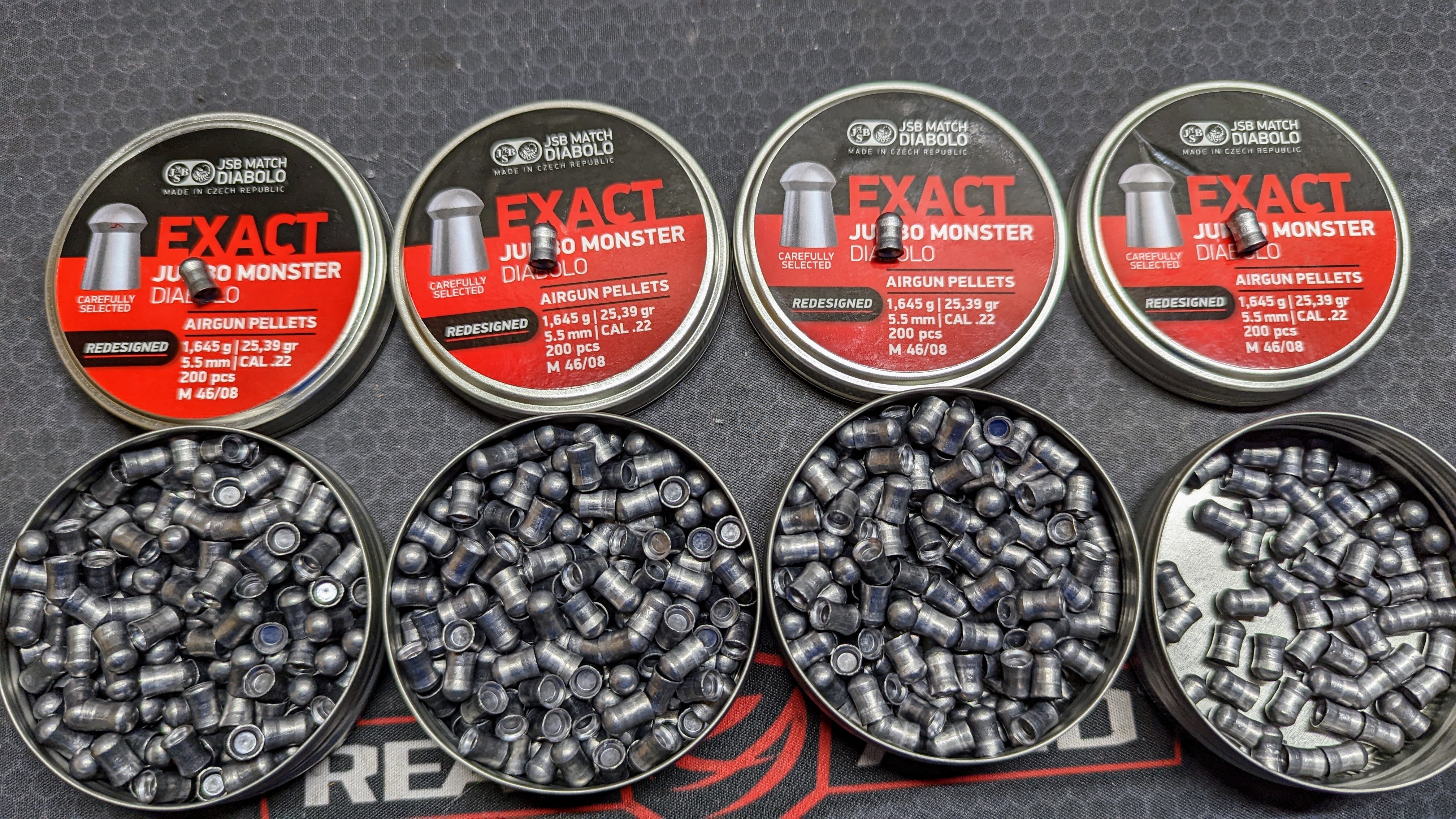

Recently bought a high end gun designed for shooting the .22 Monster Redesigns, & ordered 15 tins of MRD with it. Was thinking I'd somehow gotten a lemon rifle (which would probably be a first for that particular manufacturer!) when it hit me... these don't look like the picture on the tin.
Turns out five of the tins were full of the original Monsters. Felt like a real dumdum for getting through a whole tin before realizing it 🙈. In my defense, had never shot either one before so didn't think much of it when I cracked it open.
Man were those OM's turds... at 50 yards they were keyholing & wouldn't stay on a standard sheet of paper. Could see them knuckleballing through the scope!

The photo on the tin lids is the Monster Redesigned.
The pellets inside those tins are actually the original Monster design.

Im curious what speed you are driving the monsters at, Om or mrd and what gun/barrel (and its twist and choke status) . My impact liked both with the pellet liner and really liked the redesignd in the slug liner at 950 all the way out past 100 yards. Then again my little souped up crosman 1322 also likes om at 40 yards at 500 fps.
Both are averaging ~900 fps. Twist rate is 1:18, & I believe the barrel is choked (though I have not yet slugged it). The MRD (the really real ones 😄) show promise, though still not quite where I want to get. Going to try from 880-950 to see if it just wants a different speed.

If you buy a scope or bipod or something else from me I have been dropping a tin in the box just to get rid of them, I hate to throw money away, I feel better giving it away. LOL I have even been known to drop a china bipod in the box , If it will fit.. See the silver point pellets I could not even hit a 4x8 inch target at 48 yards... If you really LOVE and I mean LOVE H&N pellets just call me a bad shot, LOL....
