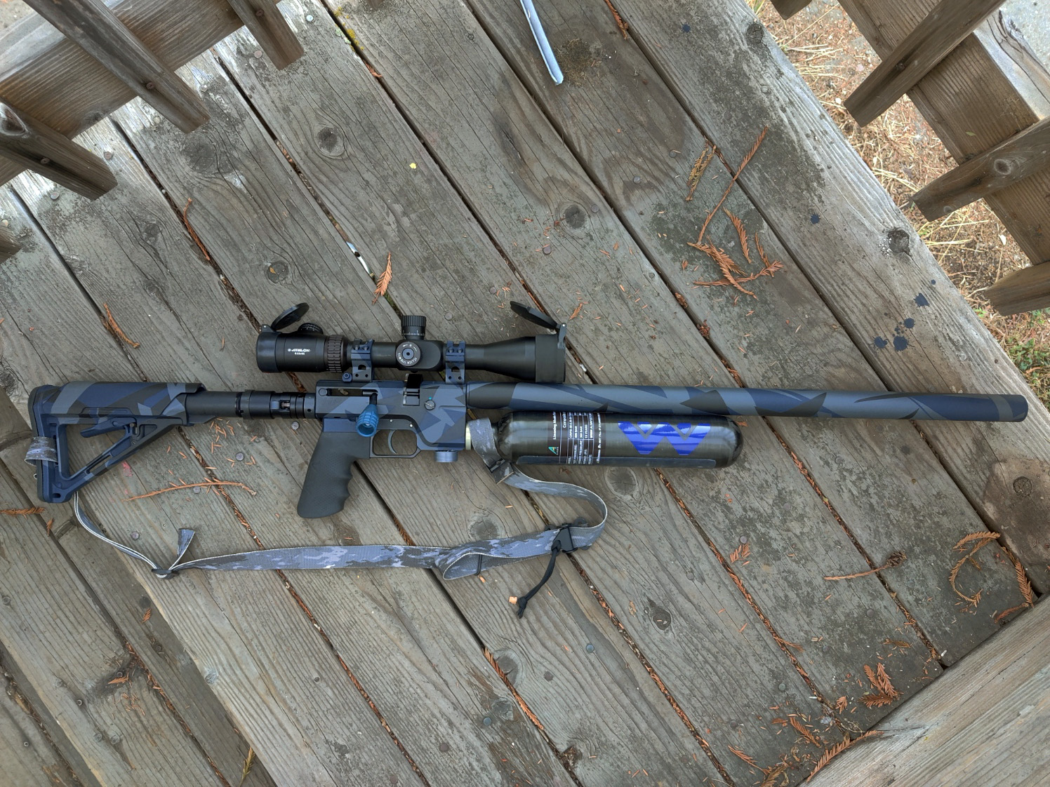

I love my .25cal HP Varmint. The trigger is pretty rough out of the box, but it was easy enough to fix it up a bit. Now it breaks in the high 2's, and I put in an overtravel stop to limit extra motion on the gun. It's an absolute laser beam with H&N 36gr slugs and delivers about 66fpe.
I did a valve spring mod as suggested by another poster on here and that brought the energy up to 86fp. I'm not going to keep that for everyday use, however, because it hurt the accuracy a bit and also messed up the shot velocity consistency.

So for everyday use,hunting mostly and plinking you wouldent suggest the valve pin mod?..and I have to ask were did you get the paint job done on your varmint..that look really nice
Nope, the lightened valve spring gave me a huge power bump, but an immediate downward shot string. So if you want more than a couple of shots to hold zero, it's a no go. The factory valve spring is remarkably consistent.
And thanks! I painted the gun myself with duracoat and stencils.
