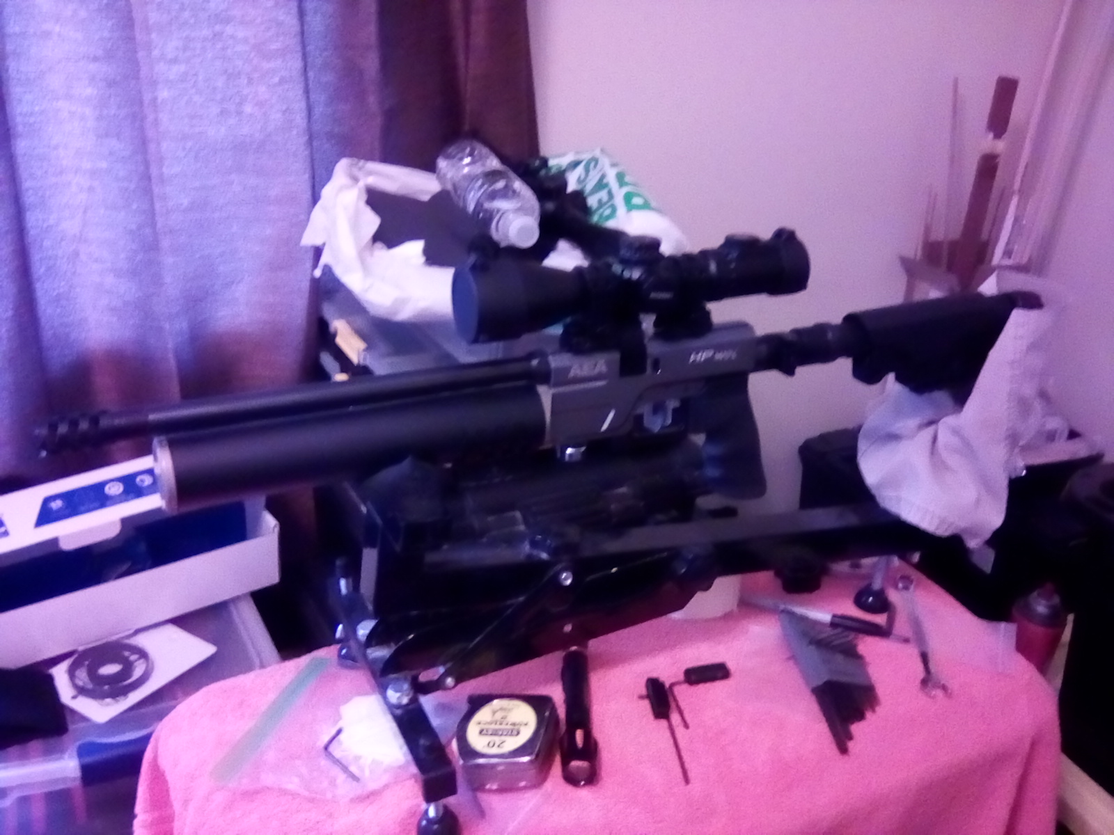

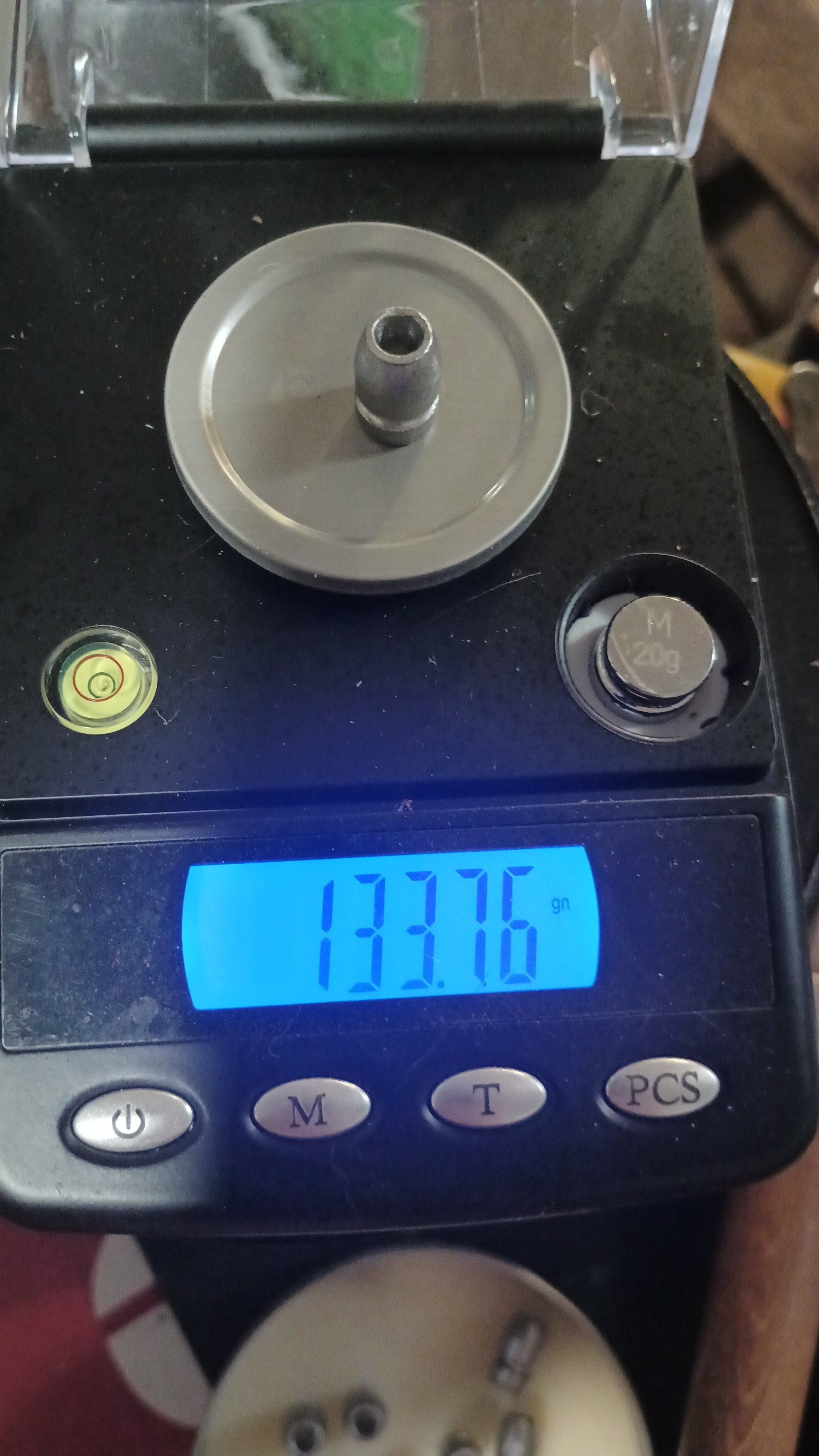

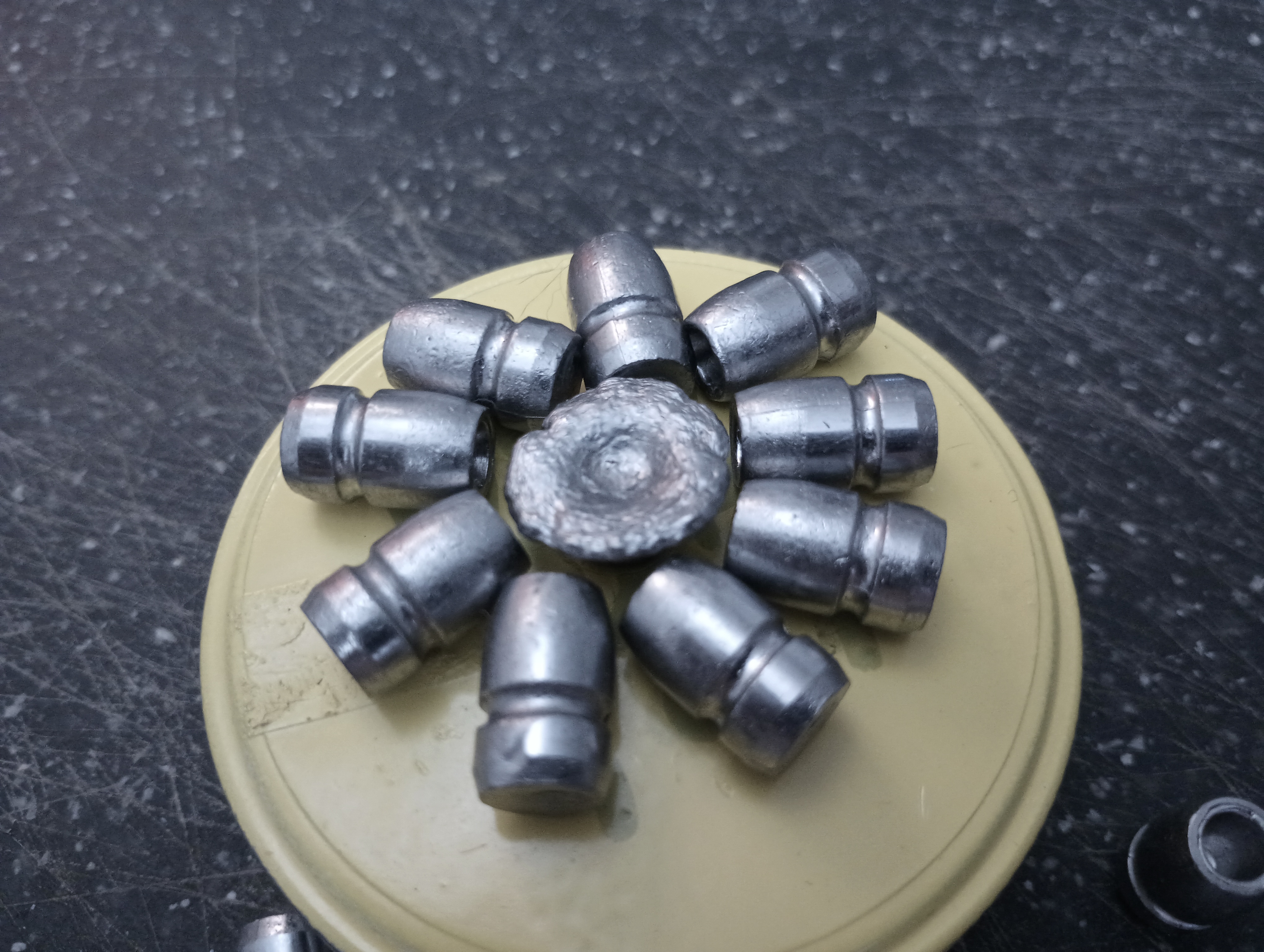

I got the aea Challenger Pro last October and the only leak I had was where the gauge was screwed in for the main fill tank and once that was tightened I have no more leaks. I have literally put hundreds of rounds through this thing. It's in the 357 version and I have some Lyman molds and I bought ammo from several different vendors for testing. Griffin, Pro slugs, MrHollowPoint and some stuff from eBay and a couple thousand rounds from GT bullets. NSA 356-125 are good too. Just for the kicks I got some Missouri 115 grain round nose sized 356 and they seem to work okay also. They're pretty hard and smash bricks easily. I put together about 40 lb of rags soaked in water and they completely penetrated 15 in. All of the hollow points expand and stop within 8 or 10 in.
I've turned the regulator down to 2570 and added a few grams to the Hammer to make it heavier and open it a couple thousands of an inch more. Before I lowered the regulator I was getting 210 foot pounds with 120 grain hollow point slugs. In the current tune I'm getting about 185 to 190 ft lbs. Put a Ronin on it and while it's not neighbor friendly, I've actually shot down the hall and out the patio door from my town house living room. 25 yards, full power 😜.
I did have a problem with the probe arm for the side lever where the wrist pin is made by a roll pin. I was a little rough on it but I went to the hardware store and bought a piece of roll pan and cut it and put it in there and it's fine. I can shoot 9 and 10 rings all day at 125 yards. I don't bother with pellets unless I'm just doing some pesting then I'll turn the transfer port down to a little below the halfway point. In that configuration I get about 20 shots before I fall off the reg. At full power I'm getting 12 to 14 shots on the regulator.

I have the trigger on my carbine at 2.75 lb. To get there I had to polish to a bright chrome finish the contact area's of the trigger to sear and the sear to hammer catch. The hammer is a ring style contact so the whole ring needs polished. Chuck it up in a drill or something and use 1000 - 2000 wet or dry paper then use something like Flitz,
Changing springs should be done one at a time. The sear requires a stiffer spring than the trigger. I find springs similar to what is in the gun then shrink the length by heating the coil on the end of the spring to red hot then squash the spring one or two coils at a time. Try and repeat. If the gun doubles redo the spring. I ended up using slightly smaller wire size and squashing coils to get to 2.75.
You will notice the trigger pin hole is oblonged. That is to allow the trigger to toggle past the sear and reset. Sometimes on the bench you may get a doubling by "laying" on the trigger slightly after a shot. This hinders the toggle action and is noticeable when you have a lighter trigger spring. This can cause a doubling or a no cock.
I cannot get an answer on part availability from Bin Tac other than what is in their catalog. I have doubts that you could get a new sear or trigger blade so go slow on your polishing. Ace hardware had me covered on spring needs.
Jim
I changed the spring in my challenger Pro 357 with Ace hardware but it's not big enough and slips into the rod hole. I made a washer from some nylon bushing and did a quick buffing to hammer and sear. I noticed that increasing the hammer weight and opening the valve and extra 2/10 of an inch would increase the trigger pull also. I can get over 200 ft lbs with 129 grain slug and hit soda cans at over 110 yards.
