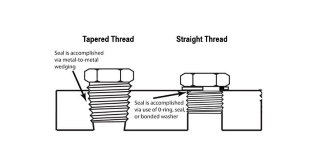

If the gauge threads are tapered then no. This shows how they work and seal. BSP stands for Brittish Pipe Thread. There's a tapered and parallel version.
T is for tapered

BSPT is tapered and is not commonly used with high pressure air
1/8 NPT (North American) and 1/8 BSP (European) are the same pitch, only BSPP (I don't think you will find these openly in NA) a bit different cone vs NPT.
Also 10 mm (Asian) is a parallel thread very close pitch and can be partially threaded in BSP...I tried these work with bottom puck.
The only difference between these four is - how and where they seal.
