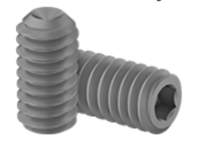

Phillips suck. I’d try replacing the screws with socket set screws. Some people call them “grub screws”. McMaster Carr, and others sell set screws with a dab of thread locker already on them. You can feel some drag on them when installing them.
Don’t know the size of your screw or if that size is available with thread locker.
One thing I have done on machinery where you wanted to assure that a set screw didn’t loosen was to put a second set screw on top of the first one. With that method we generally didn’t use thread locker. YRMV
