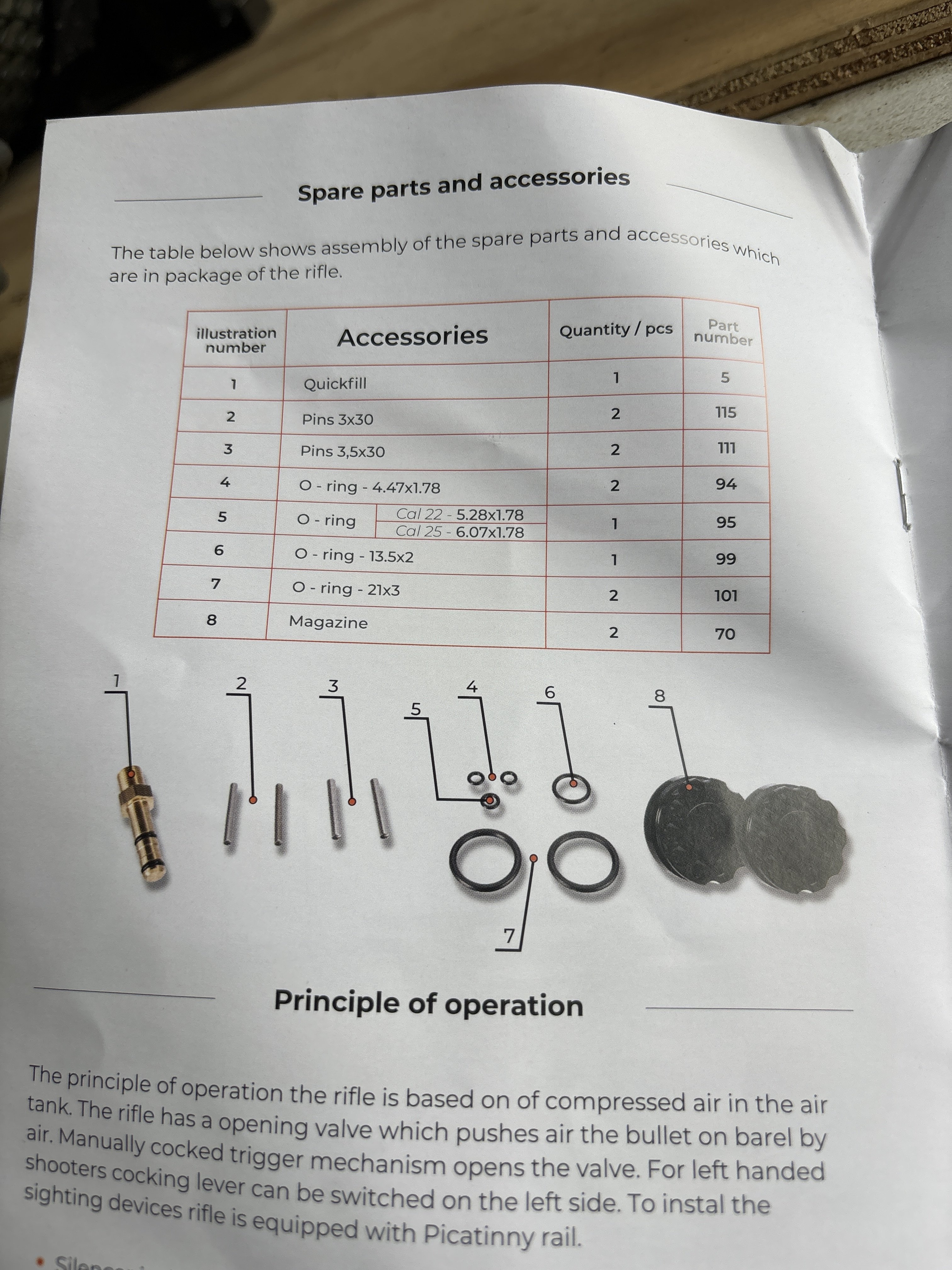

Wondering if anyone knows the size....just curious if I have the size already in my inventory.
R rwsmike Member Jul 8, 2015 1,840 738 Rhode Island, United States Jun 12, 2024 Add bookmark #1 Jun 12, 2024 Add bookmark #1 Wondering if anyone knows the size....just curious if I have the size already in my inventory.
MACTEN Member Nov 18, 2020 1,383 776 IA Jun 12, 2024 Add bookmark #2 Jun 12, 2024 Add bookmark #2 Taipan says those o-rings are 4.48mm x 1.78 cs . I may have some spares it came with ( to measure ) but will have to look when I get home. Upvote 0
rangur1 Member Jan 4, 2018 2,808 1,698 peoples republic of New York Jun 12, 2024 Add bookmark #3 Jun 12, 2024 Add bookmark #3 I think it’s number 4 Upvote 0
MACTEN Member Nov 18, 2020 1,383 776 IA Jun 12, 2024 Add bookmark #4 Jun 12, 2024 Add bookmark #4 rangur1 said: I think it’s number 4 View attachment 471890 Click to expand... Taipan O-Rings It's number 4 for sure. They are number 128 Upvote 0
cwcarrera Member Jan 1, 2019 427 223 Manatee County FL, United States Jun 13, 2024 Add bookmark #5 Jun 13, 2024 Add bookmark #5 Yes, the spares that came with my Vet are 4.47 ID X 1.78 CS which crosses into a standard AS568 spec '008' O-ring. Buna Orings # 008-70D FDA/NSF61 Minimum 100 pcs 3/16 ID X 5/16 OD X 1/16 CS - Price is for 100 pieces www.oringsandmore.com Reactions: Dairyboy Upvote 0
PasadenaMike Member Aug 28, 2022 1,611 1 2,161 Pasadena, CA Jun 13, 2024 Add bookmark #6 Jun 13, 2024 Add bookmark #6 Edgun and taipan use same o ring. 1.5x5 is what Edgun uses Upvote 0
R rwsmike Member Jul 8, 2015 1,840 738 Rhode Island, United States Jun 13, 2024 Add bookmark #7 Jun 13, 2024 Add bookmark #7 Thank you everyone....best forum and members Upvote 0
