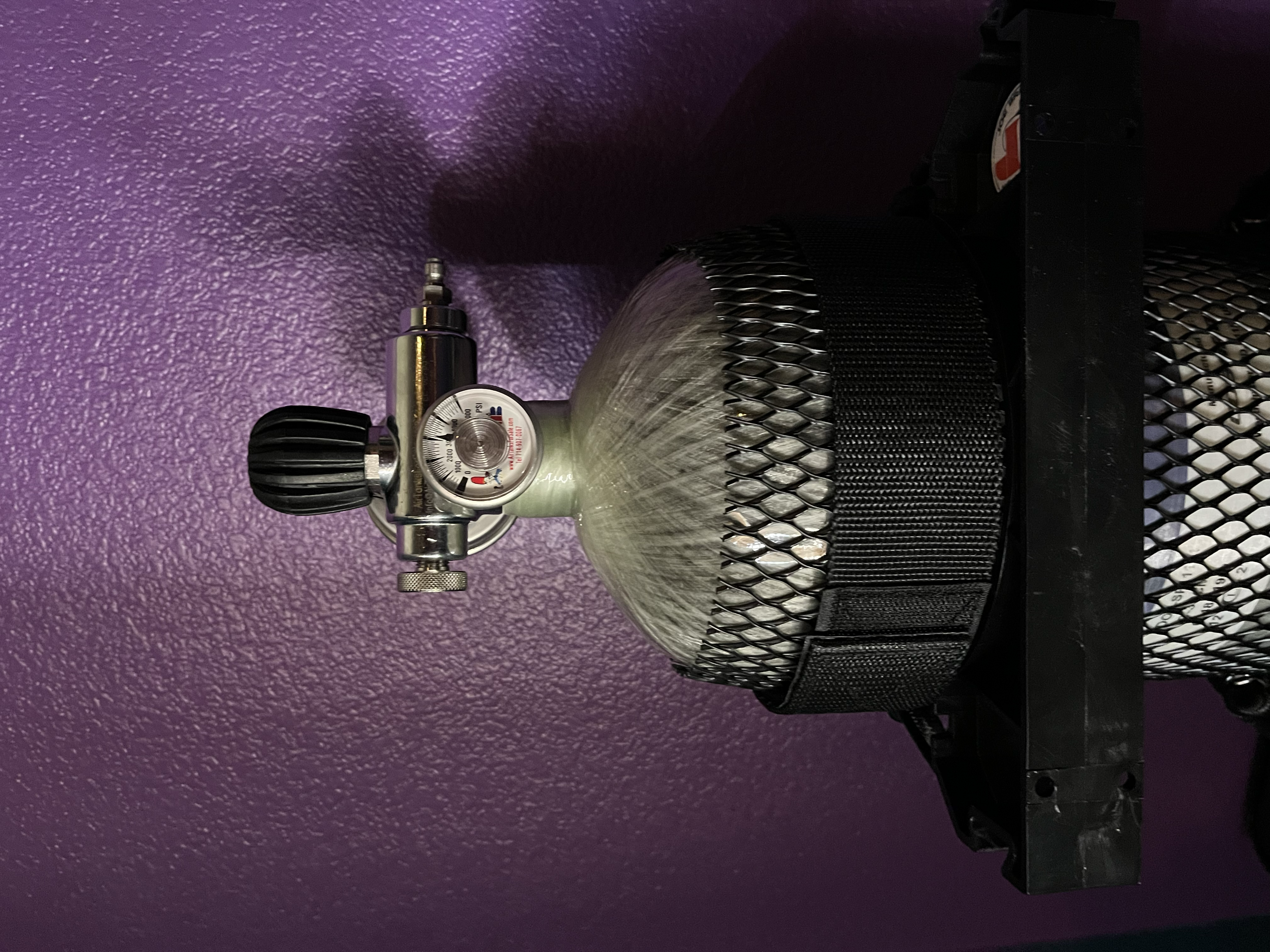

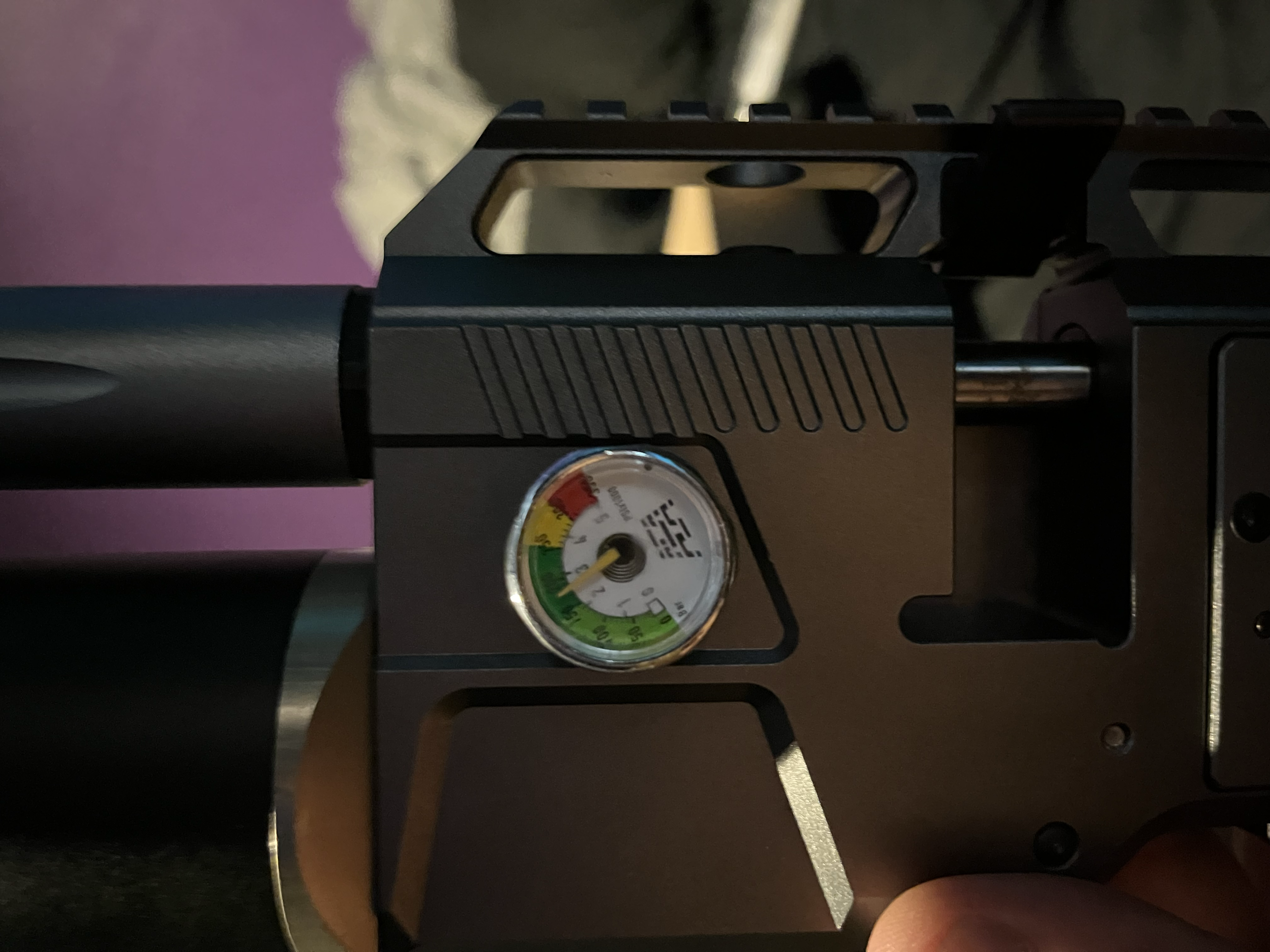

To start off, I am entry level and just getting into this hobby, I have just received the bintac S45, and the tiger shark cf tank. I am no able to fill past around 200 bar, does anyone know what might be the issue? Also I dry fired at around 200 bar yesterday, and it shot repeatedly about 6 times (roughly) and I only pulled the trigger ounce, it went from 200 bar to 100 bar (roughly) I was thinking the seals on the gun tank where destroyed, but its still holding air but only fills to abs 200 bar. The s45 has a fill rating of 4600 psi, so I know something aint right.
The tiger shark arrived filled as I requested but only to around 3600 psi, I emailed top guns air guns, and Andrew stated,

Your fill bottle has only 3000 psi in it. That is only just over 200BAR. You won't be able to fill anything to a higher pressure than what the doner bottle contains. If you want to fill your gun to 4500 psi you will need to fill your so-called tiger shark to its maximum pressure and from there every time you refill your gun the pressure will reduce slightly until you decide that you want more shots than you are getting from each charge. I can't believe that a dealer would give you such a nonsensical answer to your question unless he was totally confused about how you described your problem. There is a possibility that you have a slight leak from one of the valve fittings. It is easy to check by spraying a bit of soapy water around all of the connections or tipping the bottle upside down and dunking the whole valve in a bucket of water and looking for bubbles. Maybe a better option for you would be to get it filled back up at a dive shop and ask them to check for leaks.

If you want to fill your rifle to a true 4500psi then you need a booster that will take whatever you have in your tank and boost that to your desired pressure. Not cheap!!!
I appreciate the reply, this is one of those "common sense isn't common", I defiantly plan to dive into researching more into this hobby. Dunking under water and seeing if any air bubbles come up is a great idea, thanks! I plan to take the tank in and have it checked out at a local paintball shop/ fill to maximum psi, as these tanks are expensive...
Don't dunk the entire valve under water to test for leaks. Squirt some dishwashing liquid into a small bowl of water and mix it up. Take an old toothbrush or soft brush of some kind and brush the mixture around the seam where the valve connects to the tank. Dunking a valve assembly under water almost always results in a gauge getting fogged up permanently from the dunking. Valves rarely leak other than at the base when the tank seal is leaking.
