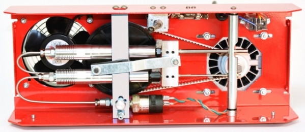

Red one is shoebox and costs $499 and needs shop compressor to power first stage

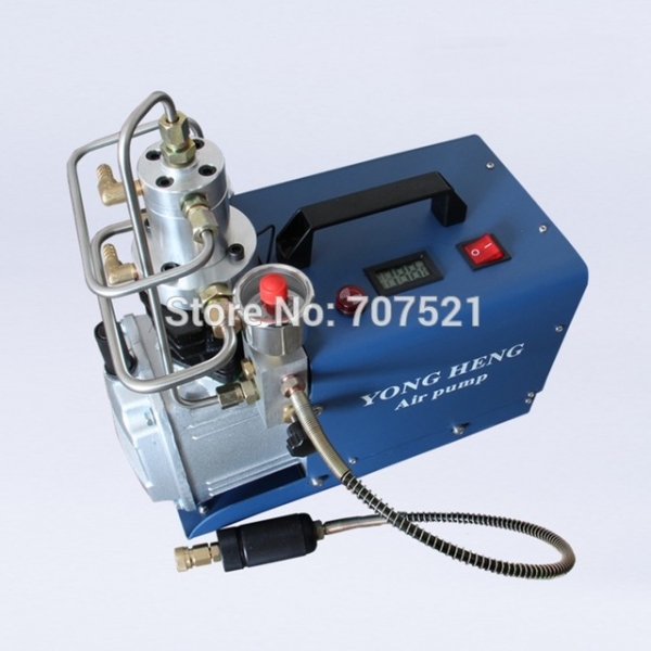

Blue one is Yong Heng - does not need shop compressor as it is a 2 stage compressor - has more than 10x air flow than shoebox, and costs less
By the time you add all the pieces to give one of the Chinese decent water separation, adjustable auto shut off, and auto purge, the cheap option isn't so 'cheap' anymore. Add to that the questions surrounding durability and parts/service, and you've got a non-starter in my opinion. I think one of the $1200 - $1600 entry level machines is a much more cost effective approach.
I have a first gen shoebox , a Yong Heng knockoff and a Carette . Do yourself a favor and continue saving for a better compressor . It hurts a little to spend 1k + on a compressor but it will save you time , money , and frustration in the long run . My shoebox was painfully slow , so much so that I just went back to hand pumping . The Yong Heng is worth the money IF you get a good one , mine is now a paper weight after filling My crown 4 times . My Carette has been worth every penny , coming up on 15 hrs run time with zero issues .
The most expensive Yong Heng has oil/water separation and adjustable pressure auto-stop - I got that model, as it was not much more expensive than the 3 cheaper versions (they all weigh about the same, and shipping from China is a large part of the price you pay for the compressor)

A couple of days ago on another site, somebody had a problem with his new Yong Heng (didn't work) - trouble is it wasn't a Yong Heng, it was a look alike clone - if it does not say "Yong Heng" in big letters on the side of the compressor it is a fake, made by who knows who, and good luck getting spare parts
Here we go again - "I have a Yong Heng and it's now just an expensive paper weight" NO YOU DON'T - you have a knock-off copy of a Yong Heng that's a piece of crap

I fill my rifles directly, so I manage fine with a small permanent water tank above the compressor - I re-purposed an old TV/video stand with castors - compressor below, water tank above, easy to wheel about if necessary
Filling a large tank is going to be a different story, as the re-circulated water would soon get hot - for that scenario I would site the compressor near a sink, or outside tap and drain - don't re-circulate the water - fresh cold water from the tap though the compressor, and out and down the drain
NOTE: people with problems with compressor getting hot - no instructions usually with these compressors - you have to specifically ask for instructions to be included - the cold water goes in at the bottom connector, and out at the top connector - not logical, and not the way most people connect the water supply - but that's the way it's done - otherwise you get over heating of second stage

The shoebox has been around a good while and has excellent support. I use the Altros Booster, even easier to rebuild but I've never had to.
Yes you need a shop compressor, there great to have anyway! I use a $129.00 unit from Lowes run the 100psi through several feet of metal pipe ( free from the barn or I'd skip it) for extra moisture trapping then a harbor freight type dryer/Silicone lube injector. No issues ever.

The China made compressors are a crap shoot. Been looking and reading and studying them for a month or so. If you get the real deal its a win. If you get some garbage well the expensive paper weight is its destiny. Problem i keep running into is even the true YH sellers also seem to slip in a clone or 2 and everyone is using the same stock photos. Very frustrating. I just ordered a DAVV off fleabay. come from California. I figure if its a dud i can ship it back cheap enough and get most of my money back (30 day return with free return shipping and then a 1 year warrenty without free return shipping). I think one of the key things is to realize what the limits of these units are. Set it and forget it is not the way to treat these. Short runs with frequent oil changes and careful temperature monitoring are key to keeping these running (provided you get a good one). There are a coup!e youtube vids of the tear down on these and they are built half way decent so the ground work is there.
I got one that looks a lot like a YH but no brand name on it. It has the adjustable auto shutoff. All the problems that I had getting it setup and running well were the result of sketchy documentation. Most of the info is there, but scattered and not all that clear.
https://www.ebay.com/itm/173318770537
They need a step-by-step setup and operation.
Problems/resolutions:
add oil before running
1) Compressor would not start and would trip built in circuit breaker/ Compressor needs to have the vent screws (at least the low side) open when starting. That reduces the load on startup. Close the vent once it is running.
2) Compressor was running hotter than recommended/ The little water pump should be at approx that same elevation as the compressor. The slide adjuster on the water pump should be set to maximum. Water should enter the compressor on the bottom fitting.
3) Compressor would not fill much over 3000psi/ Cinch down tighter on the second stage vent screw and it than would go to 4500psi.
4) Oil mist and bubbles coming out of the oil cap/ Replace the oil cap with the filtered vent cap in the parts bag.
I have filled my 88ci bottle a few times. It fills fast (3 or 4 minutes from 3000psi to 4500psi). Time will tell if it holds up long term. I like it so far.
