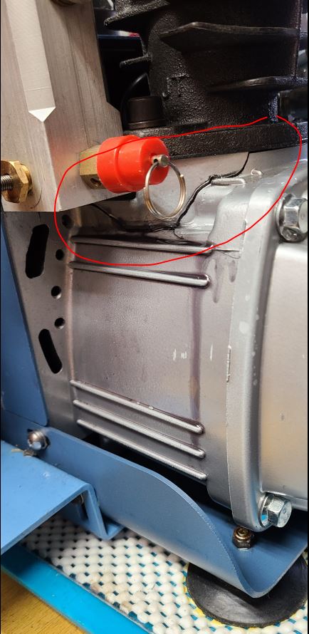

Last year after some 30 or so hours I seized the crank arm, replaced the whole piston + cylinder. But noticed a small crack on the aluminum housing (just above that upper rib) probably because of the stress when seized.
It was just a matter of time something to happen.

I replaced the oil (last summer) but I had no enough oil maybe 1/3, still I wanted to shoot that afternoon and ran that compressor almost dry for almost an hour ....hot you can fry the eggs on it.
This was a user error what happened to me and I admitted that time - even today...with a smile.
The crank seized in a hot run and until stopped it was still in a motion. That stress cracked the housing neck a little bit. I epoxy the crack not to leak the oil. And I still ran that compressor like that for next half a year. If you did any "maintenance work" on small engines - motorcycle or dirtbike for example - you would know what we backyard mechanics willing to take a risk... ;)

@bigHUN I figured it was heat related stemming from an oil issue, but didn’t want to assume. In a sense running it under those conditions help expose the limitations of the unit’s durability. I imagine that if manufacturers pay attention to forums like this it can help them with design improvements in order to produce more durable products. Then QC would be the primary issue in order to ensure consistent quality. Thanks for the open explanation. I don’t know much about small engines so I learn a lot from members like yourself that post about these types of experiences.

The crank arm got welded on the shaft, yes because a lack of oil lubrication.......no needle bearings there only a metal-to-metal running as much oil can get in a gap.
