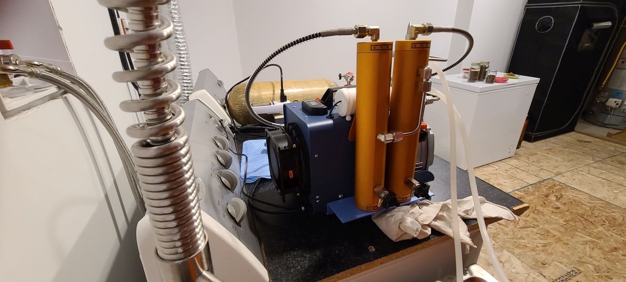

The surgery toke me about four-five hours, two coffee's and almost a six pack if I remember well
From the new-basic YH (left) removed the upper half to a box with other spare parts, from the old broken-upgrade YH (right) moved all the upper half to a new YH. Also replaced the second stage brass piston it was showing signs of oil leak.
When all done back together I ran it for couple minutes and monitoring the rising Temp showed the second stage was burning in, the current was drawing surprisingly below 15A in contrast to 18-21A before the surgery on old motor.
Today, after a third tank fill-up I consider it all settled, with 15 minutes run per session, the Temp stabilized about 55C at 15A.
I am speculating within a next hour runtime the second stage pistons will get in shape and the Temp will drop further maybe 50C.
Pretty much happy with a result, for $200 CAD = $150 USD + a coffee + couple beers + some greasy nails, I got the YH back working, got a full box of spare parts...........so far so good![]()
