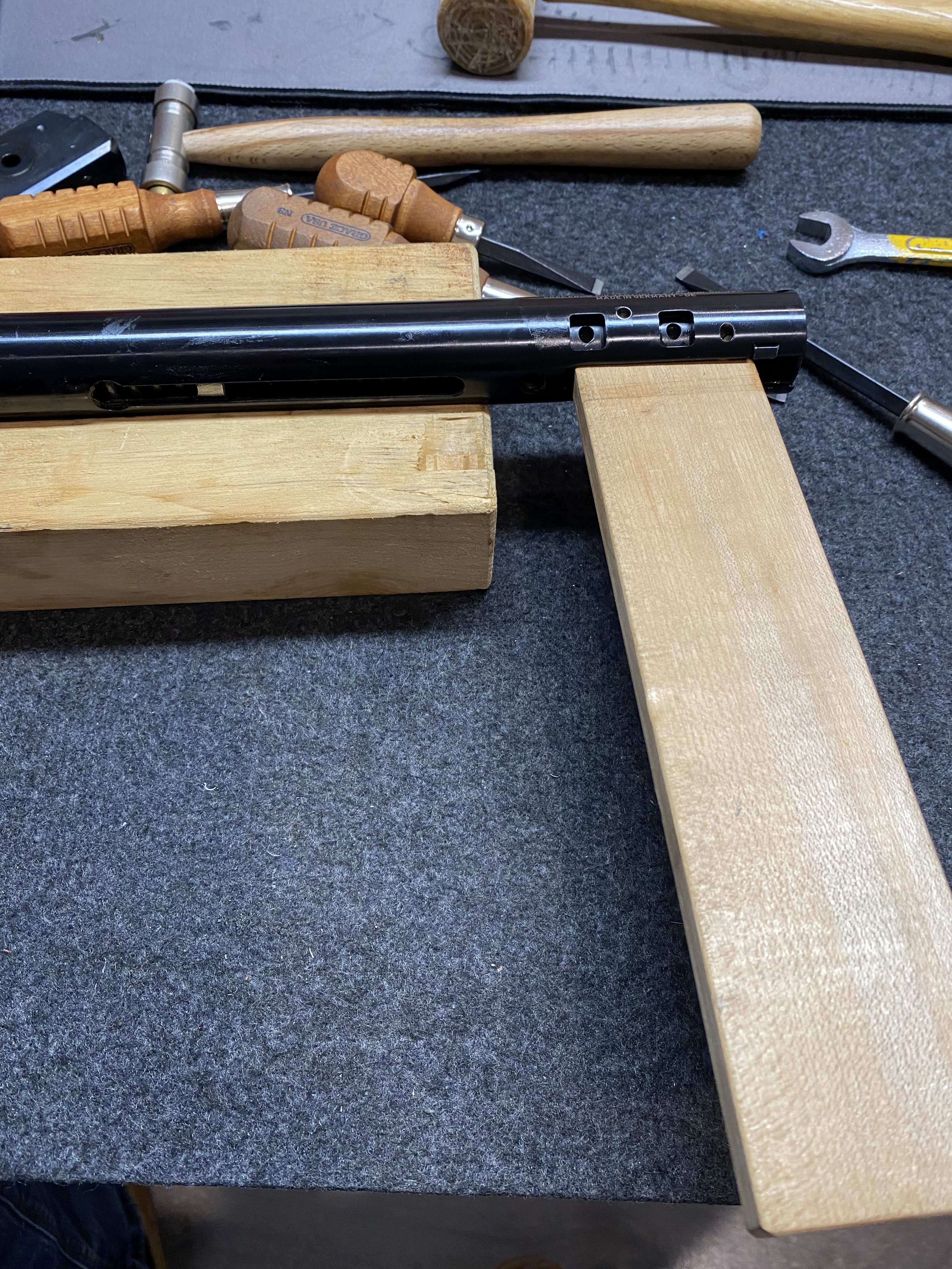

Today I tried going out shootin, never took a shot nasty storm. I went down to my work area to clean a 98. Got the stock off and looked for something to rest the cylinder on to knock out the pins. Screw driver handle or hammer. Déjà vu. On the last couple weeks I taken 8 rifles apart. And had the same issue. I went down my wood shop and made these. A little crude but gems.

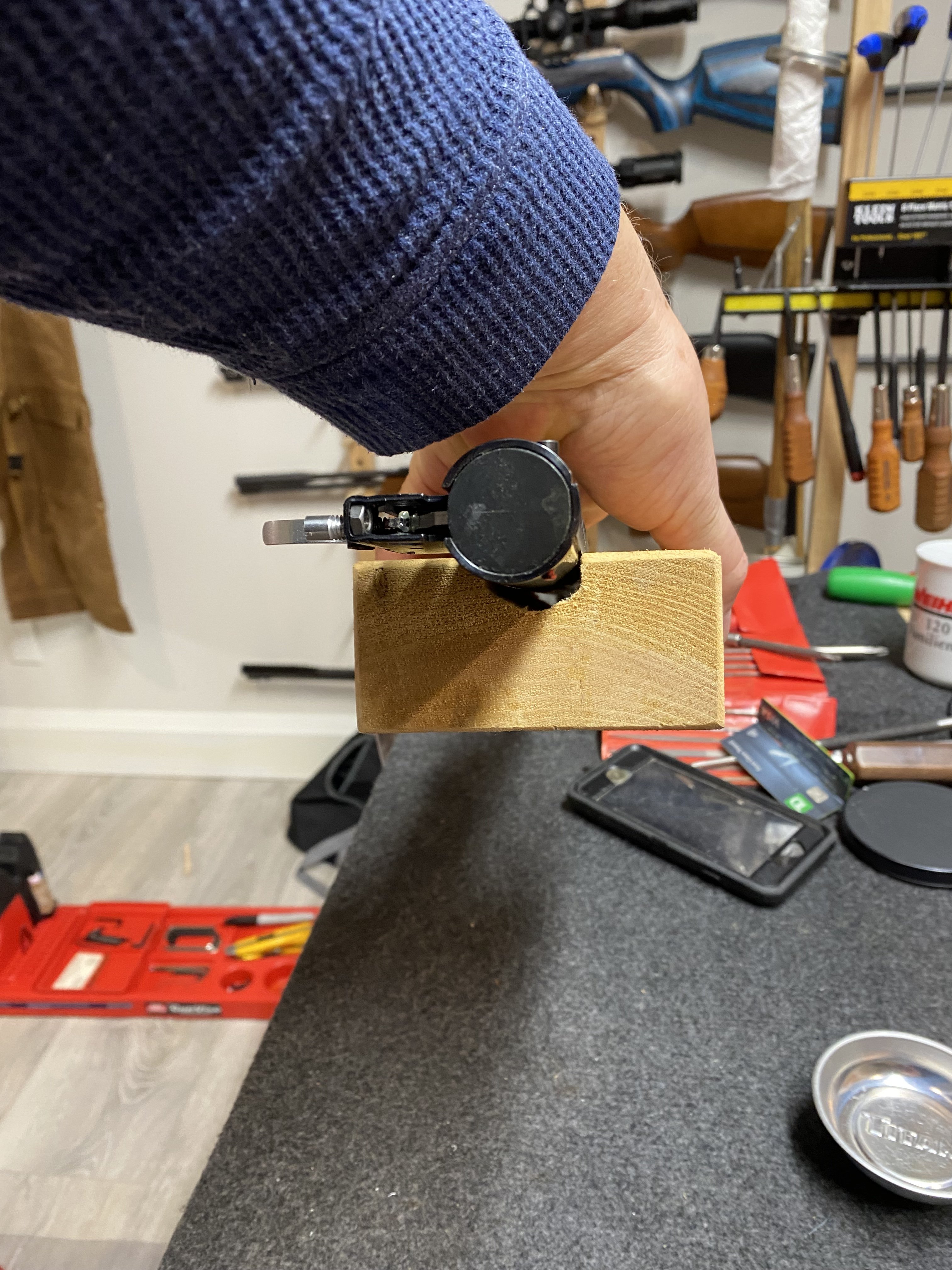

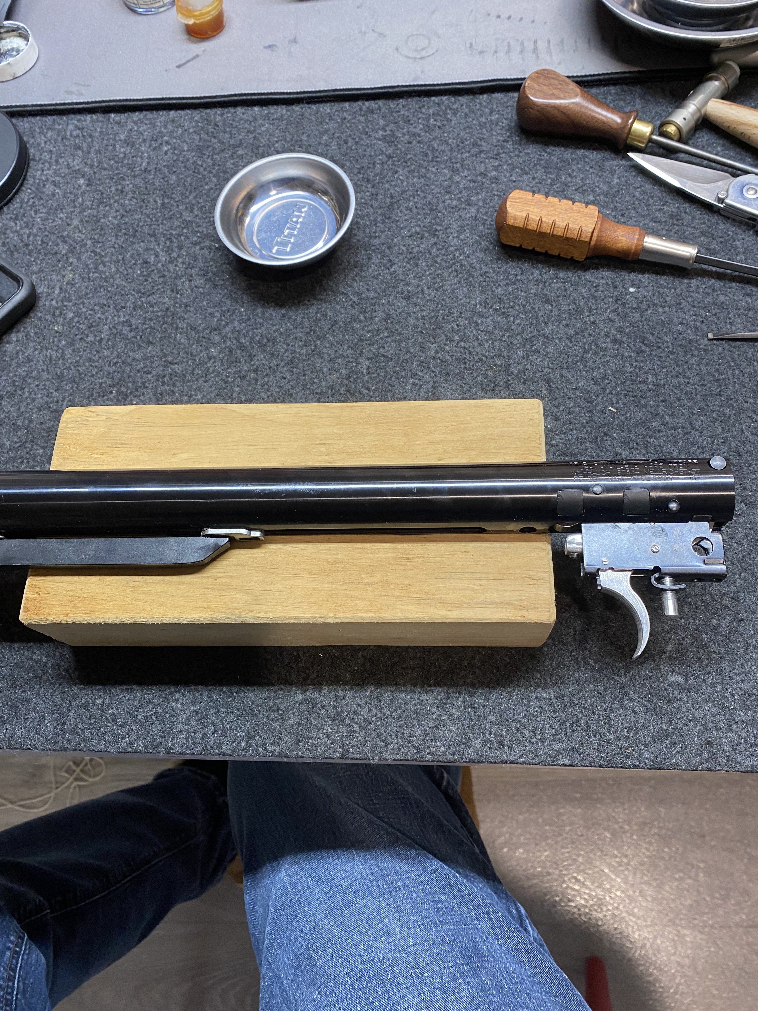

First off I made a jig to house the cylinder when doing pins, installing the trigger and reinstalling the barrel. Made the opening an inch wide so the cylinder is pinched between the wood. I used pine because it’s soft and I sanded the edges to soften them. It grabbed nicely. The pine was a full 2 inches thick to give the pins room to drop.
Talk about make it easy and so much more rigid.
Now this one drove me crazy. Problem solved.

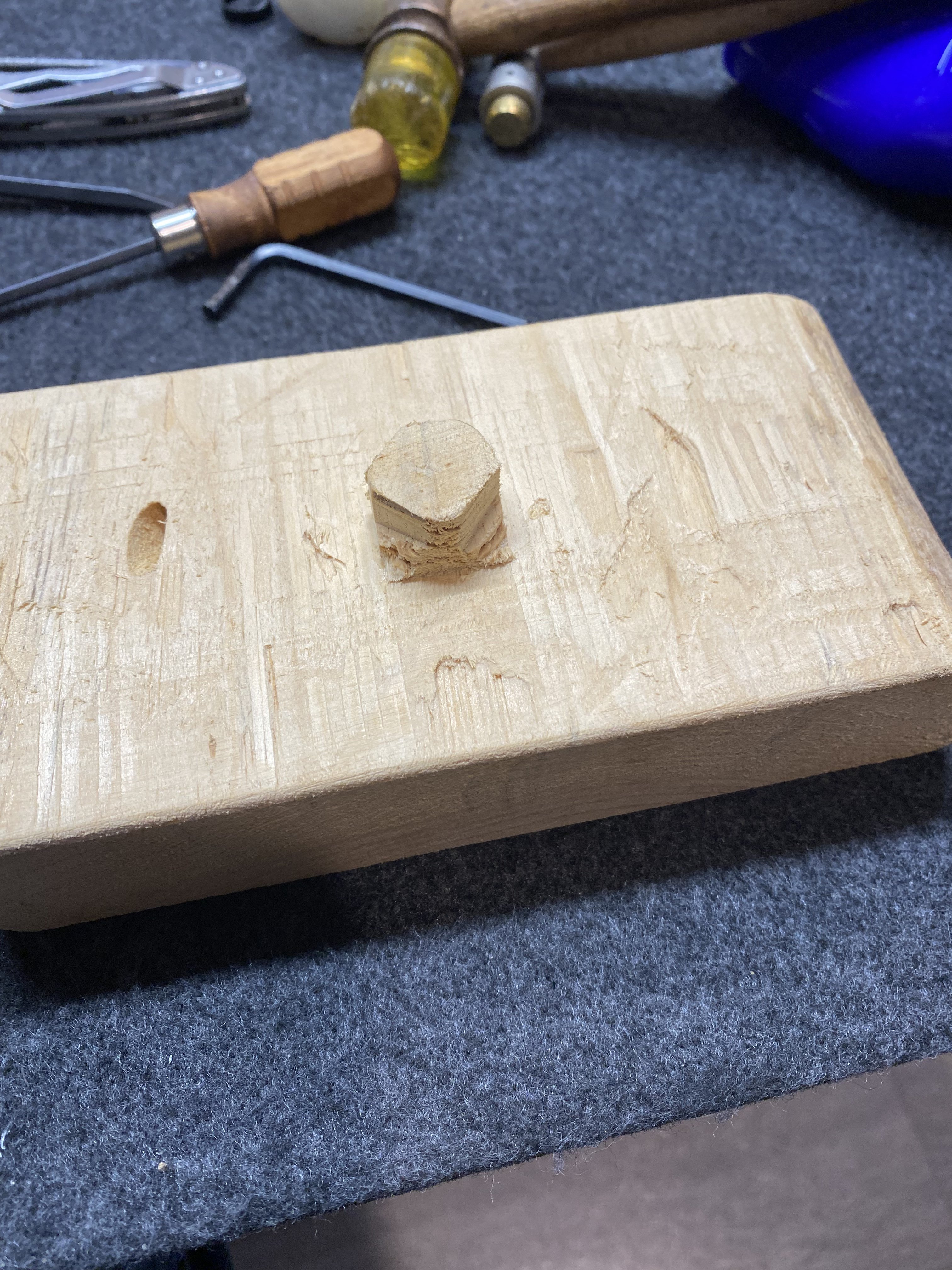

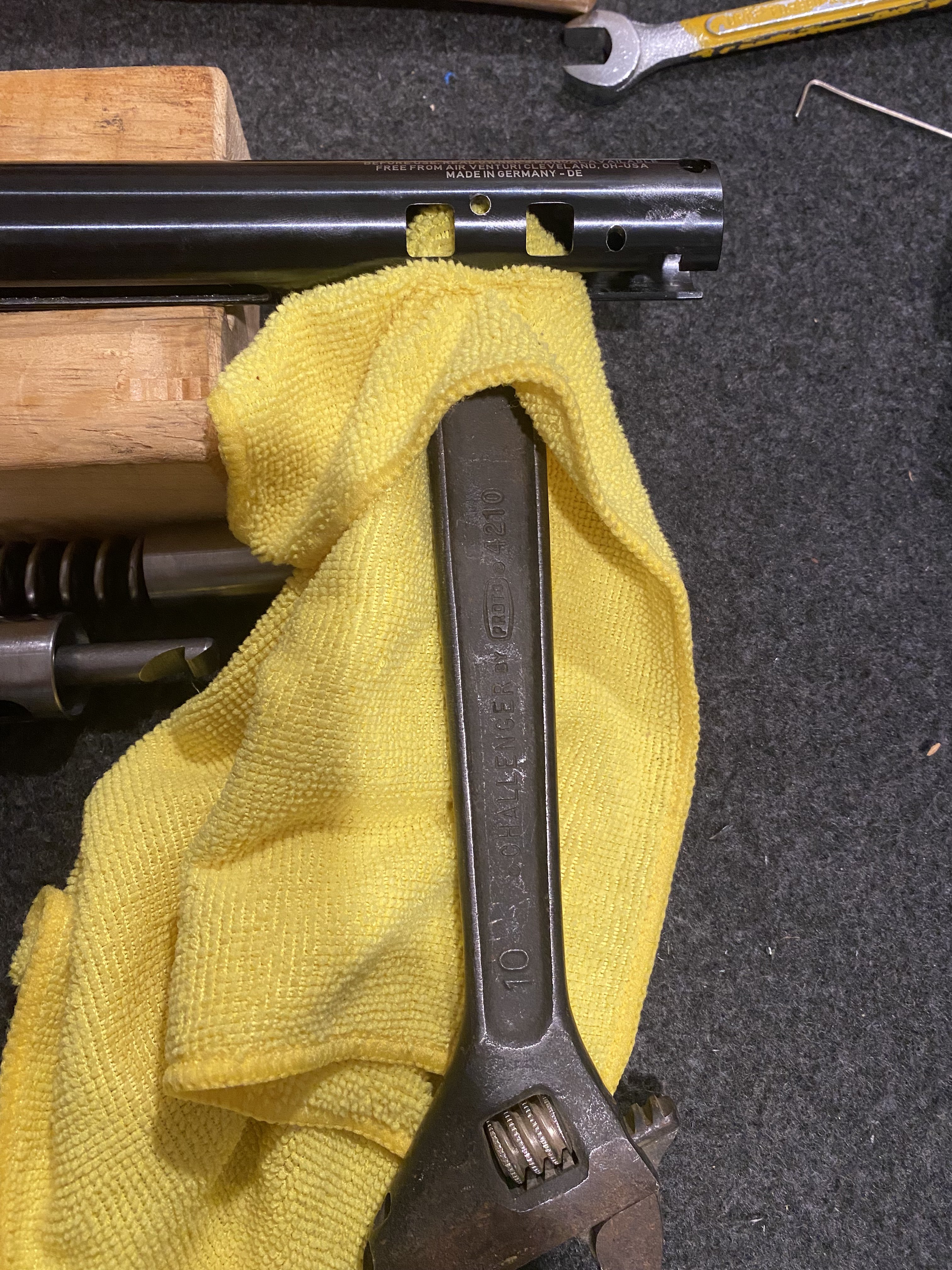

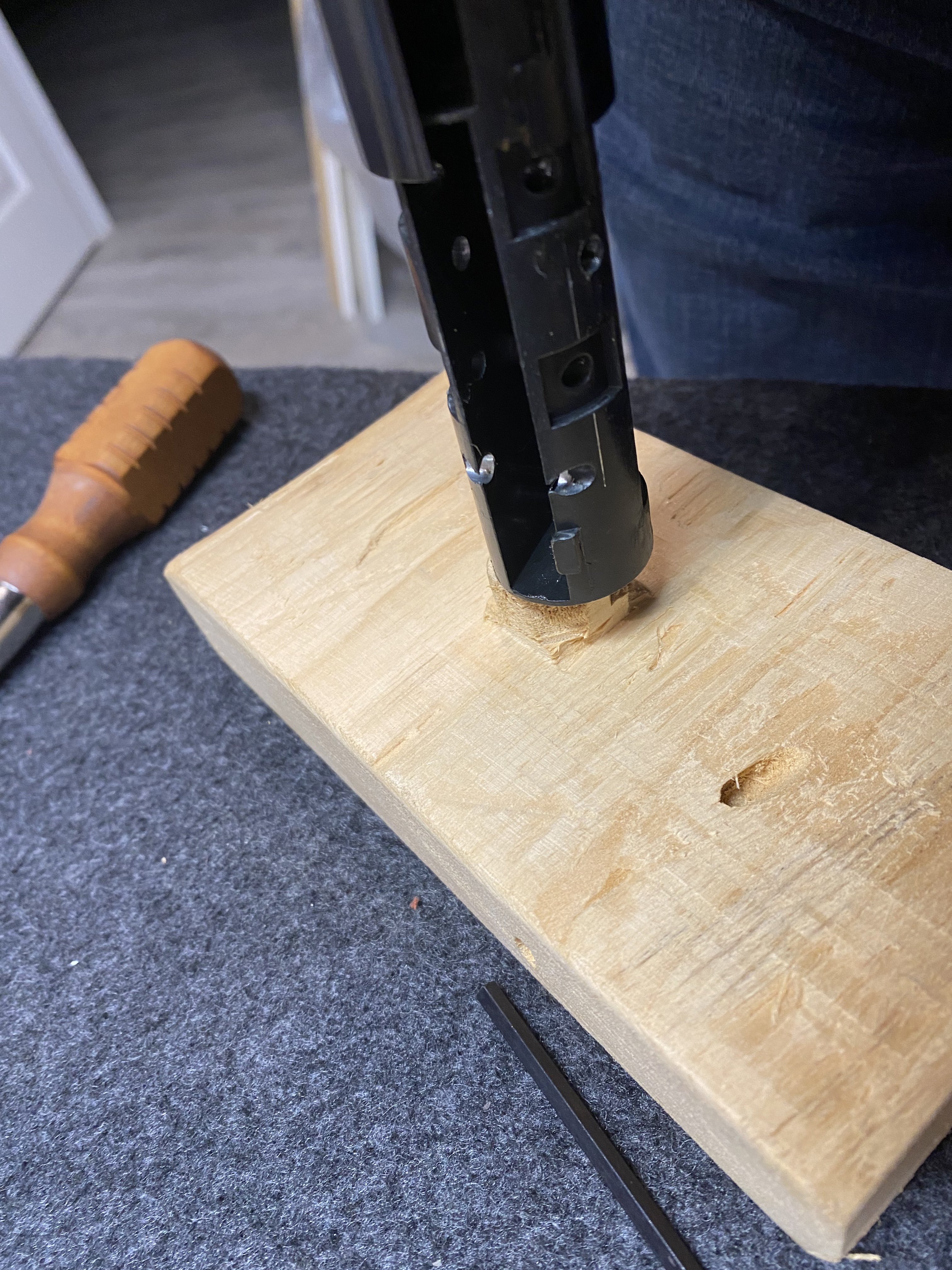

I bought a spring press. $150. POS. I made two no three more home made and ho hum they worked. Still not happy. Talked to a member who recommended to do by hand. And I did, but struggled like hell trying to apply pressure on the end of the cylinder.
‘Again scrap pine and I just left a dowel. Should have drilled a hole and put a dowel in.
Now the problem is when you apply pressure and turn, everything slides. Super frustrating.
So I went in kitchen when the queen bee wasn’t looking and borrowed a silicone jar opener. It actually turned the job into a joke. I’m going to put 2 way tape with foam backing on the end.

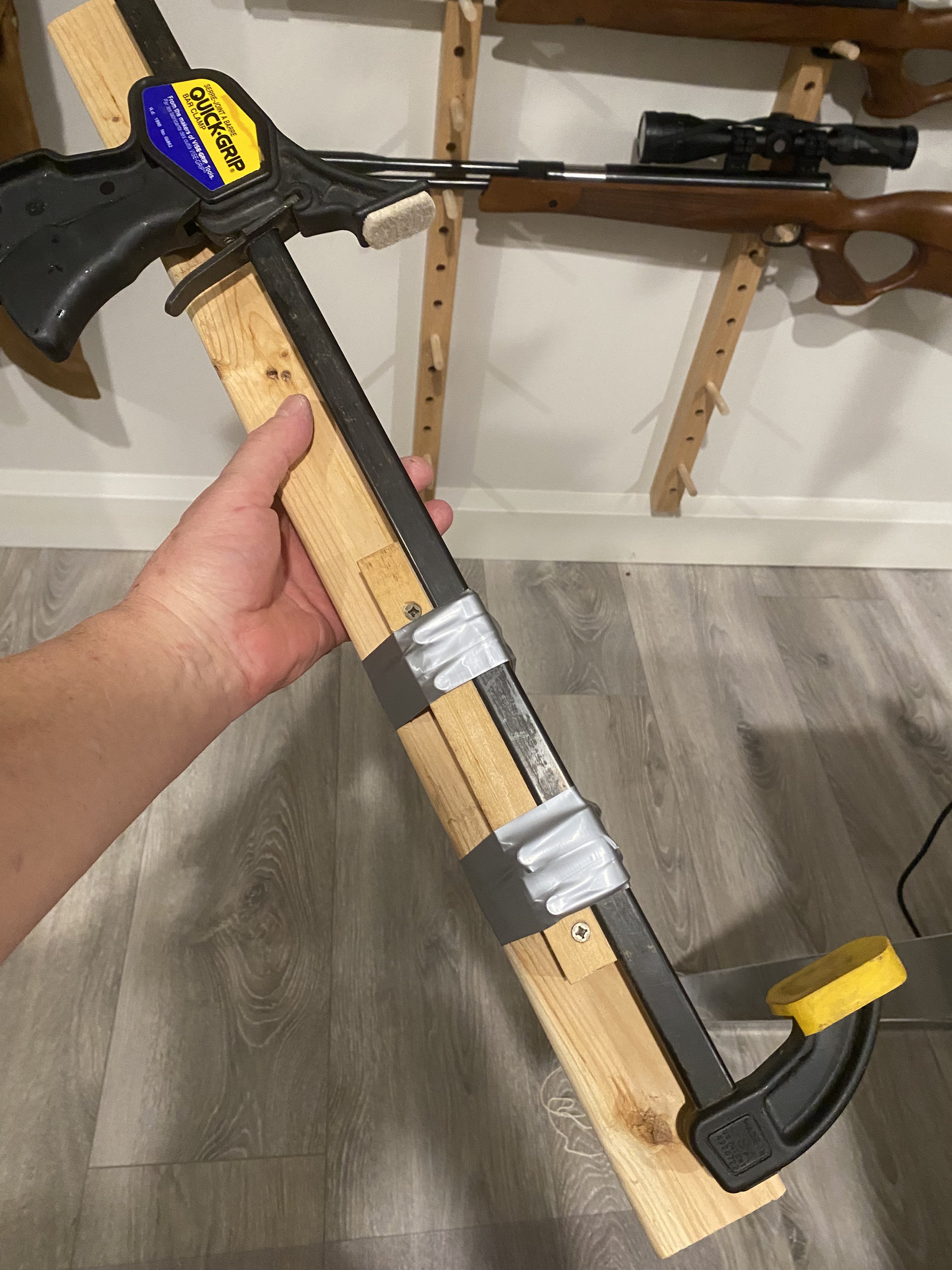

@crowski A long wood clamp works fine as a spring compressor, especially the one-hand quick grip kind.
Probably have 40 bar clamps and 20 quick grips. Tried them both
‘They worked but not near as easy as the dowel. Way better control and feel . Crow

I changed springs on the TX and the PS. Honestly, I think the HW50 and HW85 were both easier so far. Just push and twist. The TX was a dream to work on don’t get me wrong. My gig made it a piece of cake. Crow

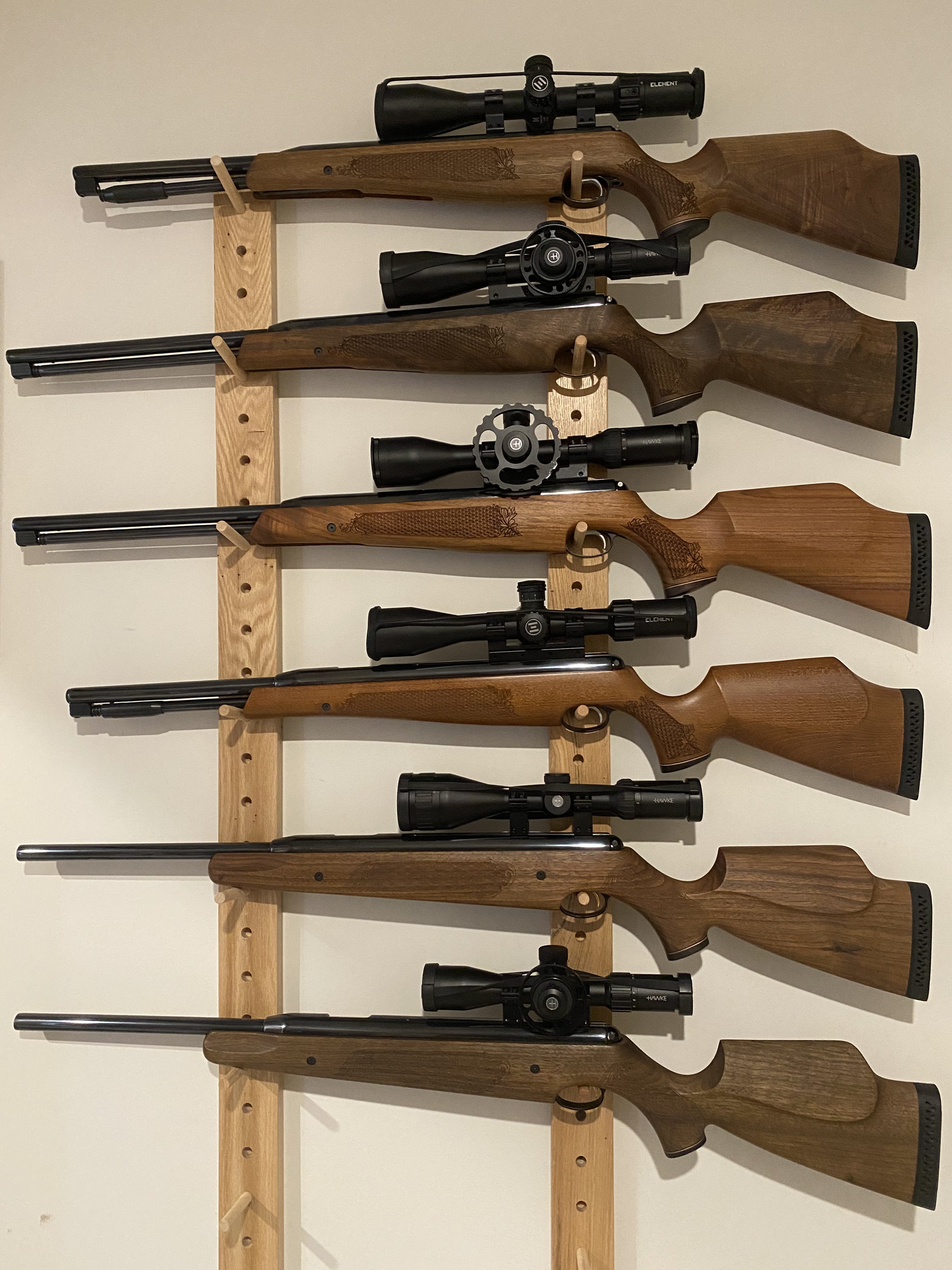

your wall mount gun rack is what I use also:D
