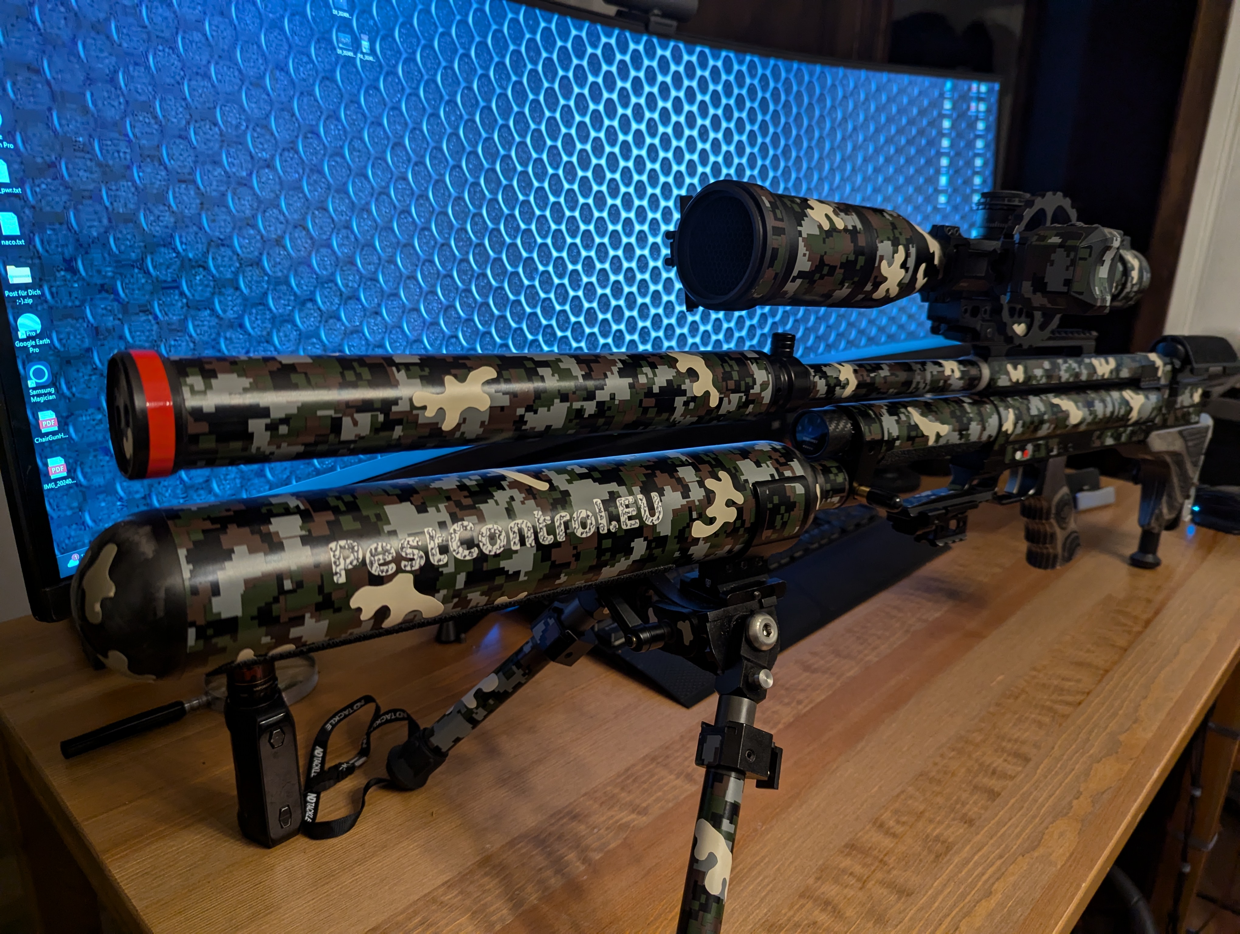

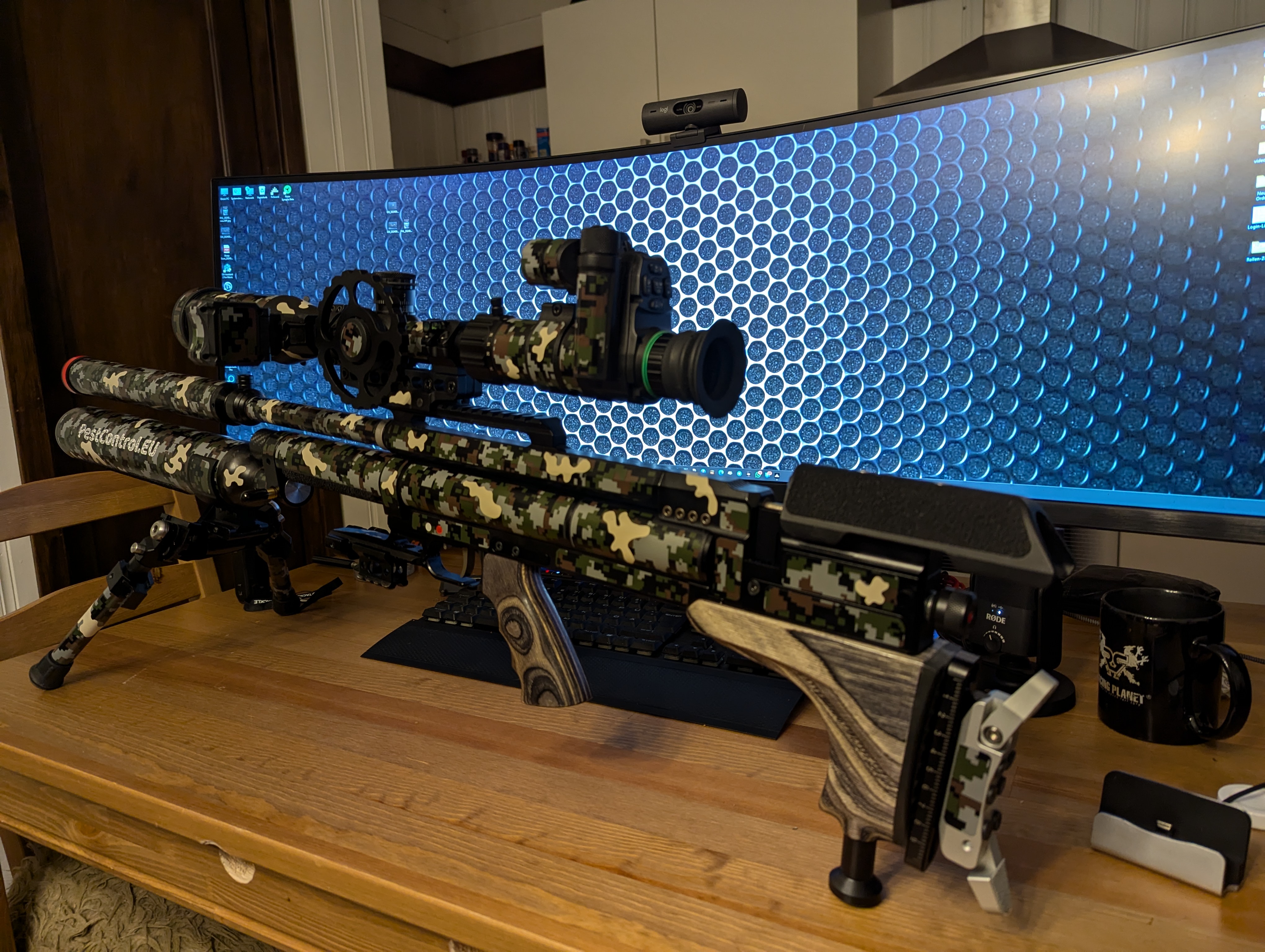

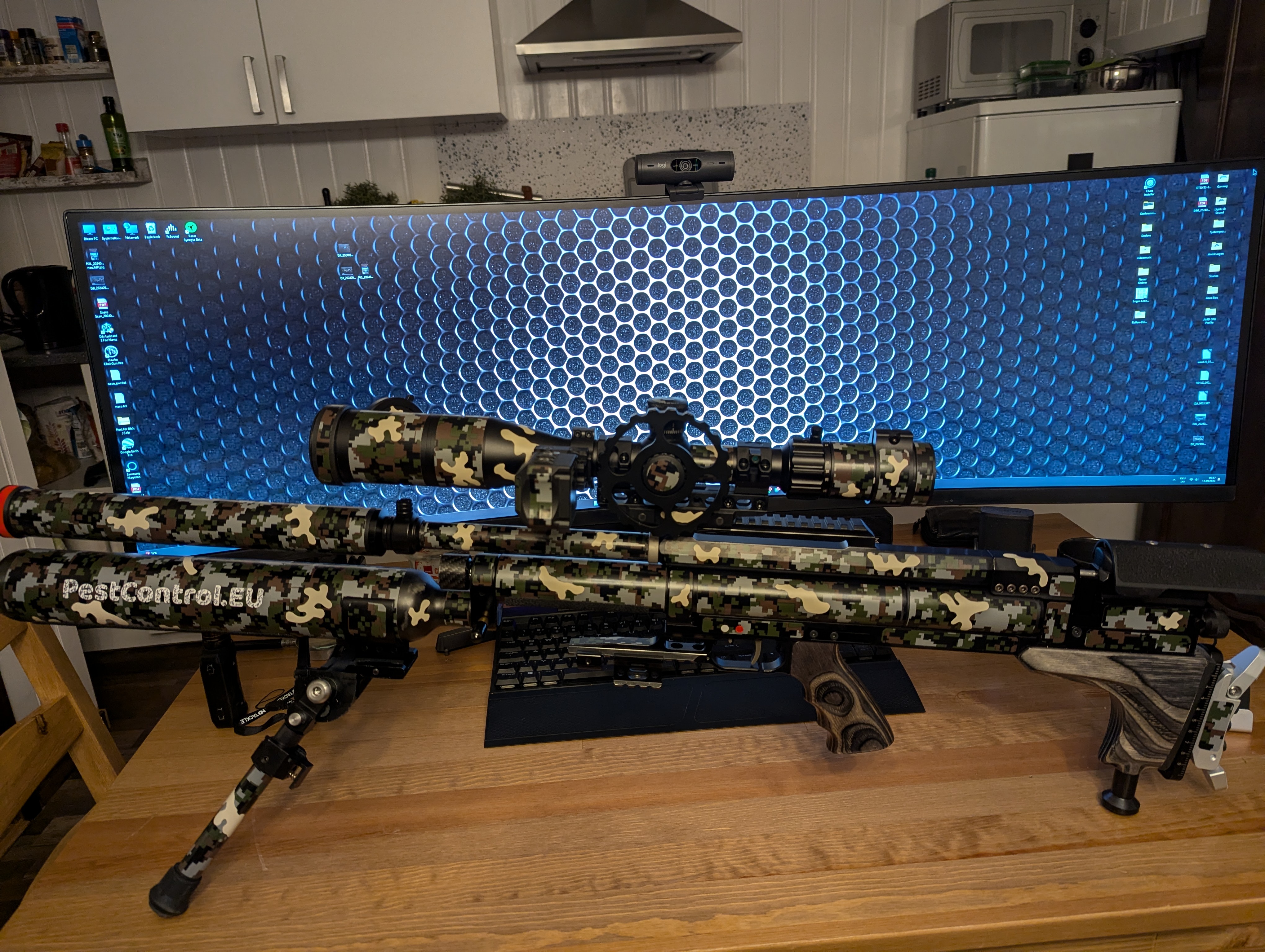

Taipan Time to show my Tactical2 for hunting day and night
LRP
Sep 14, 2024
33
48
700mm LW barrel cal..22
700cc bottle
Huma Air regulator at 175 bar.... ZAN slugs 30,4 grain -1003 fps
Modifid Valve and harder spring, big adjusterknob
Sekhmet gauge
Element 4-24x50 with Pard NV 007lrf Nightvision
Carbon bipod and a lot of other thinks
I´m from Germany and at the moment in Norway
Greetings
LRP
Reactions: Ranchibi

camo looks good on that gun. Also looks very quiet.

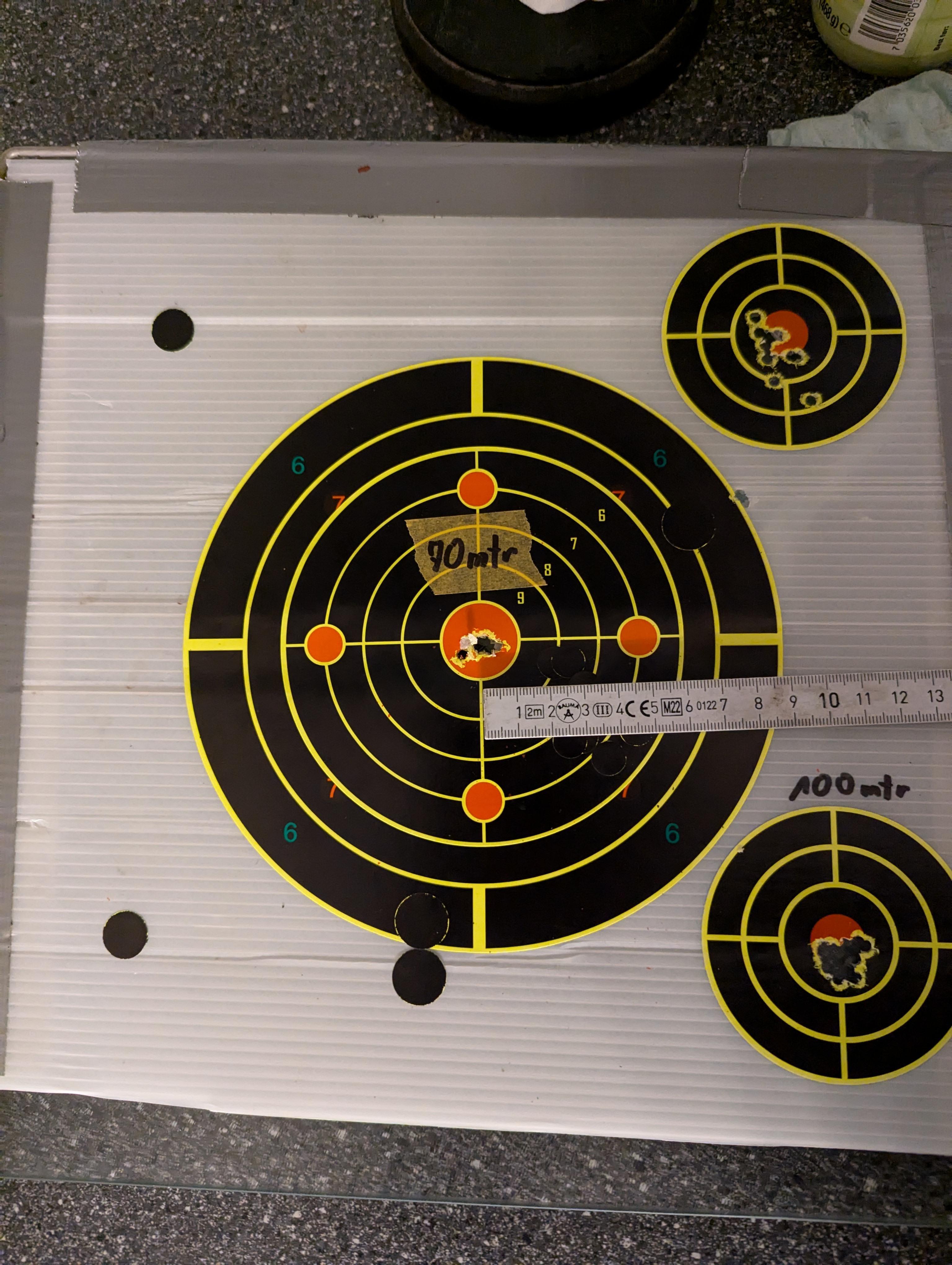

Accuracy with ZAN 30.5 grain, with 1003 fps at 70 and 100 meters (10 shots) no Wind. 304 Mtr hunting photos to come. Shot with Pard night vision NV700LRV on the scope. Shot with 2 tripods, one for the rifle and one for the left arm. At the top right were settings. With these settings 50 shots are possible.

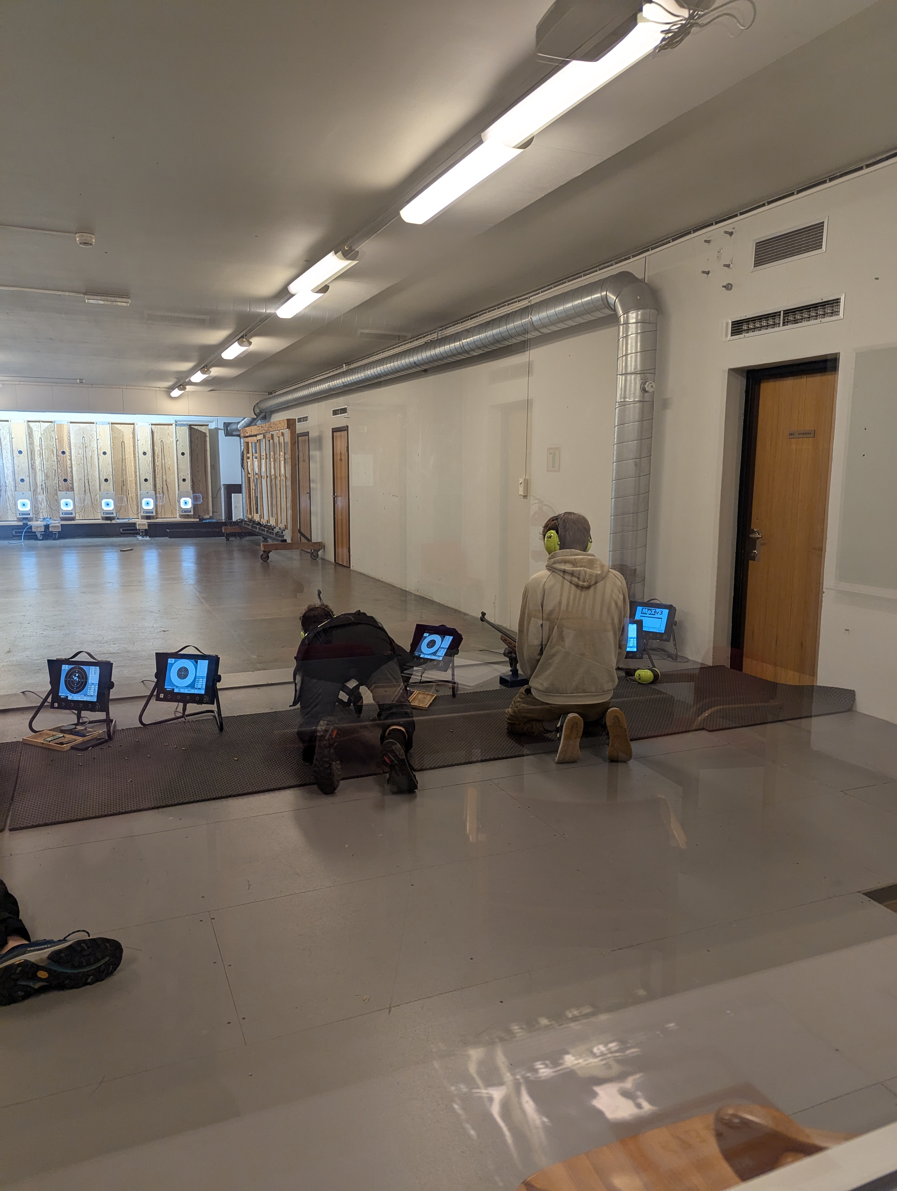

Next Wensday, i have a Callenge against Norweygian Biatlonshooters with 22lr rimfire in an Indoor ränge at 15 Meters with my setup (A little bit overdresst for that distance). I just tested it, hole in hole at this distance! My colleagues use sandbags in front, I have my bipod. Nothing is allowed at the back. We will see what a Airgun can do.

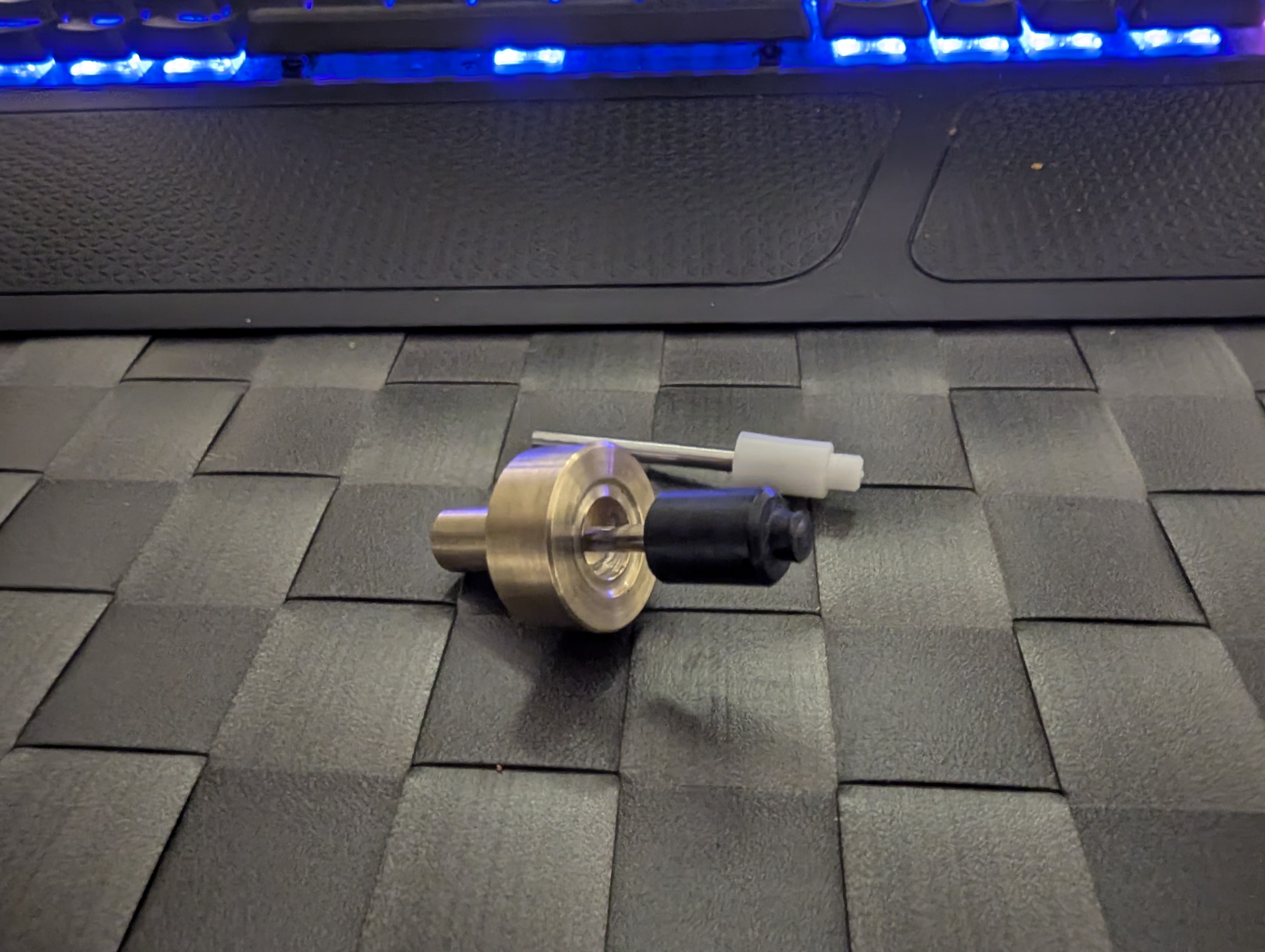

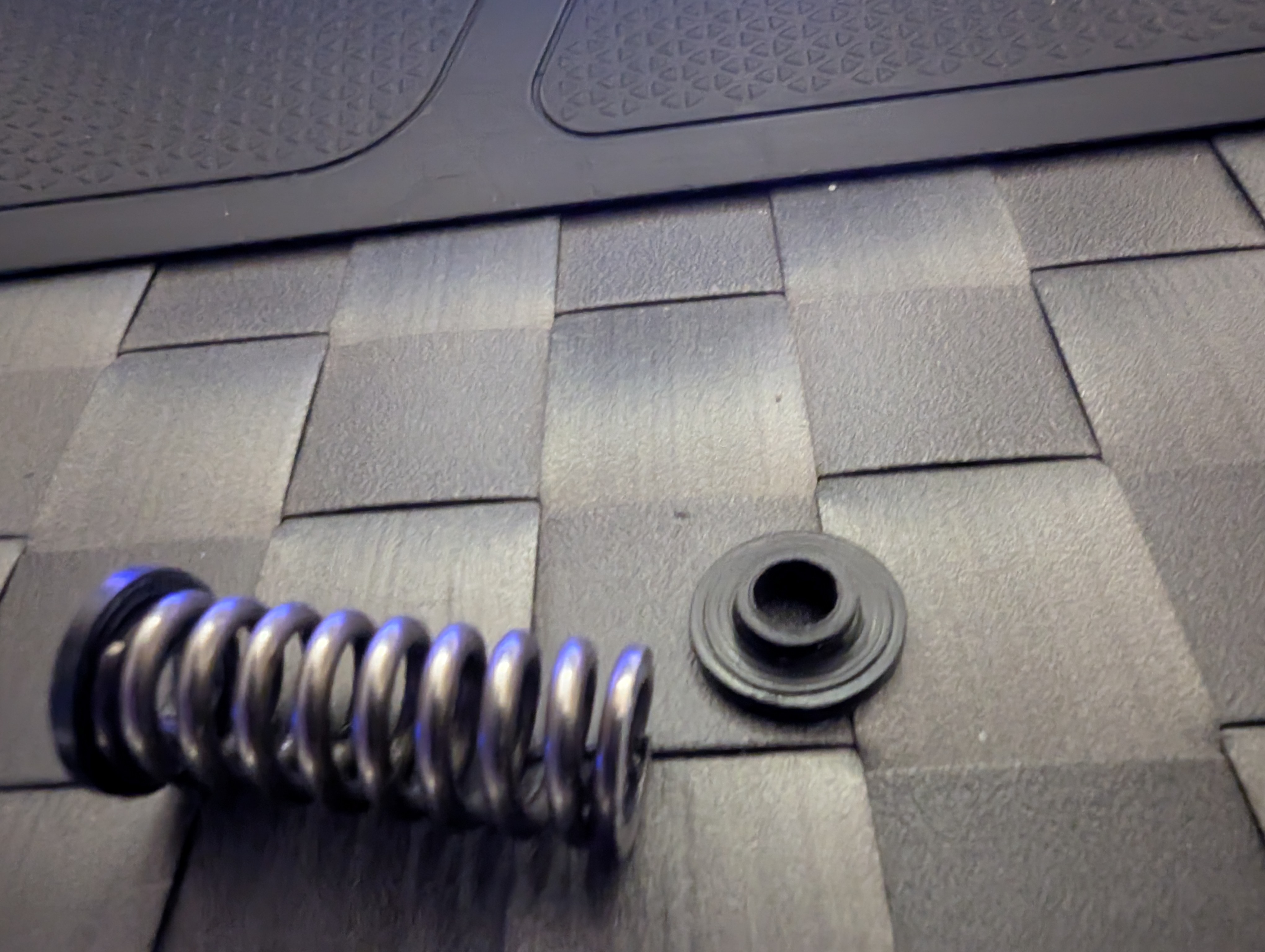

Back in Germany...... and here is the new valve and fits. Now with a 7mm bore instead of 4.8 in series production. The valvepin is made of tungsten for extra weight, also centering / sliding discs for the spring to prevent tension due to adjustment.
, I can only test it with the 40 grain slugs when I'm back in Norway in April. Target is 1020 fps with 40 grain Slugs.
Interesting choice of material for the poppet stem. I thought about a Titanium stem to reduce the weight and lessen the hammer strike needed.
But our goals are different. I’m looking for as smooth and consistent shot cycle I can get, not so much a max effort.
Keep us posted.
I’m on the same page. Don’t want to turn such a sweet shooter into a gremlin, so mine has a PEEK poppet to ease opening and a thinned stem to increase flow without enlarging valve throat. Allows for 60fpe at 140bar in .22 with the stock hammer spring.
