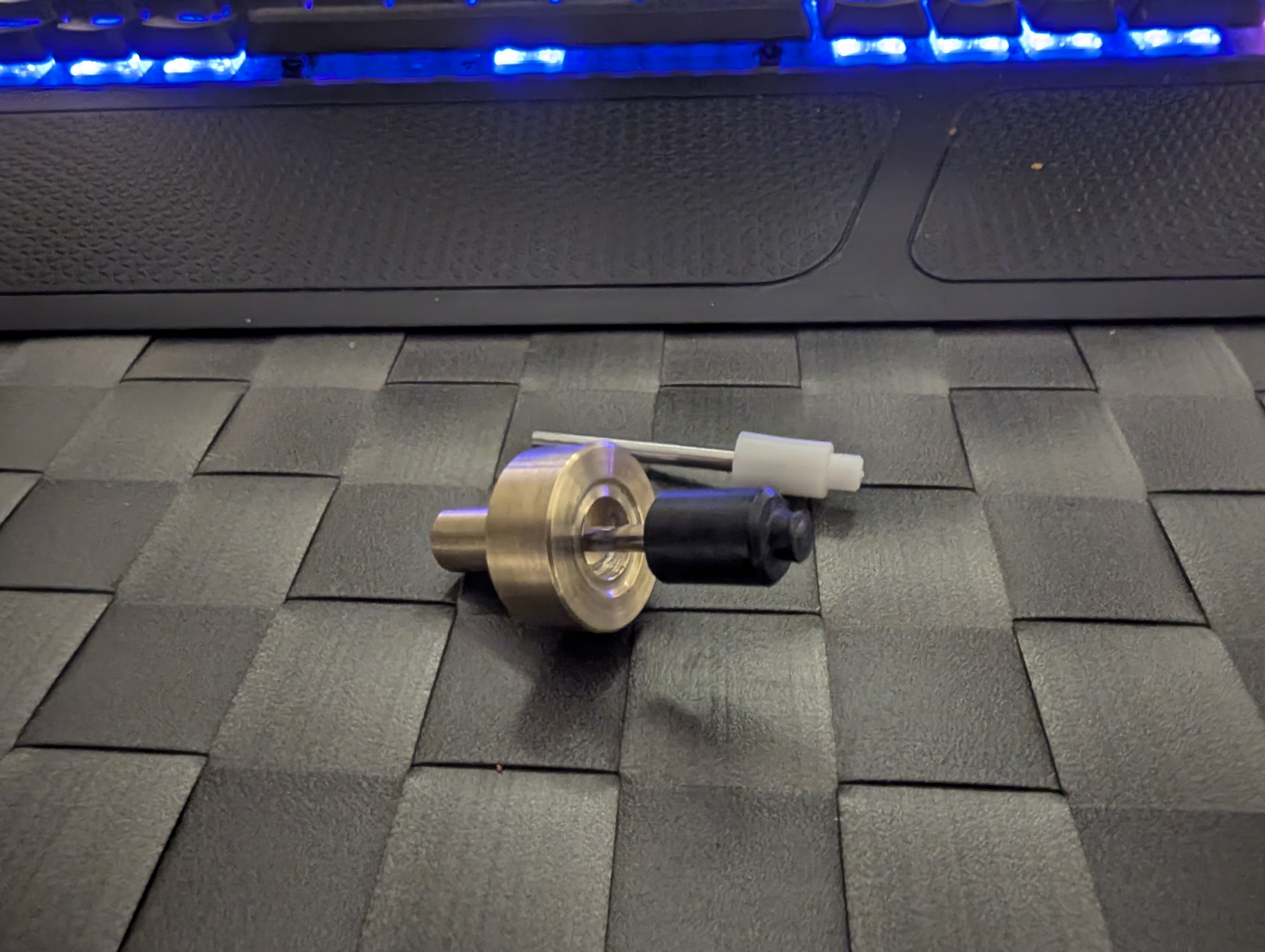

I’ve read your post on that mod several times. That’s my next project. Problem is, I don’t have any machining equipment and I’m not a machinist so I have to find a local that can do it effectively.I’m on the same page. Don’t want to turn such a sweet shooter into a gremlin, so mine has a PEEK poppet to ease opening and a thinned stem to increase flow without enlarging valve throat. Allows for 60fpe at 140bar in .22 with the stock hammer spring.
Question, is the poppet just a pressed in interference fit or is it glued/epoxied.
