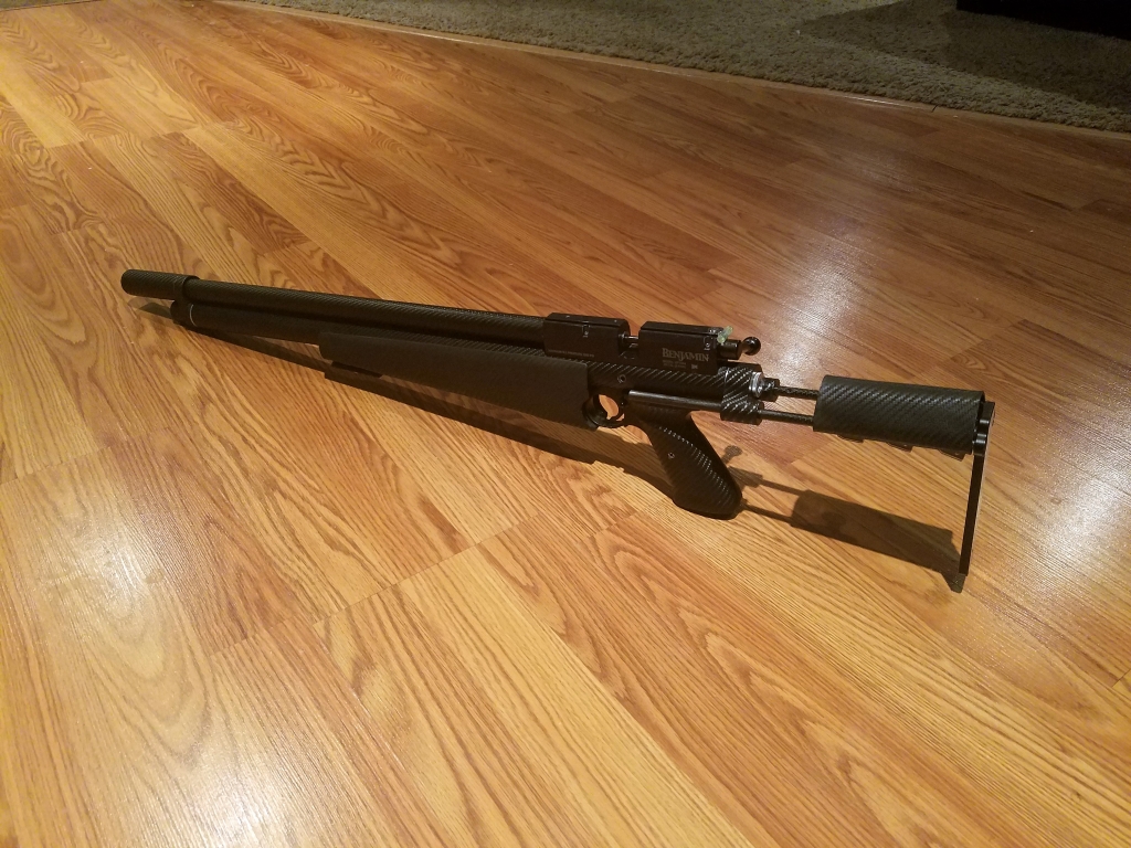

Here's another example a $150 Benjamin Discovery with a $125 multi shot breech $150 custom stock $200 machined Lothar Walther barrel $90 Marauder gen1 trigger group with spacer and trigger guard $125 Huma regulator $200 Hill power valve and TP and misc screws and seals $150 custom shroud and baffle kit to replace the crappy one included with the breech. So my $150 Benjamin Discovery cost $1190.00 without scope and mounts and it's almost like my $220 Benjamin Fortitude with a better barrel trigger and stock and at the end of the day it's still a Discovery for yet again the cost of a Taipan Veteran. All for fun right?
Next up a $300 22 Benjamin P-Rod With a $170 Marmot Militia Hammer forged barrel $85 AR stock adapter $140 AR collapsible AND side folding stock $200 Disco double tube $125 Huma regulator $80 Vernon custom grips $180 Hill power valve and TP and misc screws and seals $100 custom shroud extender with baffles. $1380.00 and not including scope and mounts and it's still a P-Rod. All in the fun! Yo!
Moral- A Friendly advice- save money make your own if you want to keep things less spendy. I don't wanna even think about what kind of a nicer pistol I could have bought with that $1380.00 I spent on my P-Rod (NOT INCLUDING SCOPE AND MOUNTS). OH I know a $1000 22 Ataman AP16 with that $350 cool as hell tactical modular side folding stock and dinner for 2. Good Luck. Yo!

Come on guys where are the pics of these modified guns?
Wow what a beautiful gun, and great idea. defiantly some thing to keep in mind.

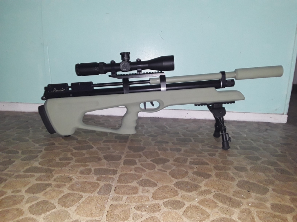

Here's a pic of my Mrod money pit😎
Lightweight air cylinder, couple different valves, regulator, shroud off Kral, bullpup stock.
I keep talking myself out of a new barrel because the green mountain. 25 is really accurate.
Marauders are a great platform to build upon, many directions one can go, with lots of part accessibility ranging from aftermarket to oem. For a sub 1k$ gun its a great 'tinker' gun.
Below, cheek rest holds 3 mags, adjustable lop, 5.2 lbs as pictured with an OAL of 34" with LDC collapsed, or 38" extended.. Custom LDC. Custom hammer/valve work, custom ssg, custom TP, modified gen 1 probe, custom front rail for bipod. My rifle is a 'tear down' that can have the gun broken down to a 24" length in just seconds for backpacking (have a custom backpack) I fabricated/modified most parts for the gun myself with a few sourced out to machinists.
One can spend 90$ on a reg, and a few hundred on other misc parts (or about half if DIY), and have an outstanding rifle for roughly 700-900$ provided you don't spend multiple times on the same part or buy overpriced aftermarket parts.

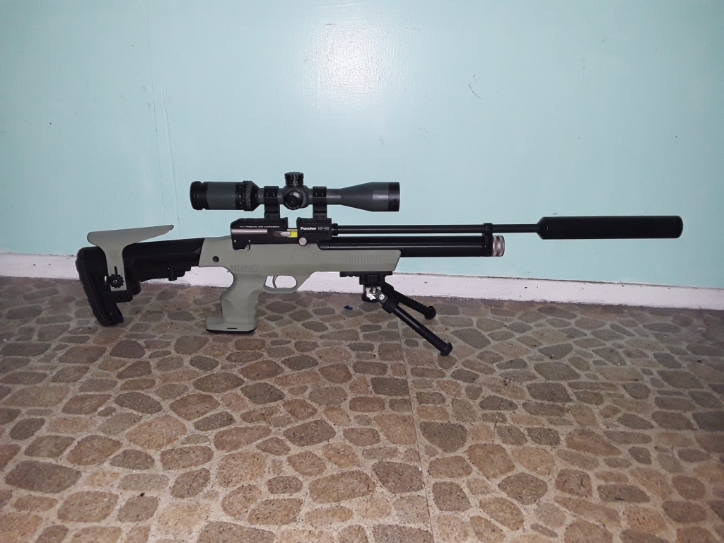

Or just buy a Kral, using hand tools open up the ports a little, a little barrel polishing here and there and you're done.
Very backpack friendly w removable stock.

These weren't available back when I got my marauder FWIW, but certainly there are many more options available now as the market has opened up A LOT in the last 2 years. But the part accessibility for Crosman is tenfold to that of kral, and this thread is about a tinker gun, not an open the box and be done with it.

I love my Mrod, and your skills in turning yours into what you ended up with are beyond those of most people who get into this thing.
Hell you came up with a lightweight air cylinder and your multi ssg system which I followed along with your posts, your extra plenum not to mention the customer stock.
Kral as a platform doesn't really need all the parts, and compared to the Mrod platform, even a hack garage diy guy like mecan work on them, I have 2 ofthem so far, but will be adding a bottle gun at some point.
Out of the box finit's fine, but with a little work, that anyone could do honestly, they are even better.
