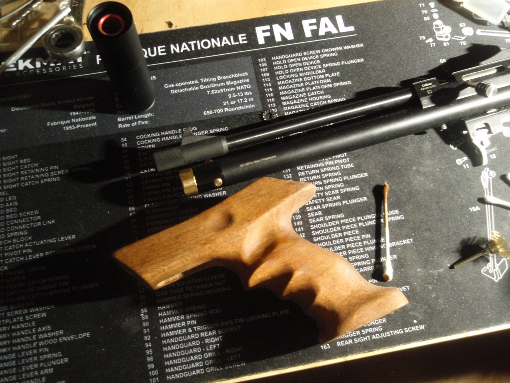

I'm posting mainly because my accuracy is suffering. The gun likes anything I put in it. The problem I'm having is with hammer inertia. When the sear disengages the gun rocks back a bit as the hammer starts its movement forward. I'm trying to think if there's a way to counter this inertia? Maybe my hold is just wrong? Or is this just something that's dealt with using practice, consistency, and follow thru? I don't do much shooting with pistols, so that's part of the reason I got this cheap gun to practice target shooting with and hopefully learn some new things. The scope is just there to get a better feel for exactly how accurate it is, and how well it shot what. I'm waiting for a mini holo sight to show up in the post.
So far, I've done a few mods. I had to cut the grip because #1 it didnt fit my hand, and #2 the receiver went in crooked. Also leveled the mounting face for the LDC on the front of the barrel/sight (just has cap on it now) pellets were clipping baffles it was so poorly aligned. I've polished the barrel, port polished the internals, and installed a custom huma reg. setup. There is no plenum, and the valve assembly has been cut back to increase air cylinder volume as well as bored so a plenum was not needed. I'm seeing almost 50 shots in the 630fps range. 210bar down to 70 bar. At 130 bar this gun was putting out close to 18 fpe in .177 😬 That seemed to be the sweet spot

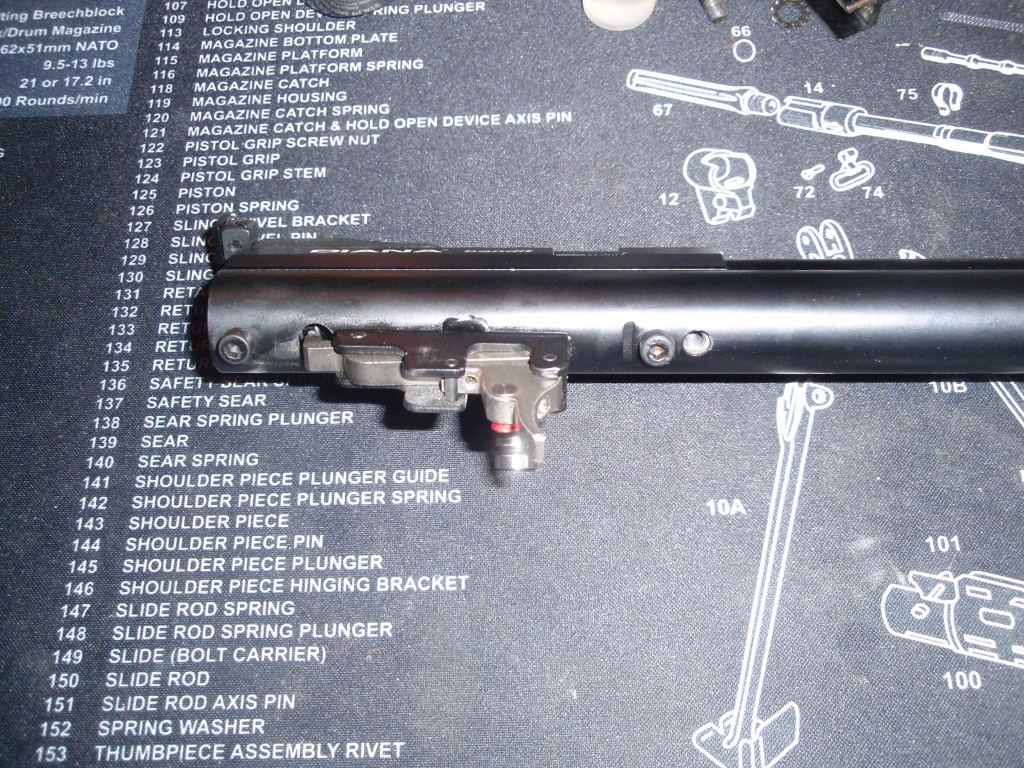

can you tell me if the trigger has 2 adjustment screw visible when the trigger guard is removed
and if the sear spring is in the middle of the sear or the front
if in the middle it has the same setup as the a Chaser and you can improve the trigger assembly function and feel to almost match grade almost
I have posted several times on my Chaser trigger work but I never seemed to get much feedback so I will not post it again here
the main problem with the triggers is they are sloppy but easy to assembly at the factory and even what they call a 2 stage trigger it is not
so that what I have spring in the middle of the sear, like the Chaser in the front like I guess the 700
Yes, the trigger does have two screws. Which I have adjusted to a comfortable level (my safety no longer works as a result 😂 so I didn't make it horribly light or short) Safety relies on hitting the trigger guard to stop trigger travel.
The spring is right under where the back of the trigger pivots onto the sear, so I guess the middle. The trigger was sloppily welded in place. But it actually works very well. I'd have expected it to be worlds worse.

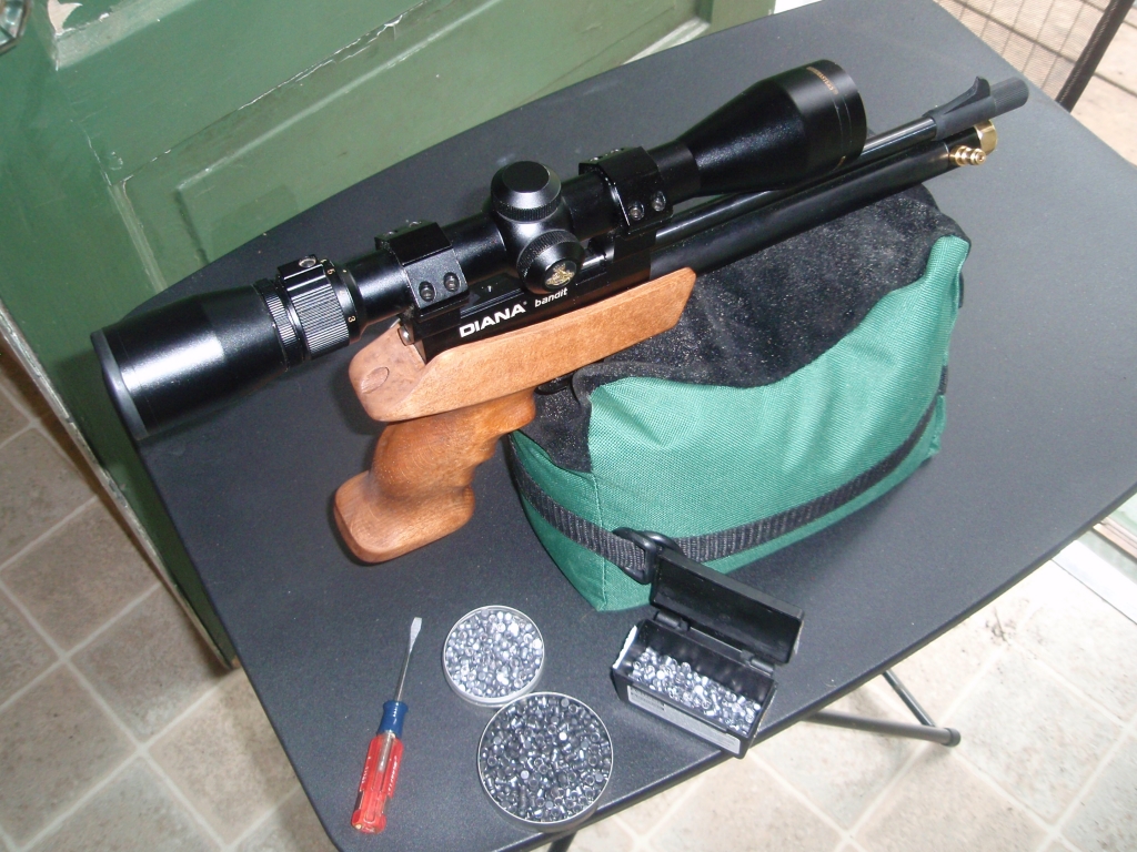

I have a .22 Bandit,it is stock and at 22yds all pellets touch,it is accurate enough and the trigger is fine for me.
Follow thru is always important. This is one pistol that to me needs nothing....I use the single shot tray ,hand pump it,also get about 24 shots before too down on power
It is not my most accurate pistol,butt the most fun to shot........so far.

So, youre a much better shot than I 😎 And thanks for the tip, I'll work on it. I could tell with the scope on, it wanted to shoot right where it was aimed. Out of the box I was real impressed. I think the only thing it NEEDED was for me to level the front of the barrel where the moderator butts up against it so it was straight and the pellets didnt clip the inside of it.
I cant leave well enough alone, though 😂
so that is the same trigger system used in the Chaser
the front trigger screw does nothing more then push the sear down and the farther it is screwed in the farther the sear lift and shortens the hammer engagement
the rear screw can be made to be what trips the sear but the 3mm in length one is too short, 6mm screw with and 2mm bearing ball will give you some adjustment
if you do nothing with the pins which just fall out, a trigger stop is a great over travel fix and put between the front and back trigger screw area
the sear is hard as hell and needs to be torched and drilled for a 3mm x 6 to 8mm in length grub screw
the pins are way under sized I ended up using 2.5 mm drill ends but they have to be hand fit and with some RC aluminum shims the trigger was no longer sloppy
so with a light sear spring and all of the hand fitting and such the trigger movement is light and down to 1.5mm in total movement
the one thing about the trigger setup, you can just do the work on the table, twisting the screws and watching and feel what is happens
but these are just ideas but they are proven ideas

Beat you to it 🙂 you are right about the hammer being not only too heavy, but also too stiff. I fine tuned my hammer spring as well as heavily fluted the hammer to reduce weight. I may fiddle with it more, but I feel it's been dialed back considerably in both regards. Of course that did help. I'm starting to think its just my hold that needs work.

I don't mind the wood grip... But the size and proportions are kind of ludicrous. Good if you want to cut it down to fit your hang because it's huge. So, I'm still working on that. Mine has had huge amounts of wood removed from the exterior, though It's hard to tell without having an unmodified one for comparison.

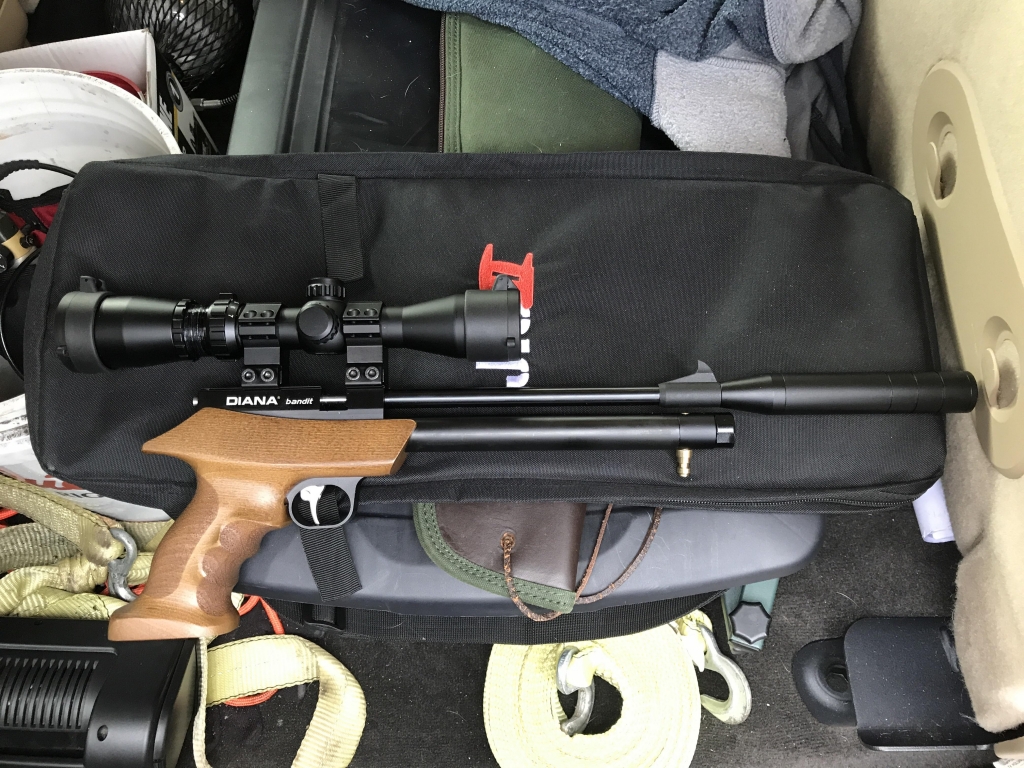

The Bandit is my 1st air pistol and so far I like it, took of my BSA scope off it today and put a UTG Accushot 2-7x32 on it and now I need to re-zero it in. Also bought a barrel band for it but still need to put that on, figured it would stiffen up the barrel, I also want to move the fill probe to the side position rather then straight down, just need to empty the air and loosen the gauge hopefully then turn the probe.
That does sound like it might be in order 👍 I'll give the mini holo sight a try, and will likely order that scope, too 😎
Still working on getting the grip right. Havn't got to shoot it much lately. Thought I was finished, but had to take it down on the bottom right side of the grip (bottom of palm was being cramped) This is the opposite side where I took out a lot for my thumb, and made a small perch for my other thumb.
