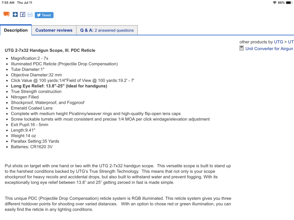

The UTG 2-7x32 is a handgun scope and eye relief is like 13” to 24”, I like using the handgun scope off bench but not so much freehand.

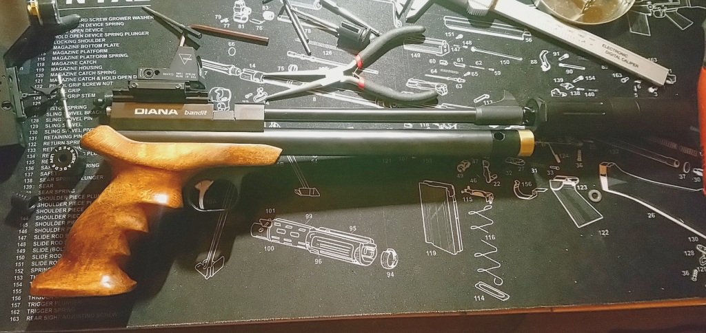

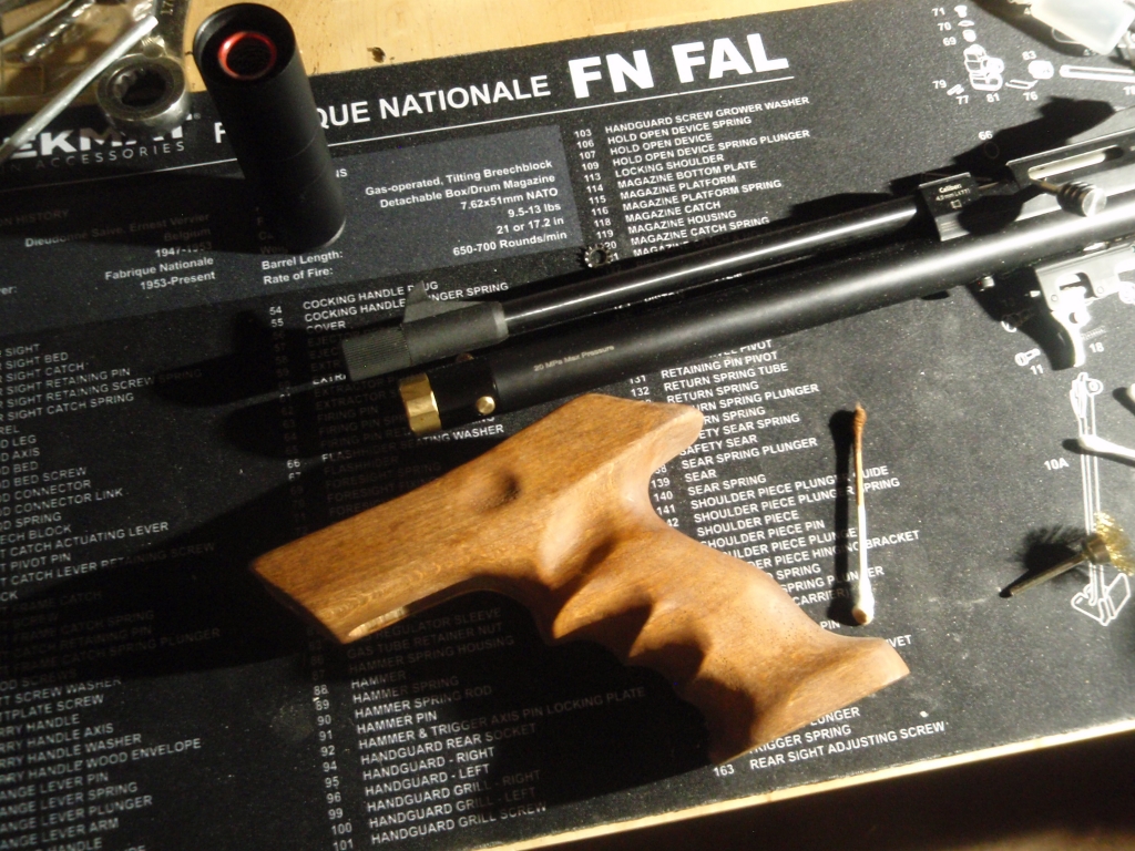

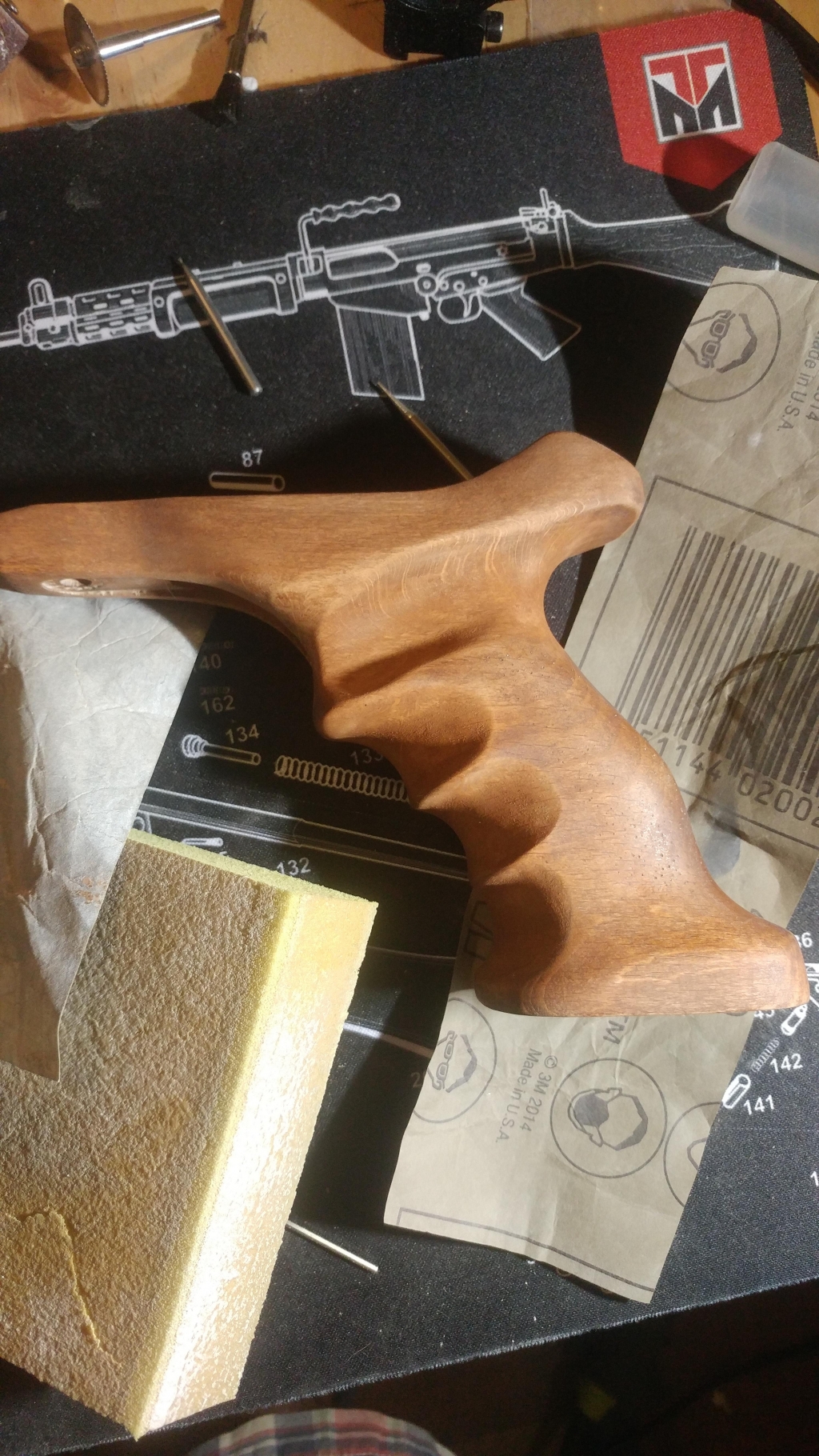

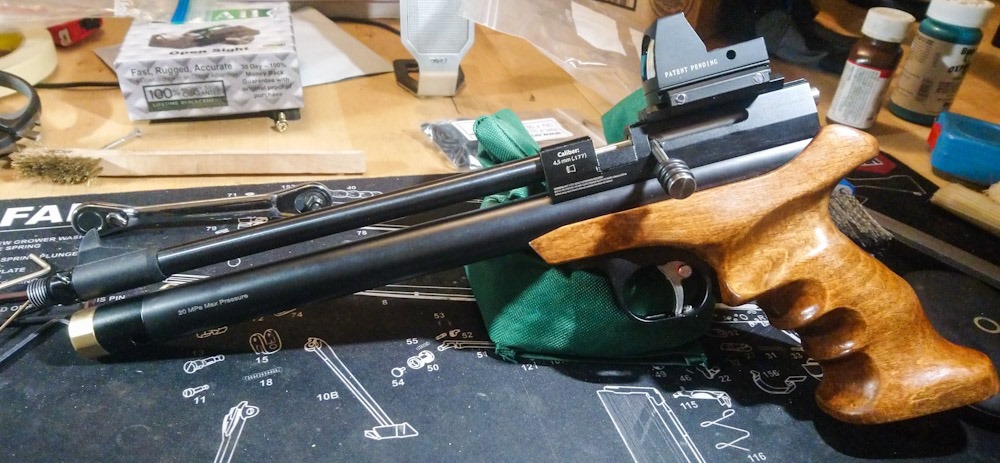

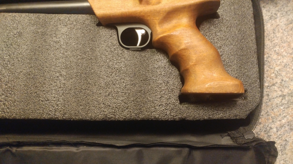

What tool(s) did you use to modify the grip? Your newly styled grip looks pretty nice. I would love to do something like that.
Also, what did you use to make the design change? Modeling clay or something like it?
