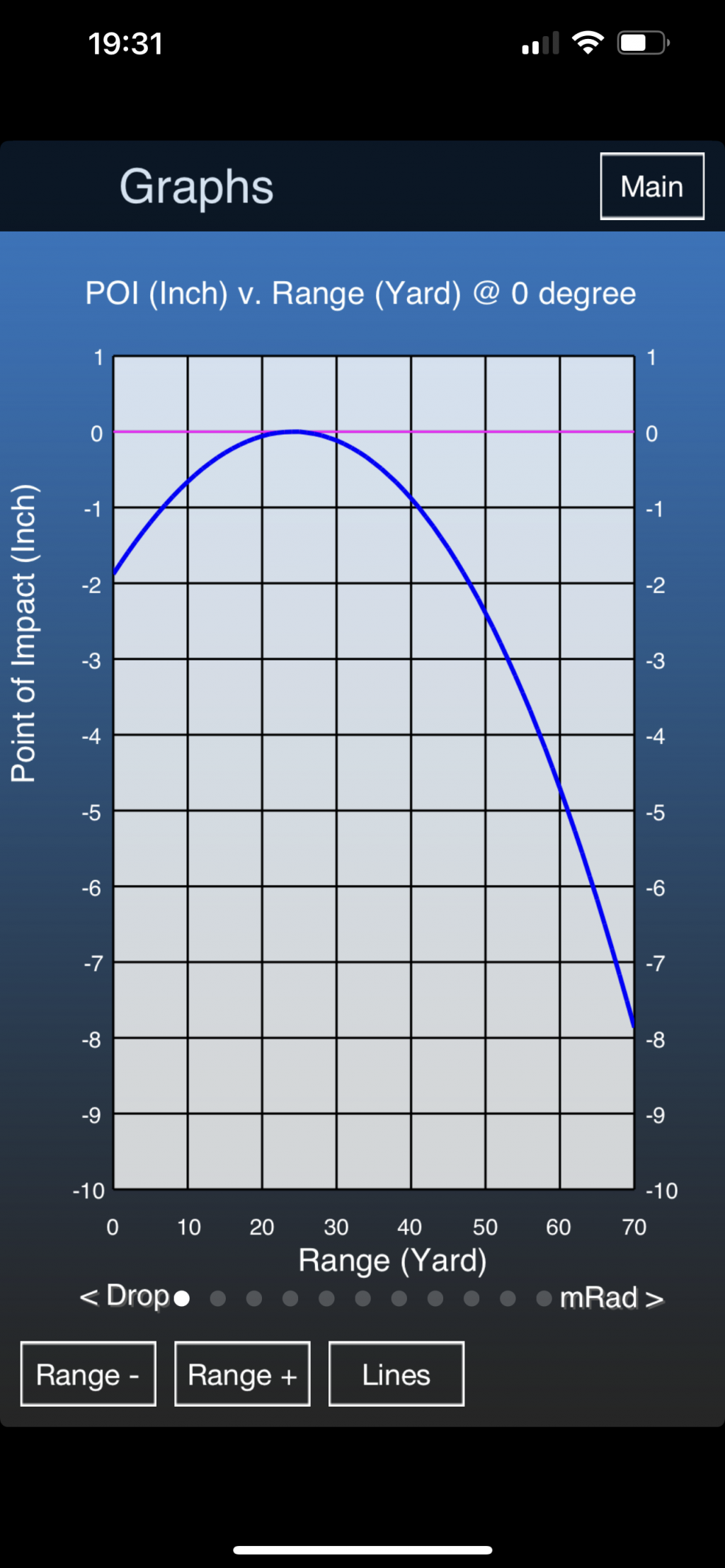

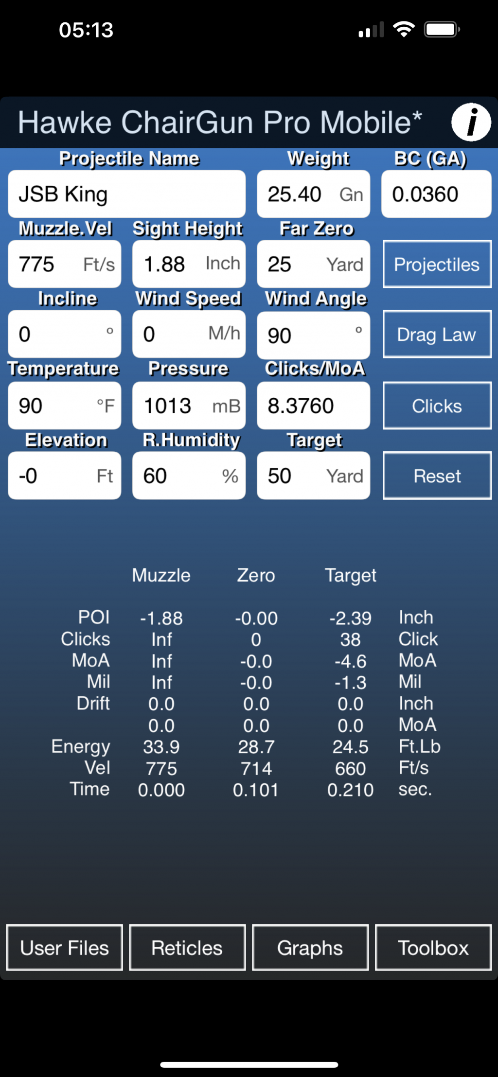

@wildcj5 I’ll look into it. I’ve read posts of people using Strelok and Chairgun. I have never seen or used the apps personally. Up until this point I have been adjusting my shots on the fly using holdover(under) and windage markings. I haven’t been dialing my scopes while shooting. I guess I’ve reached my limit with the way I’ve been shooting with this gun/scope combo without assistance. A while back I purchased a bubble level that also measures incline. When it arrived I was wondering when I would use that feature and for what. I guess I know now. Thank you.

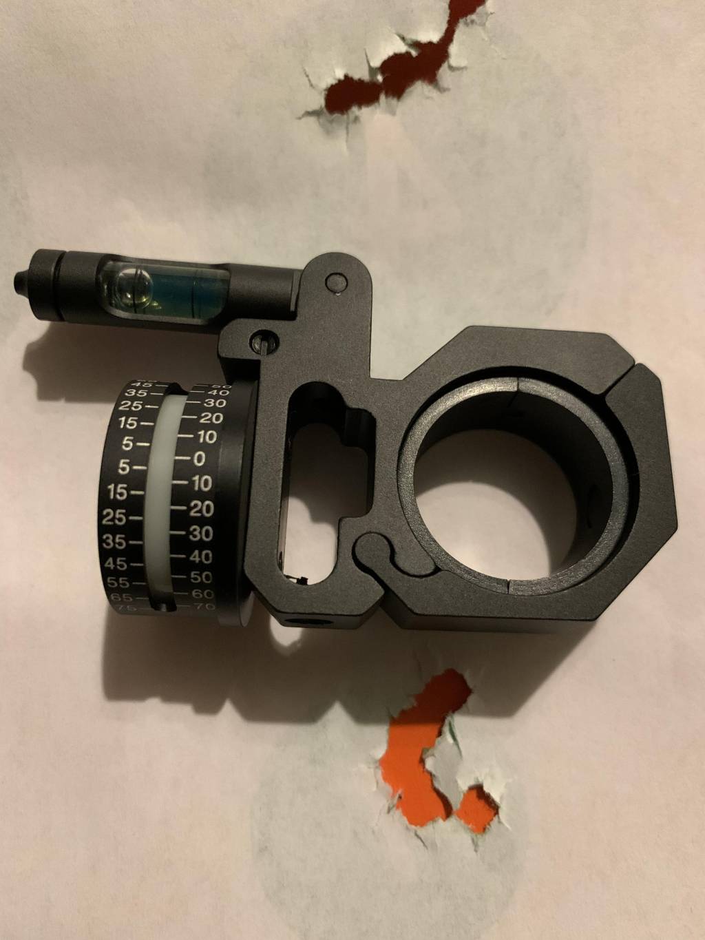

Edit: added another detail about scope level and photo. Here’s the level
