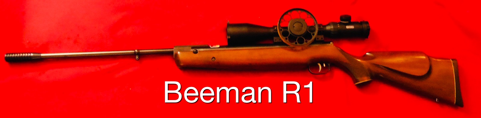

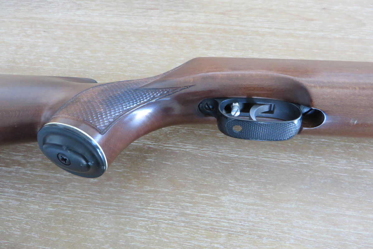

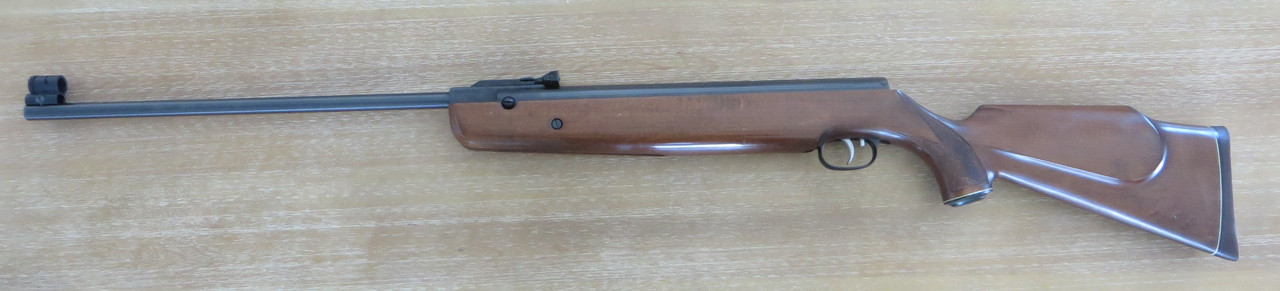

The Beeman R1 is probably the nicer of the two. It is a rebadged Weihrauch HW80 with the Rekord trigger. Heirloom quality for sure.
Thank you, it certainly has a nicer stock with checkering and cheek piece.
The action on both seems pretty similar, but I like the trigger on the Beeman a bit better.
If I were to sell the Beeman I would imagine it would fetch a bit more than the Diana.....
What would you guess the current retail value on the Beeman R1 would be currently, minus the scope??
It was built in 1998 and is a Huntington Beach gun and is in .22 Caliber

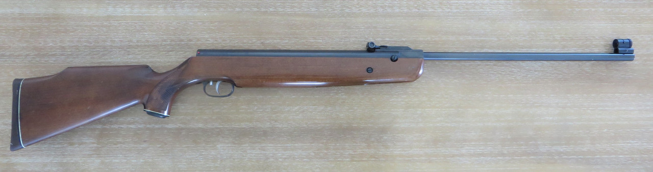

This 1984 R1 (Not a re-branded HW80) has been shot 425,000 times and helped raise two combat veterans:
