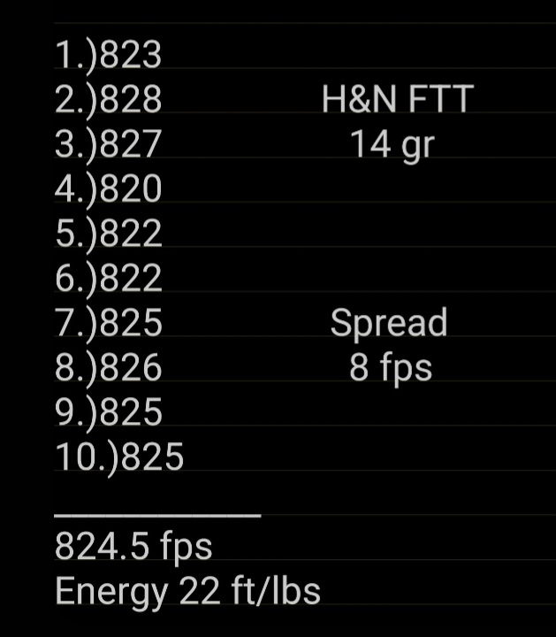

4. Test firing - cocking stroke is smooth and clean, firing cycle is very quick. Kinda sharp, like an FWB Sport. The rifle is now making between 22 and 23 fpe, and doing it in style. The rifle is accurate, hitting small spinners at 60 yards consistently even though the rifle was only quickly and roughly sighted in.

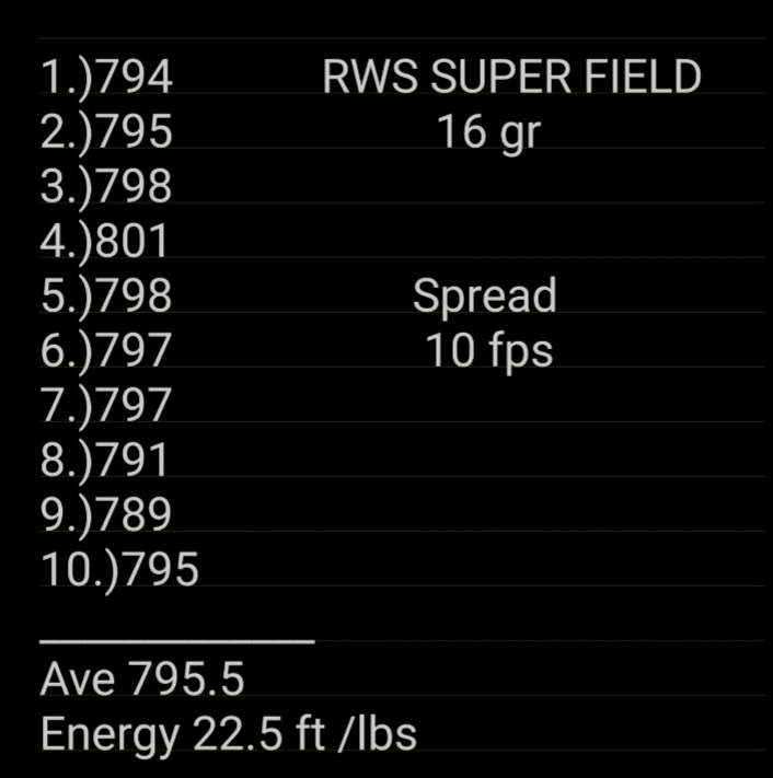

Pellet selection. I was reminded that this particular Diana has a somewhat "loose" barrel but 5.53 H&N FTT's fit nicely where RWS Superfield 15.9's and Baracuda 18's did not. Pellet selection will be important for this rifle.
Also, I now pwonder if those low 16fpe velocities with the ARH spring could have been due to delayed pellet skirt sealing due to the large barrel bore and modest spring force.

Plus, the ARH seal probably only has 150 shots on it so far, and the rifle gave excellent numbers with the only proper fitting pellet. See below.
