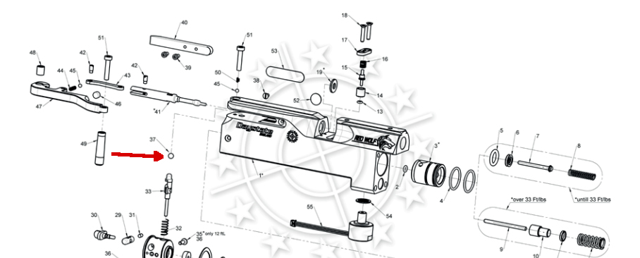

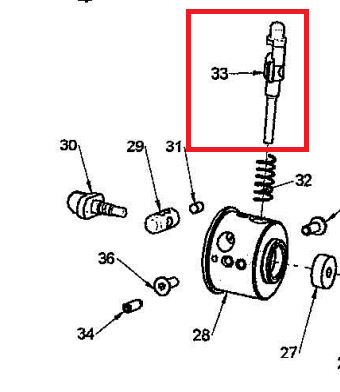

I know the problem is in the safety block (the G.C.U 2 works perfectly) because the bolt safety pin (part n°33) is blocked and it doesn’t return to his initial position and it can be because of the safety pin spring (part n° 32) that doesn't works like it should, so it doesn’t allow the gun to fire and work correctly.
- Does anyone had the same problem?
- How can strip the safety block?
- Do you know how to fix this problem (photos or videos)?
