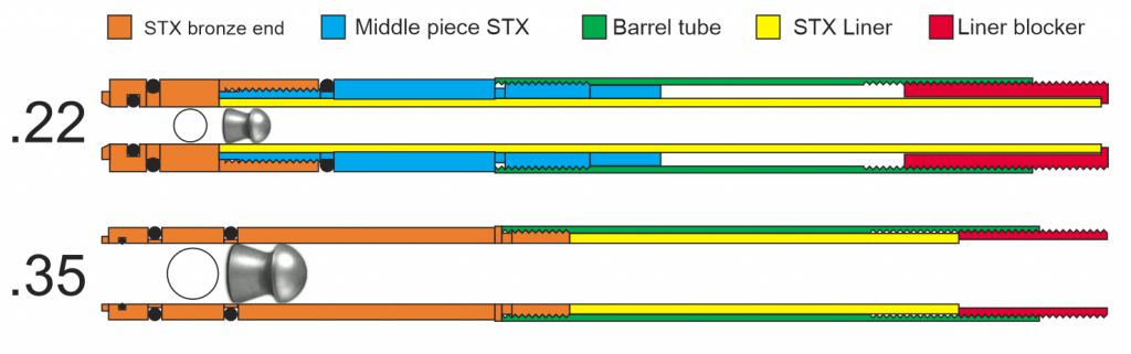

Few days ago I boughr .35 Liner, but I can't find anywhere 2 required parts to asemble barrel. this is:
1) Barrel inlet (bronse part)
2) Liner Lock (shiny skrew end of the barrel, with 1/2-20 thread)
can anyone help and show me how they look and measure them.
I have a tube to machine Barrel House, but because .35 liner is too thick (12mm OD) this mean I can't machining usual "Barrel inlet" and "Liner Lock". Will be haapy to see how this 2 pars are made and how they lock the liner in the Barrel House tube.
I drew my idea, maybe it is correct, but I will be happy if I see how the original details were made.
Full size Picture

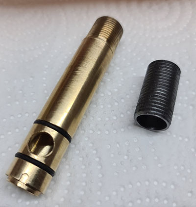

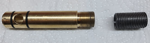

I have more then 12 years experience to repair and made parts for airguns, and can made this two parts, nothing complicated, just wanted to check if my idea is the same as FX or not
I will definitely buy the original required 2 parts when they will be available, hopefully they will be available soon, but before that I can make them and shoot
P.S. today I made 2 test parts, will check them soon, but still interesting whether my idea coincides with FX or not

Nice work, don't worry about Mark. Some people are better at making things and others better at buying them.
