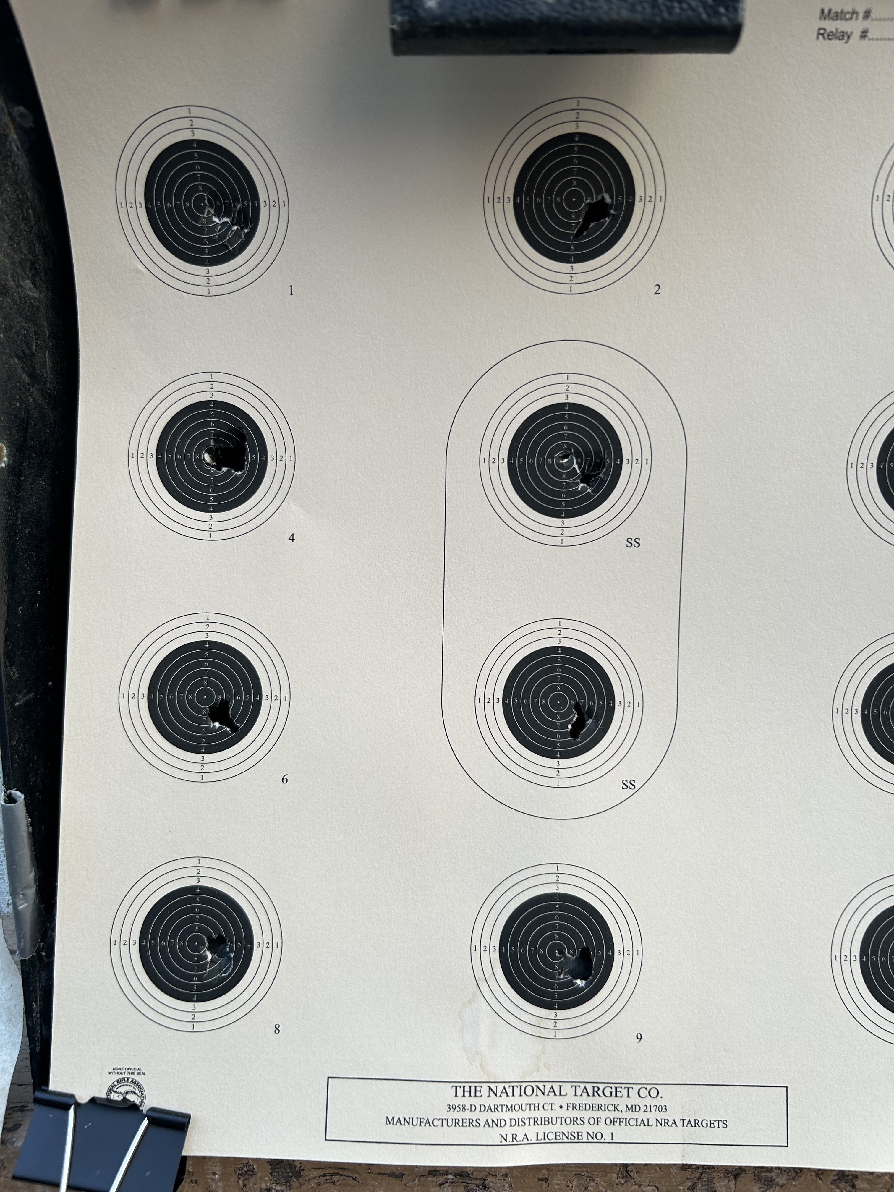

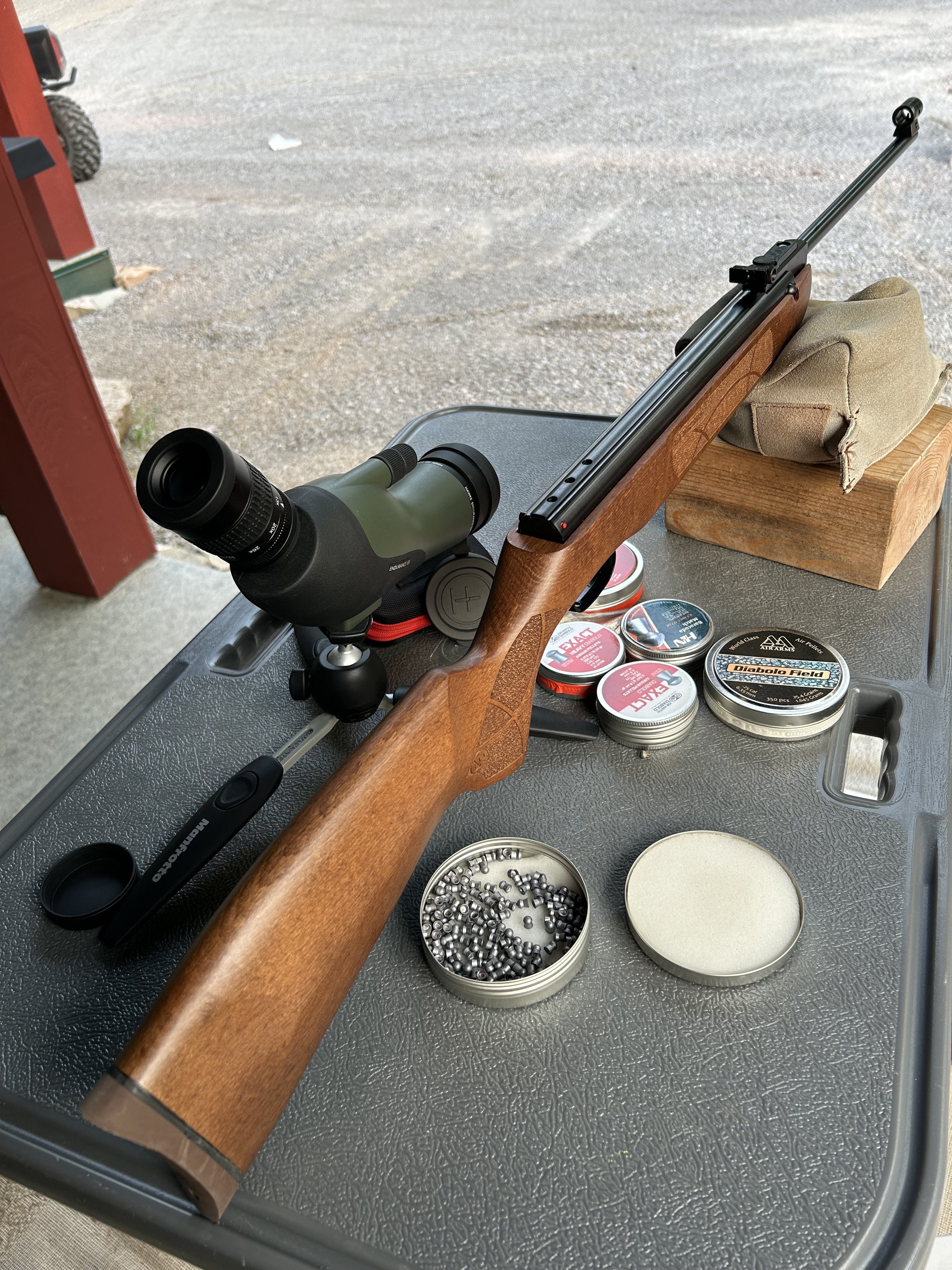

Today is different for me but hugely entertaining. I took six of my guns with iron sights out for a gentle comparison. What a hoot. First up HW30 .20. I had a target set up 10 meters away for a reason.
Just got this baby, no scope yet. I was able to get excellent groups, but found it difficult to see sights. This next rifle is my garbage find. FWB 300
Haven’t shot it much. Stop the clock. Should have my mind examined, what a gun. Five quick shots.
Where did these go? And why?
Get them back.

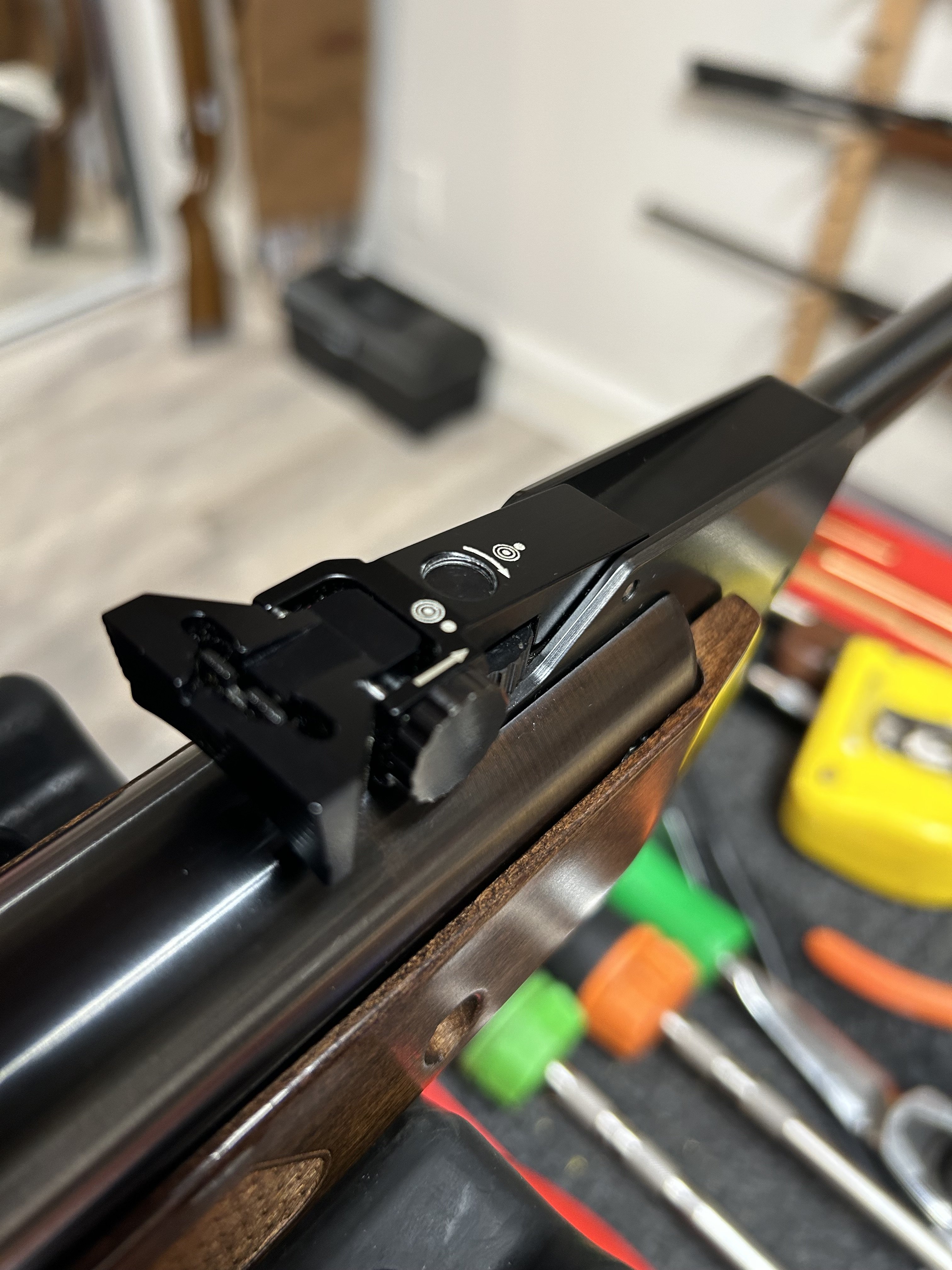

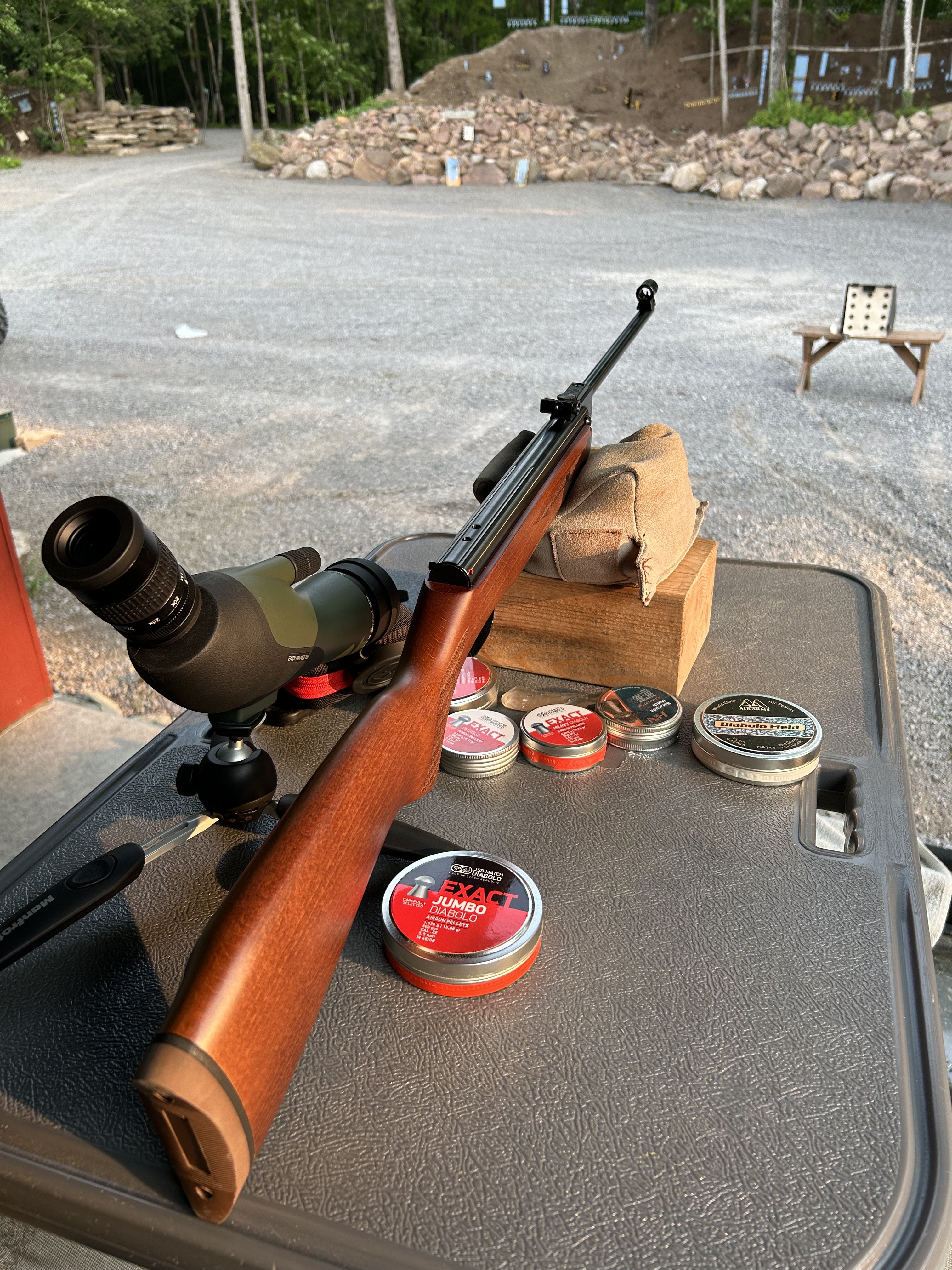

I really like these peep sights. Way easier to focus. This puppy is going to see a little more light. Nothing short of amazing. Talk about set the stage.

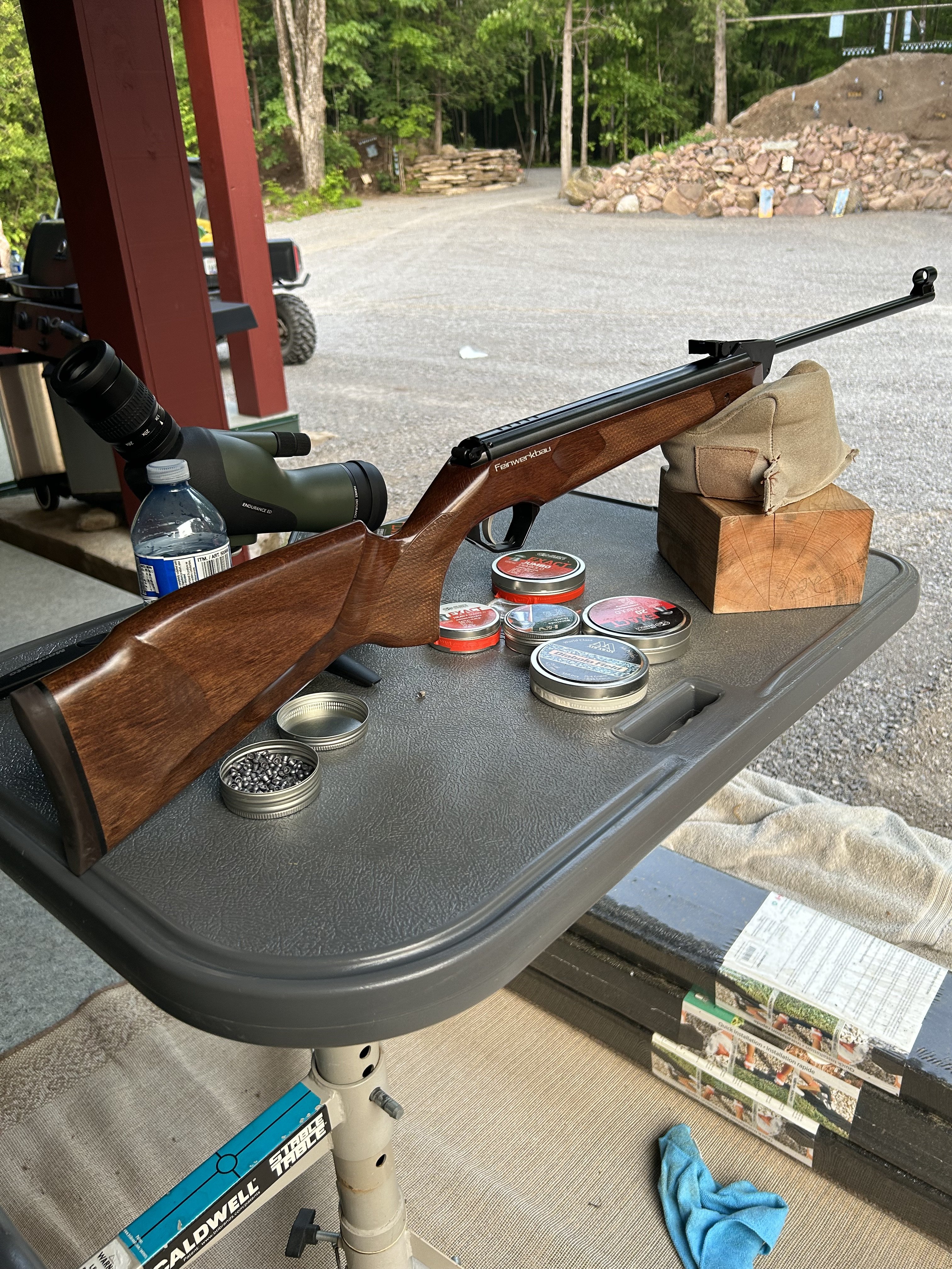

‘Next is another new gun a HW50 .20. maybe 10 rounds through it.
Once sighted in it held its own. Again I had trouble focusing but doable. This one will be joined at the hip one day, sweet guns.

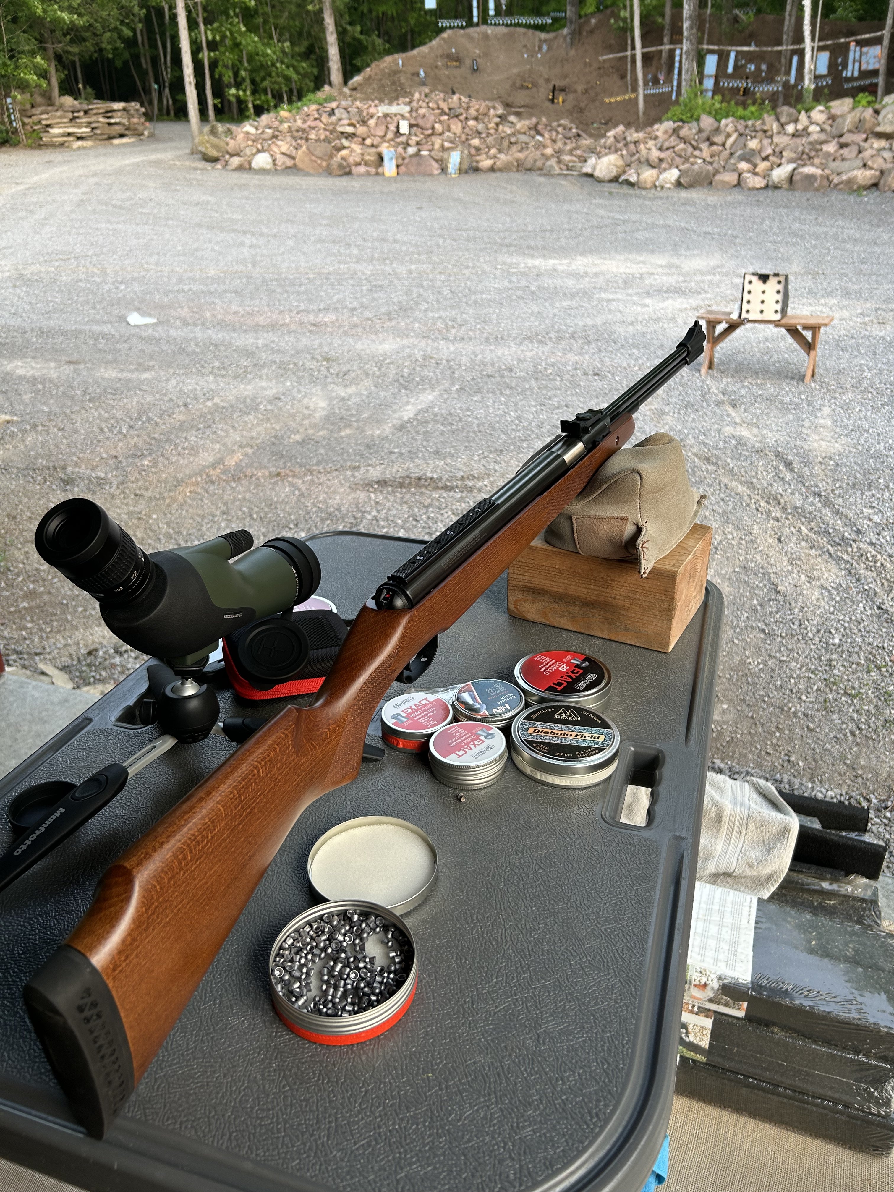

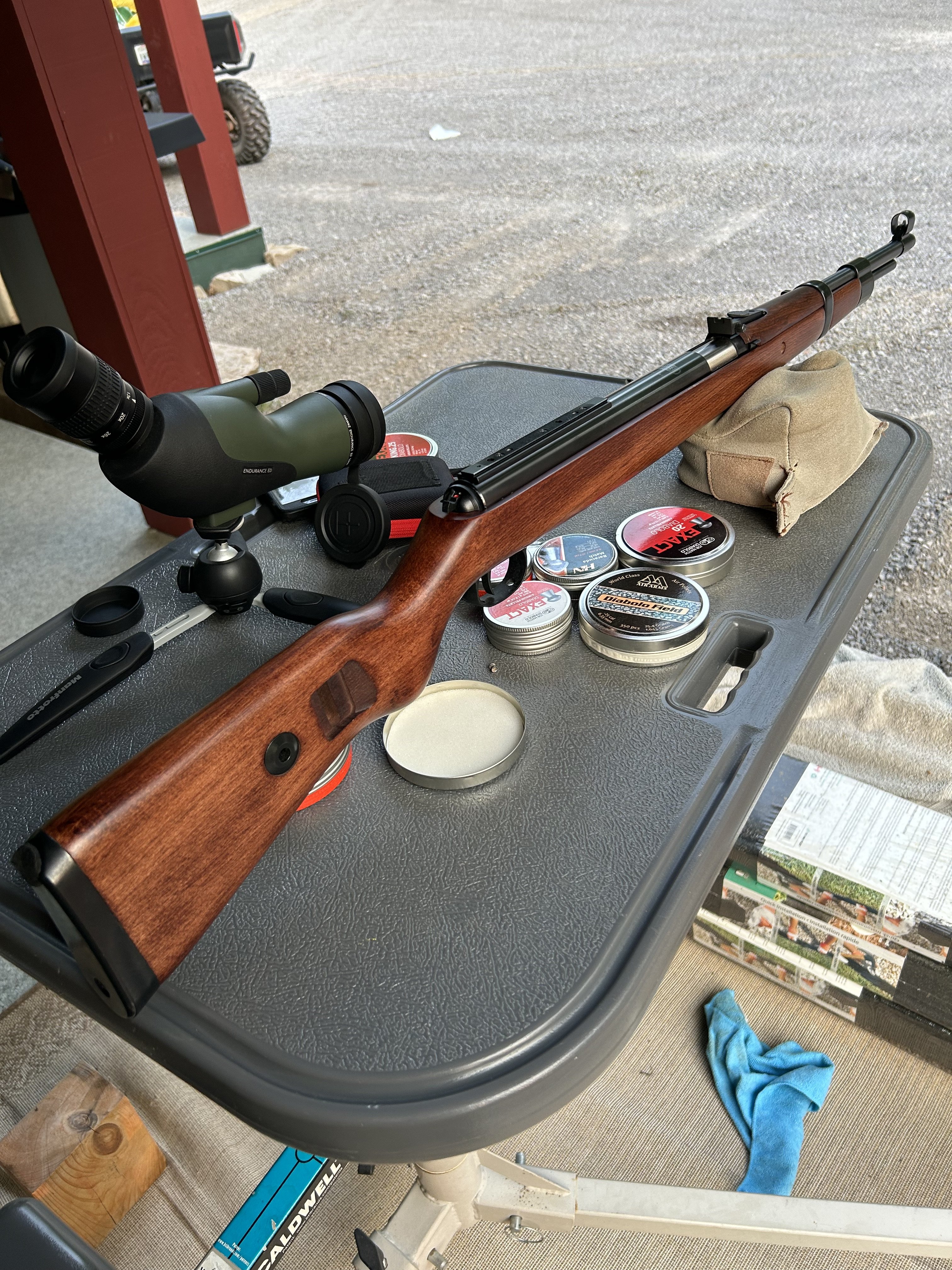

‘This is my last score. I was looking at 3 rifles, I meant to grab the 350 mag. but I grabbed a D460 .22 by mistake.
This gun kicks like a mule, but accurate. I have it in .177 as well. I find the plastic sights a turn-off, but effective. This next rifle is the same gun with a different skin. K98 .22. I found out that were the same 2 days after first shooting it.

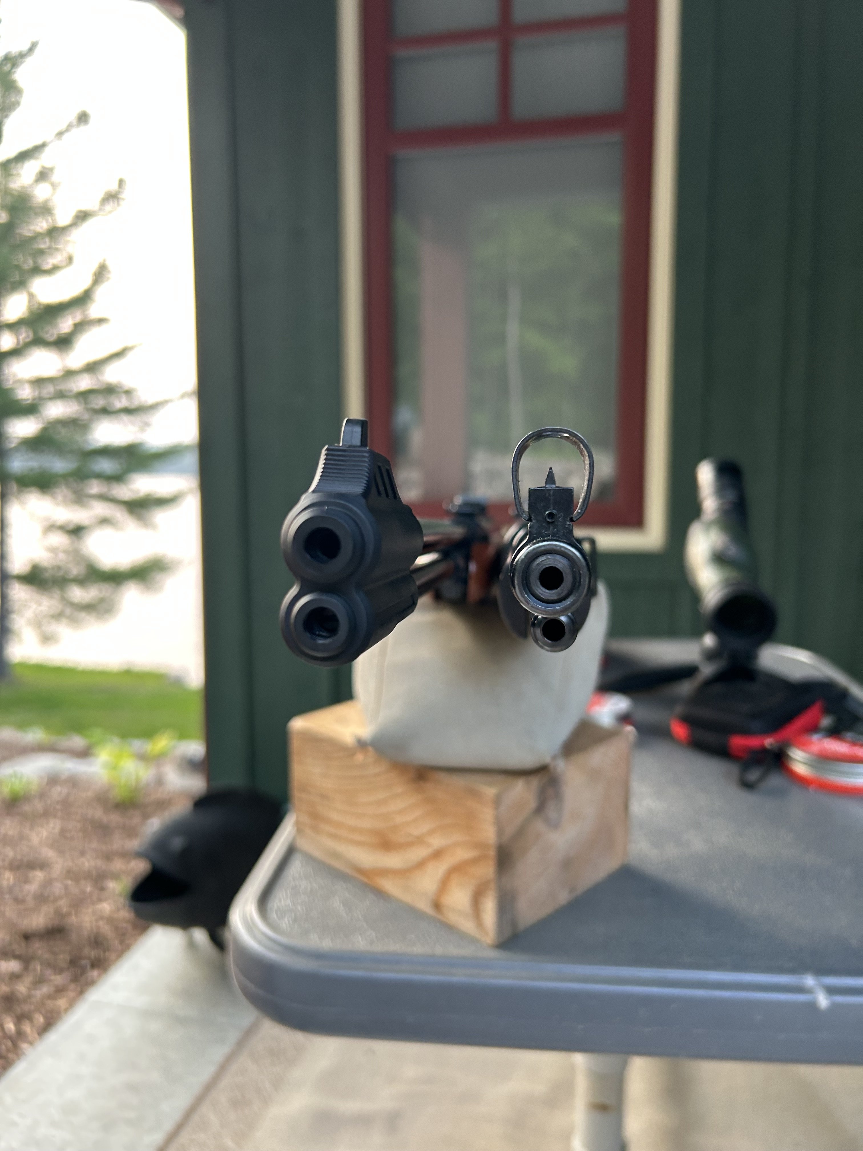

Man these rifles hit hard. Not used to it. One big difference is the sights. I like the 98 hands down on right.
Comparing these two rifles to me doesn’t make sense. I think the 98 has way more metal cast parts vs. the 460 which a strong seller in their line up.

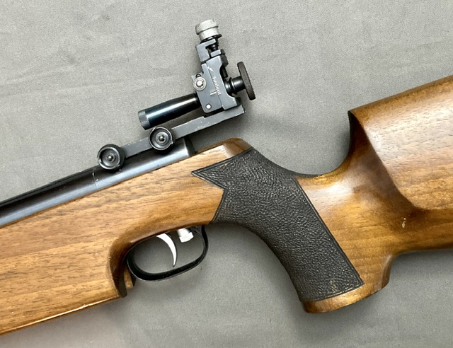

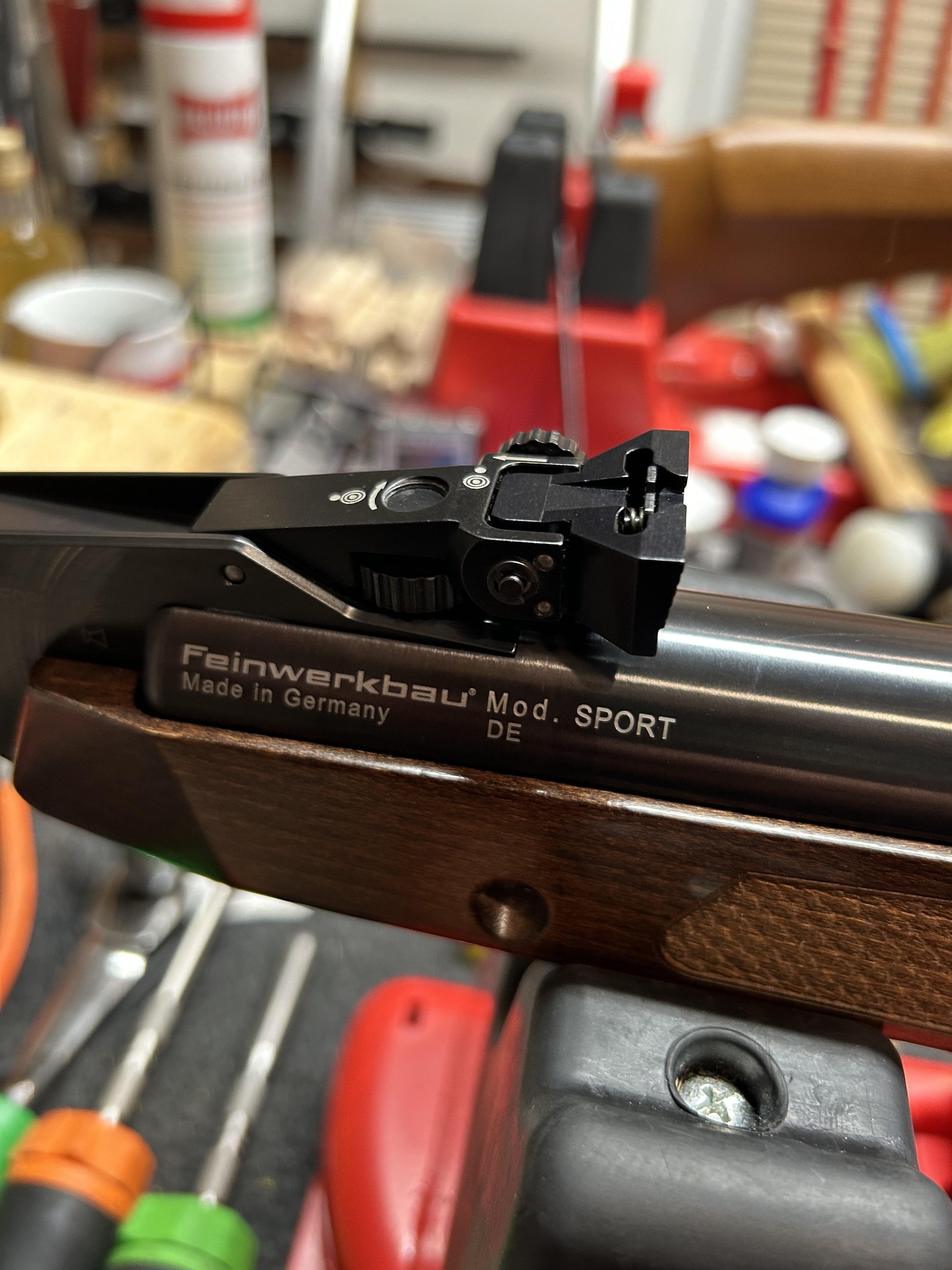

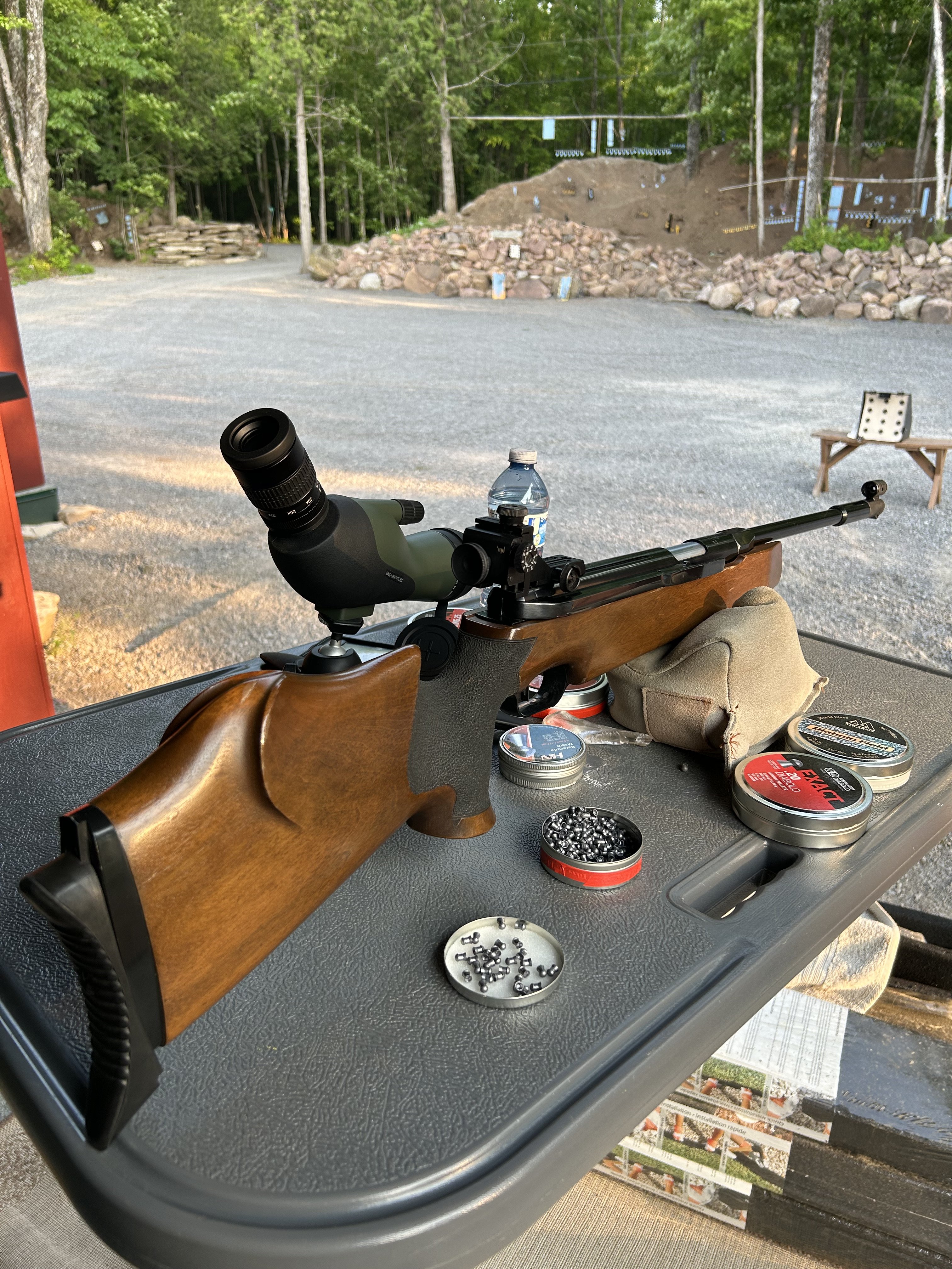

This next rifle is the FWB 124 Sport.
This was the second easiest to aim. No wonder. This gun needs peep sights.
I think with a little time that 300 would never miss. My favorite today. The sport was second but was in the outfield compared to the 300.
I’m going to be on the prowl for these sights for a few other guns.
Impressed on sighting the target with these!

This next rifle is the FWB 124 Sport.View attachment 365181This was the second easiest to aim. No wonder. This gun needs peep sights.
Which sights do you recommend for me to hunt for? Old or new?

I was just looking at that peep on the FWB and that is a peep sight is like one I've never seen before. I've only shot Williams other than M1's etc.

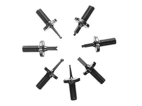

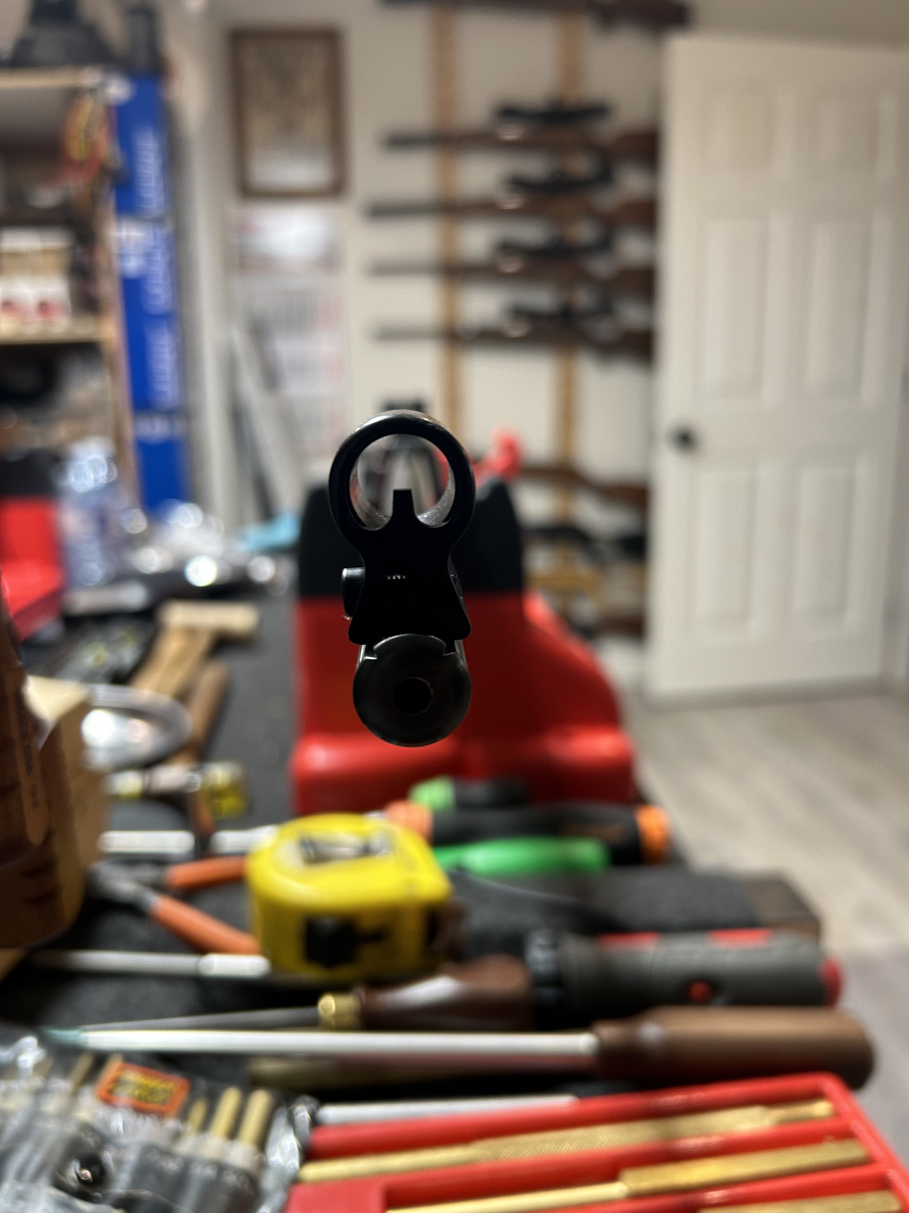

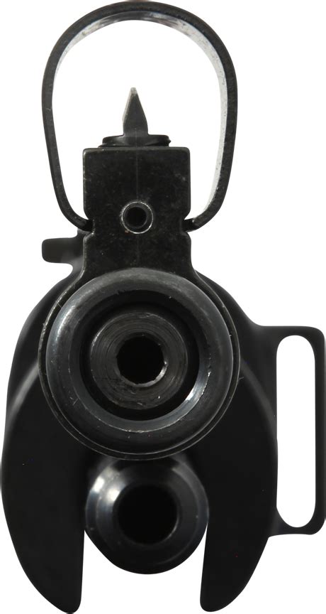

Tried to find the thread and think it was at GTA , but if your 98 has this front sight a guy found a post kit that fit . He was wanting the lolly/ ball post .
As you see the post is removable and can be swapped out . I recall remove the setscrew and maybe unscrew the post ..
Anyway if you could find that thread he showed what was what and worked
View attachment 365313View attachment 365315

I found the sight as is was accurate at 10 meters. At 30 yds. it was a guess, couldn’t see front sight.

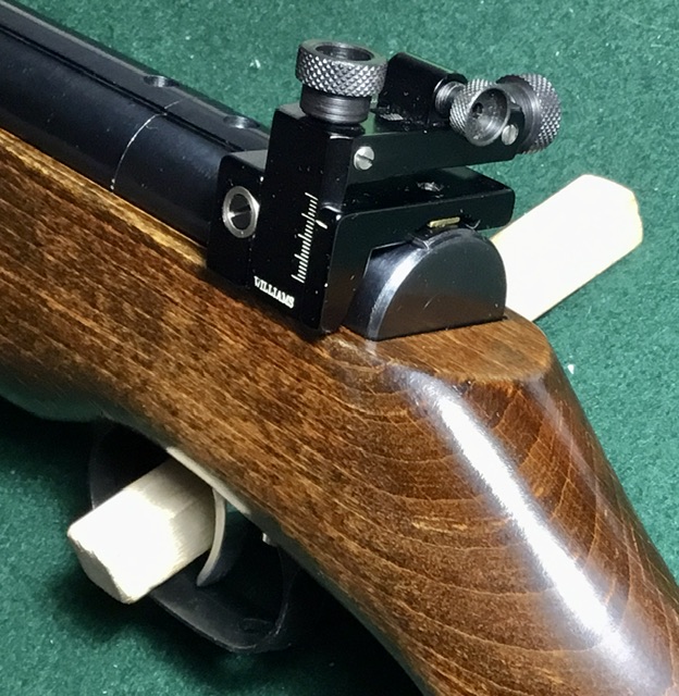

The Williams FP-AG is a good traditional choice for a sporting aperture sight. Its adjustable mounting base will fit any of these dovetails. This is a not truly a match sight, but a lightweight, small peep intended to leave you with a good view of the target area. And still a huge step up from breech-mounted notch sights.

On the FWB sport, I'm not sure what size its dovetail is; on older FWB's it's about 11 1/2 mm. You might see if the sight on your 300S will fit it, but BE CAREFUL doing that. Turn the clamp knob all the way out before taking the sight either on or off, and be sure it's aligned with the transverse grooves in the receiver before tightening it, or you will scratch the gun (The bolt nestles into one of these grooves to keep it from silding).
Old Williams sight on an HW (this is actually not an FP-AG, but looks nearly identical).

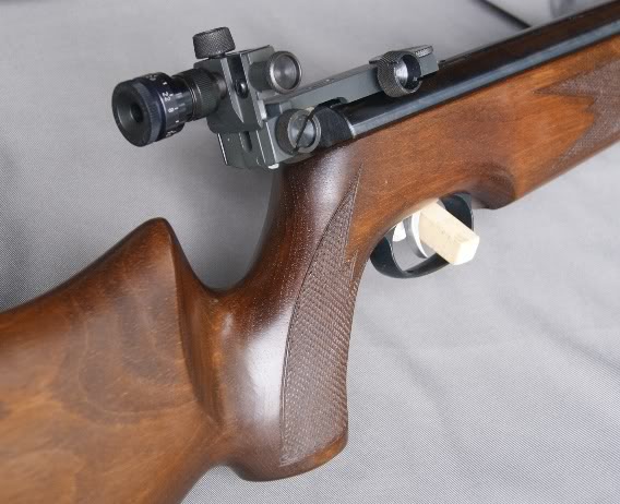

Classic HW diopter. These were made with both 13mm (older) and 11mm (newer) dovetails, be sure you get the latter.

WOW FWB 300 with what looks like ambi Trolean stock ? to bad your a 3 day drive from me 😎
Traditional tyro designs usually have that shallow flat "cheekpiece" on the off side. Not really sure what the idea is, and it's not a true ambidextrous design obviously - but you can usually shoot 'em pretty comfortably wrong-handed, lol.
I tried to find it cause it was pretty goo to know stuff .. could be his post or he added it to another. I just hate i cant find it to backup what i said on that . Figured youd like it being you got the gun ..
Traditional tyro designs usually have that shallow flat "cheekpiece" on the off side. Not a true ambidextrous design, but you can usually shoot 'em pretty comfortably wrong-handed, lol.
