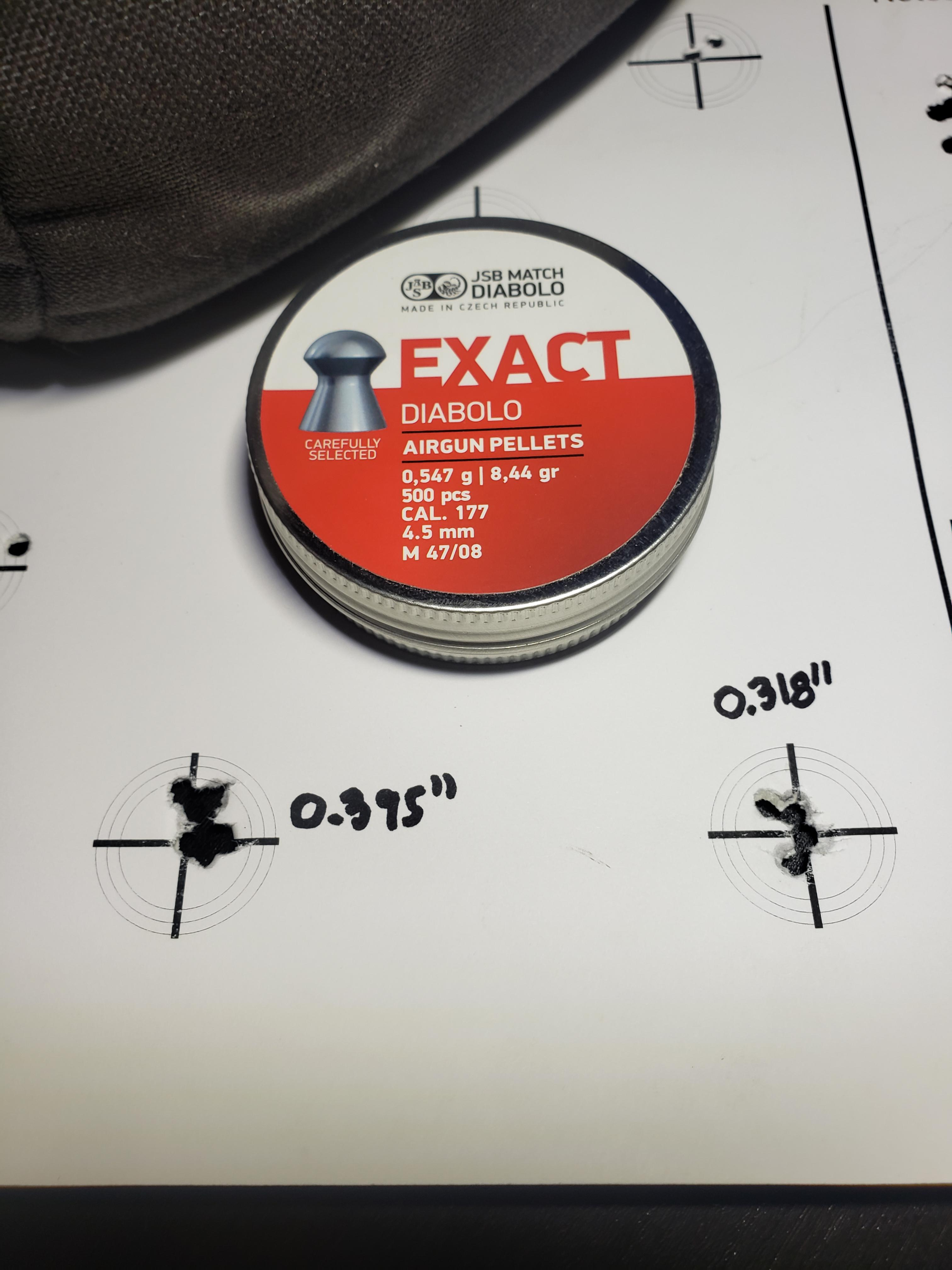

Picture #2 includes two seperate 10x shot groups. The group on the left is just 10 pellets pulled at random from the tin and sent down range. The group measured 0.395" CTC.
The group on the right is with 10 pellets pulled from the tin but each skirt was examined for any defects. If none were found, they were sent towards the target. That group measured 0.318". Pretty solid improvement if you ask me.

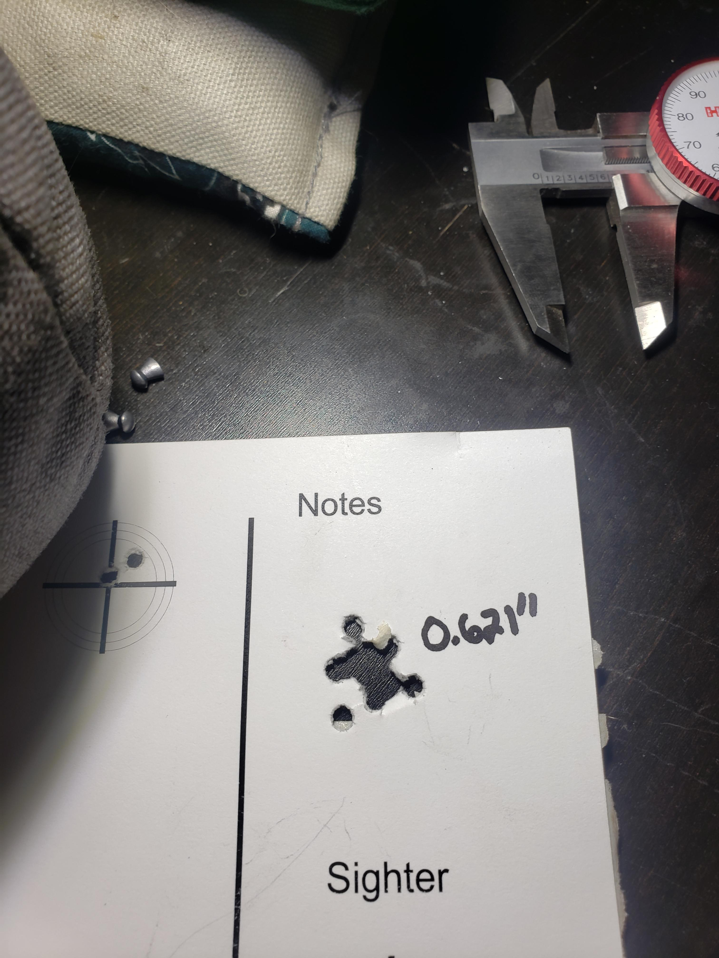

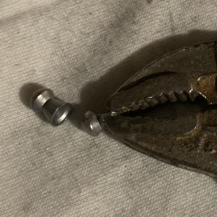

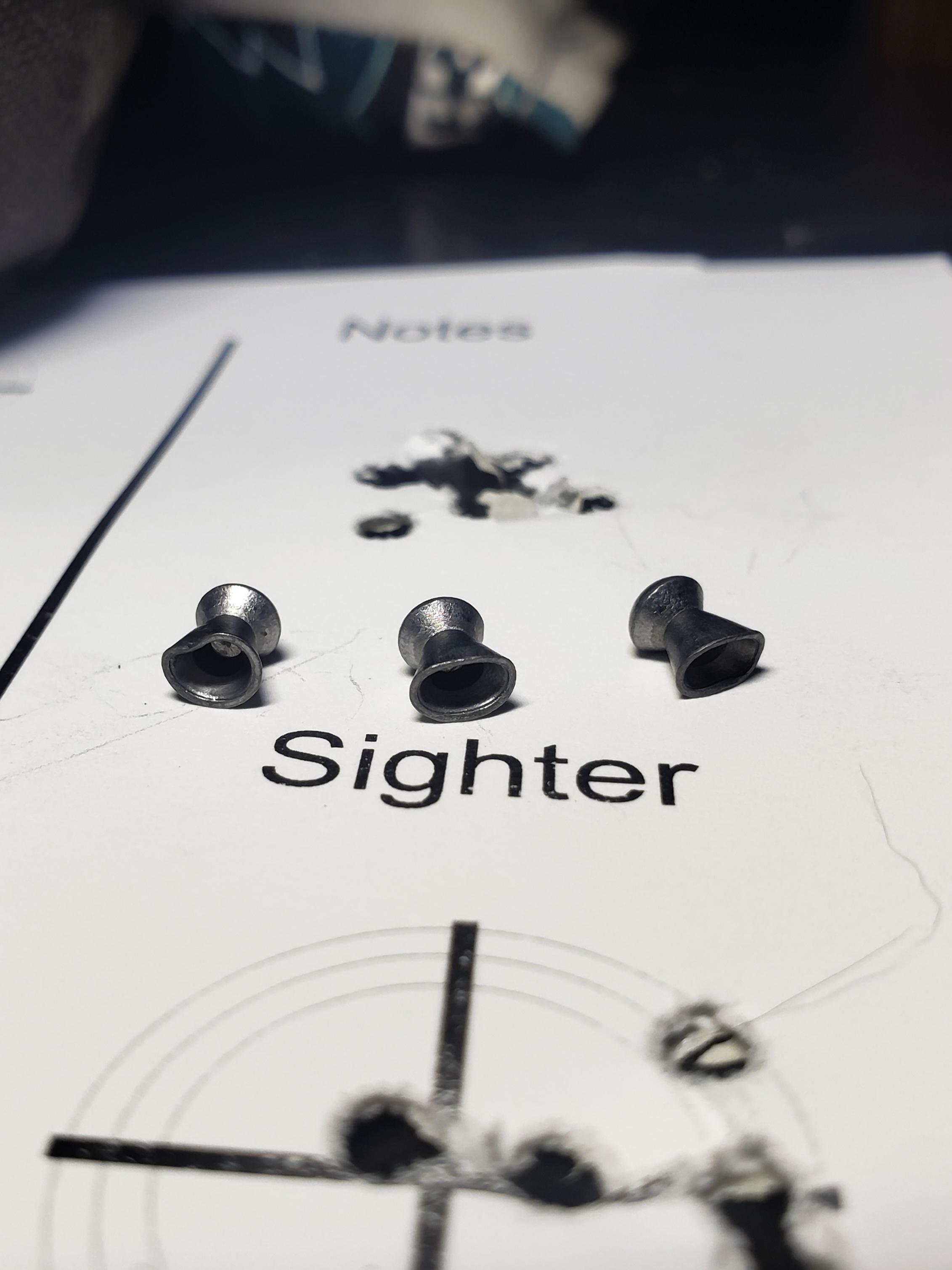

Here is where it gets interesting for me though. Picture #3 was 10 shots with more than just a little skirt damage. You can get a rough idea of what these pellets looked like from the first picture. One of these pellets had both sides of the skirt literally touching in the center. I was expecting an 1.5"+ from this group. What I got was 0.621".... I can live with that any day of the week.
I guess the moral of the story is, don't waste "bad" pellets. I wouldn't use them for hunting or in a match scenario; but for plinking? All day.
