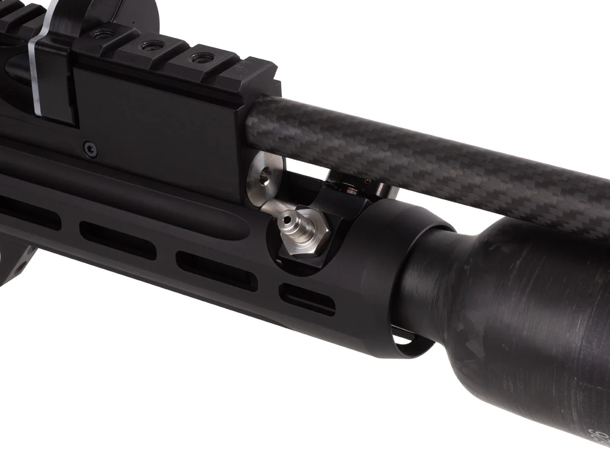

RAW Rapid To to replace spring in gauge block? Micro Hunter?
That's the valve spring for the quick fill .Goes in the hole underneath the quick fill fitting...the silver piece in photo.When you unscrewed the bottle it fell from there.
That's the valve spring for the quick fill .Goes in the hole underneath the quick fill fitting...the silver piece in photo.When you unscrewed the bottle it fell from there.View attachment 491211
THANKS MUCH ! Once I put that back I hope my Micro takes air. I told the tank off when RAW told me (when my Micro was not taking air (yes it was cocked), after I degassed it. RAW told me to take tank off and put it back. I'll do when you suggest in AM and let you know. I REALLY appreciate your help and LOVE my Micro. Now I want a Mini in .22 and am looking for a) someone that has it in stock and b) a good price. Incredible company (I watched the factory tour on YouTube) but they can't seem to get it "together" on their name. "Rapid Air Worx" or Rapid Airguns or where they are, some websites say TX and others say TN. Anyway, in my opinion, incredible product but I wish it had a reg gauge and exterior adjustable reg. I see HUMA make a reg for it. Anyone know if it's "better" than the RAW factory reg? I'm used to a SD of 1 or 2 FPS with Huma and AMP but my RAW gets 3 to 10 FPS SD. Fatory tuned, I changed nothing and use 15.89gn JSB pellets. Does their reg need to be "broken in", if there is such a thing?
