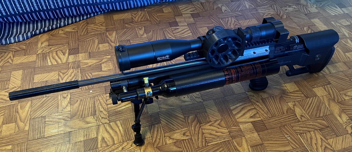

The OEM bottle on my Prophet was 500cc I installed the 700cc bottle added the 2inch to the shroud, Didn't need to, just did it, No speed increase but it did muff the sound a little more, Just installed my Tanto LDC . Bench pesting shooting, I do pick it up and walk around the yard when I have to take a crazy shot at a sparrow of something, It really shoulders good and its not really heavy. I have most of my sparrow feed stations around and within 48 yards of my shooting table.

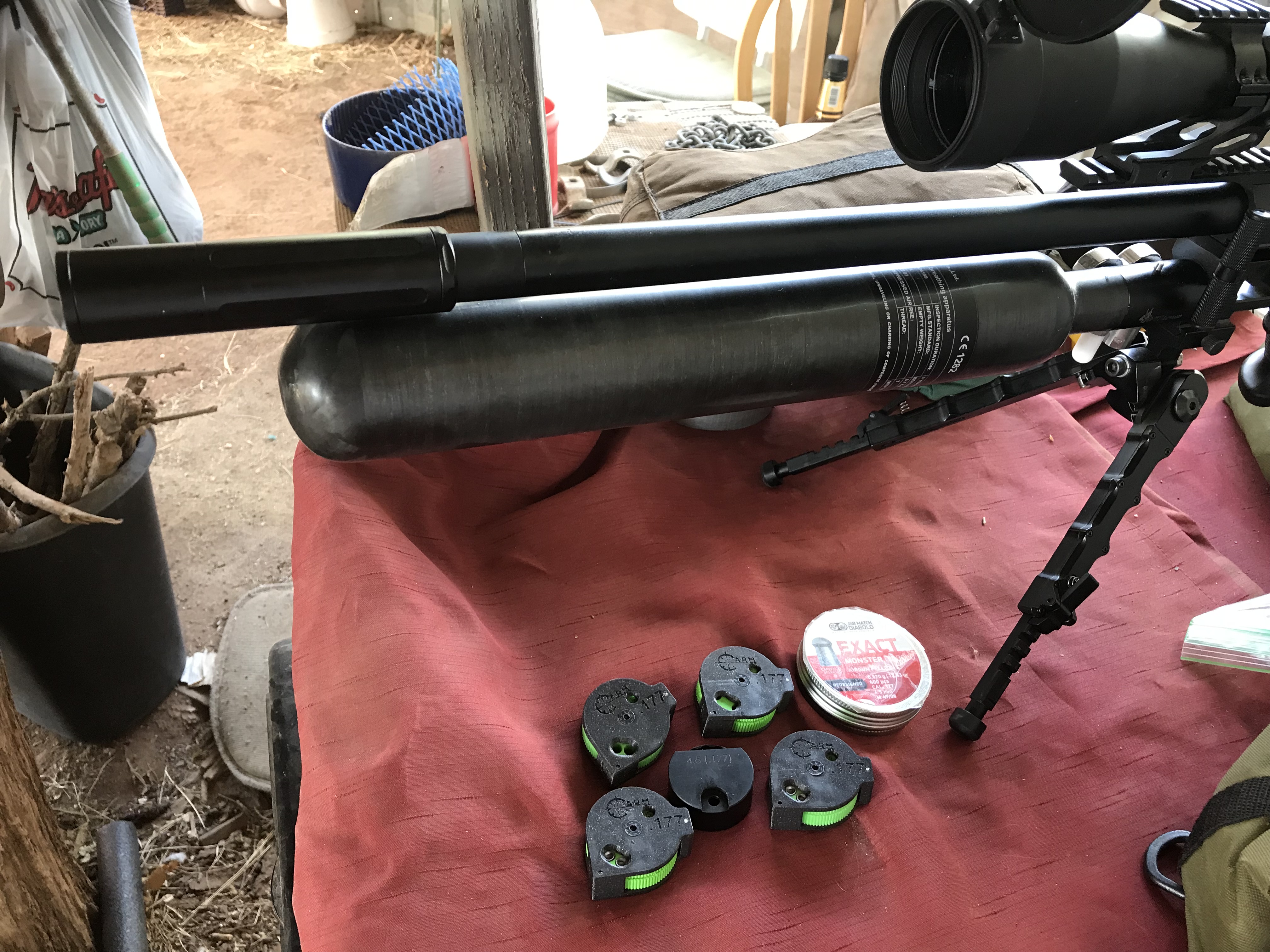

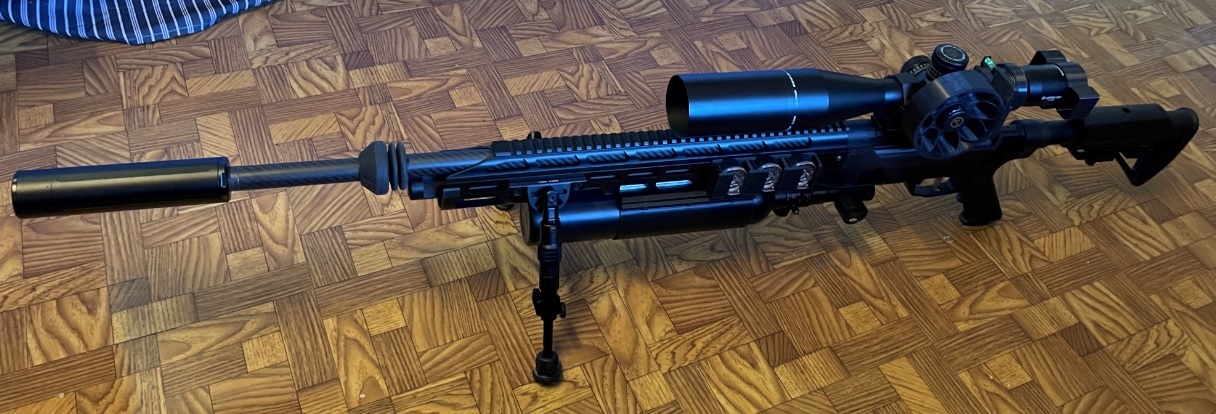

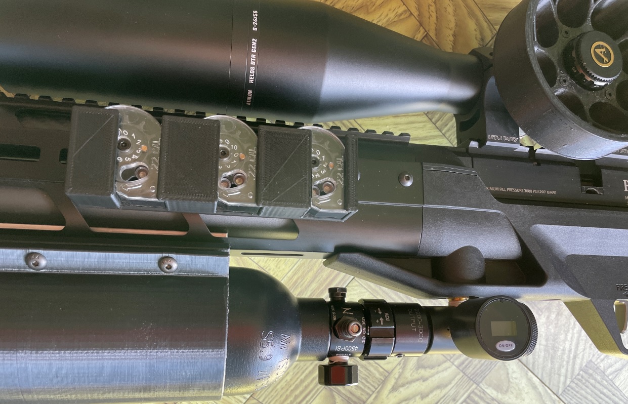

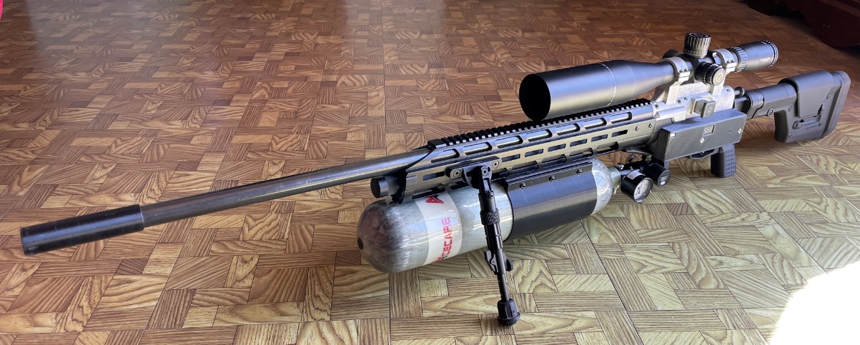

I've done a few tube to bottle conversions without using a Bottle-Step-Down Adapter:
.22 Bulboss with 390cc? bottle slung on the side of the bullpup stock, with a threaded fill probe as the air connection:
.22 Armada with 450cc bottle slung underneath with a union fitting for the air connection through the original gauge port:
.257 Armada with 2000cc bottle slung underneath with a foster connection for the air fitting:
"...if I had a .30cal, I'd love to attach a 1 liter bottle so I won't have to count shots but just blast away..."
The .257 slug gun with the 2 liter bottle gets 80 shots at over 150fpe on a full fill. It's great for blasting away from the bench (or prone). It's currently torn down for a re-barrel to shoot 7mm caliber slugs. Goal is 40shots at about 250fpe.

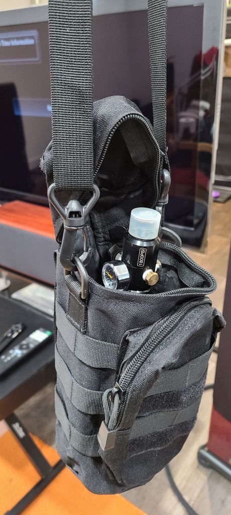

Before I jumped into PCP I used a 1 Liter paintball tank tethered to an unregulated rifle. I changed the valve/regulator on the tank (I guess to 1800 psi, but I collected several from aliexpress and finally ended up arranging the washers myself to my needs).
Just wondering what you feel more comfortable dragging around "walking out in nowhere", adding a 1 Kg to your airgun or putting that 1 Kg in a sling bag or around your waist? Old picture one of my bags but just to show what I meant. Also that 1800 psi (or your custom washers) acts as a pre-Reg to the Reg.
