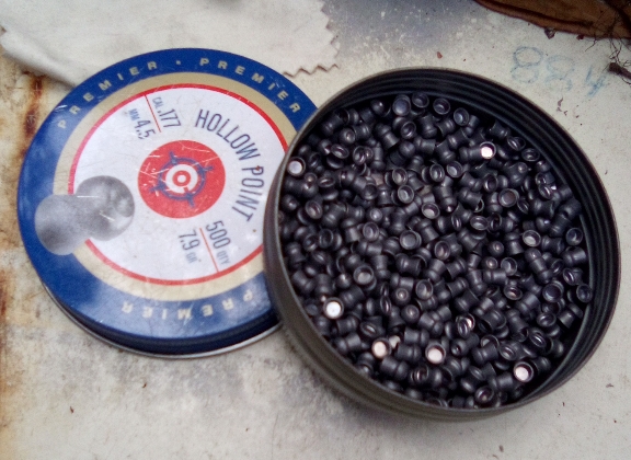

@Hateful McNasty gets some great performance from the pellets he conditions prior to shooting.
A fine tin of Walmart cphp. 177 ready for action .
