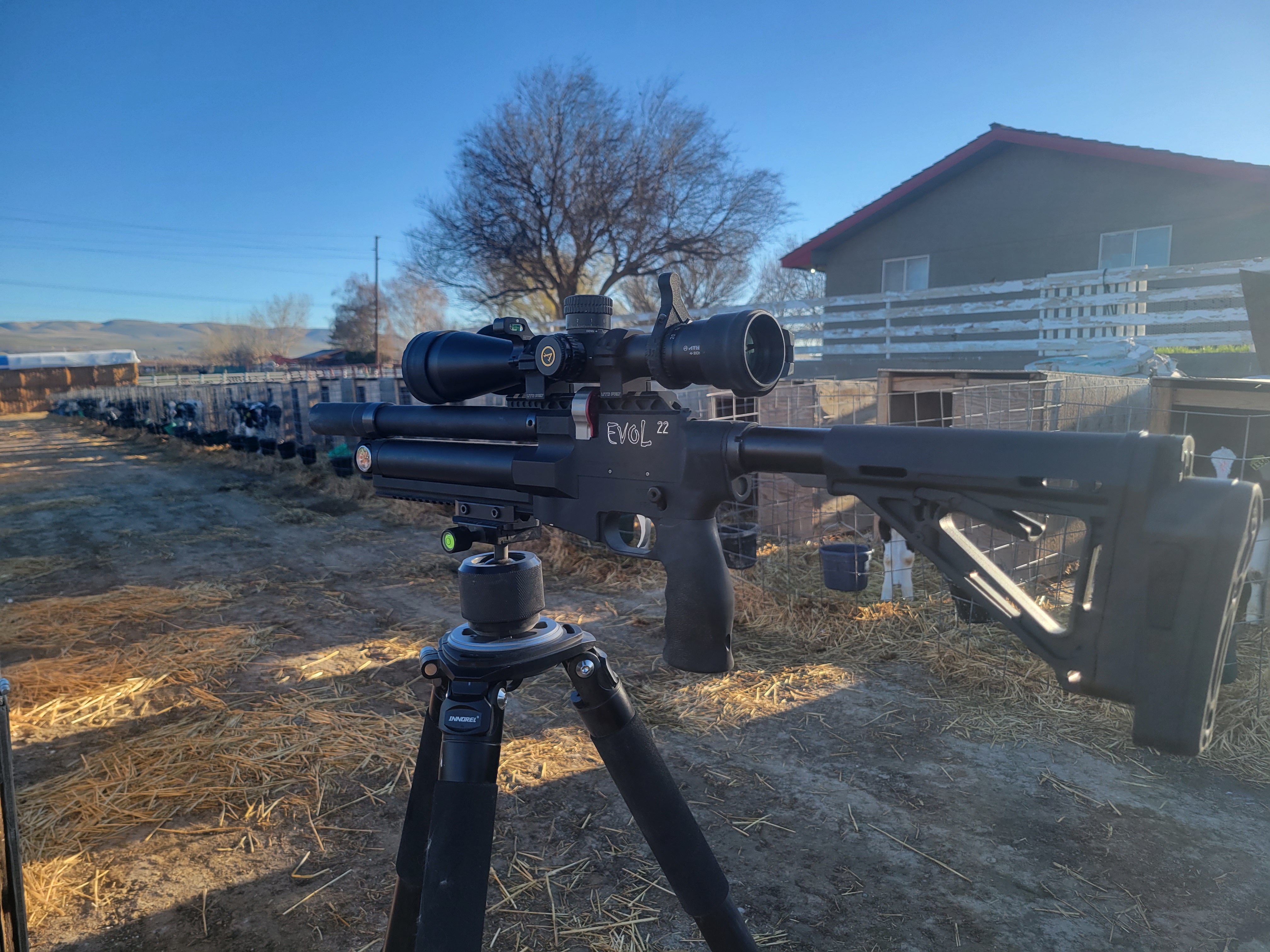

Yes, a TP adjuster like on the Brococks would increase the Evol’s versatility…I'm at 900fps with the 16gr FX pellets. Shoots the CPHPs very very well also. I don't always use the full fill. I like 250bar. I'll check tomorrow to see what I get exactly. But yeah such a fantastic gun around the farm. If it only had a TP adjuster for lower power needs it would be the ultimate all around gun for me.its got 95% of my needs covered just that would get it to 100%.
Yup I agree 100%Yes, a TP adjuster like on the Brococks would increase the Evol’s versatility…
@Dairyboy how do you like the 0 degree grip on your evol, I just put one on my panthera build and love it, pretty sure I will be putting one on my mini now.Welcome to the club! It would be hard for me to purchase another brand honestly. Just top of the line and can these little guns SHOOT! Have zero issue shooting this gun out past 100yds if wind is calm. Has never let me down. Just one of those guns you know will hit where your aiming. Cheap? Absolutely not but all the money wasted trying others and selling I could have had 4 of these lol
I love them! Ever since I tried one with a 0 degree grip I can't go back to an angled grip. Feels so much better. Did the same thing with a .22lr build bought a KRG Bravo stock to have a zero angle grip@Dairyboy how do you like the 0 degree grip on your evol, I just put one on my panthera build and love it, pretty sure I will be putting one on my mini now.
