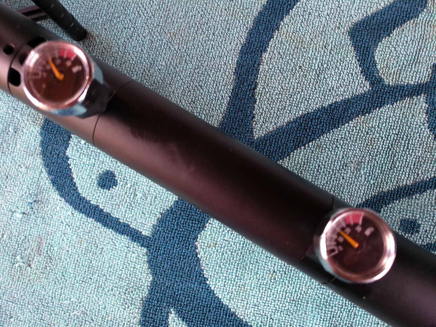

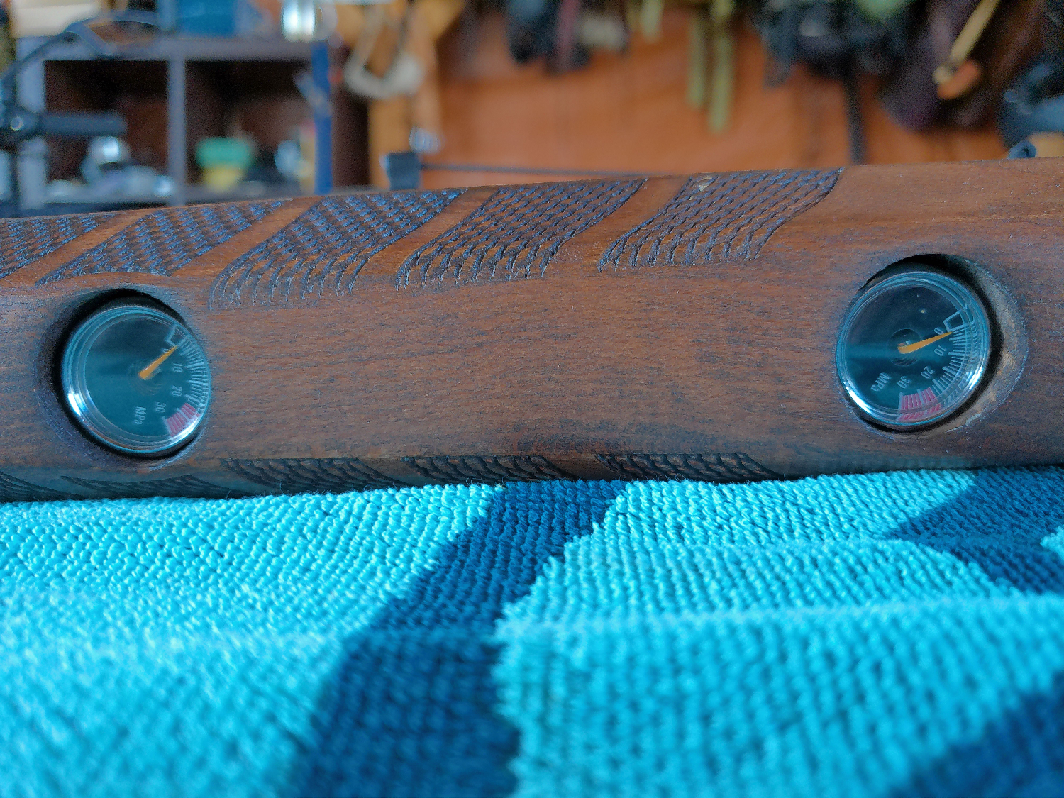

About a month ago I noticed that the regulatore pressure matched the tube pressure, also the gun leaked to 0 in the past 2 weeks or so.

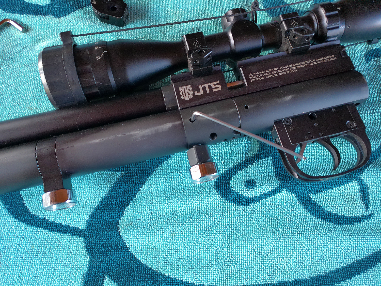

At it again today,
of course I have zero clue what I am doing and since no one gave me any tips on regulators I just went in and winged it :ROFLMAO:

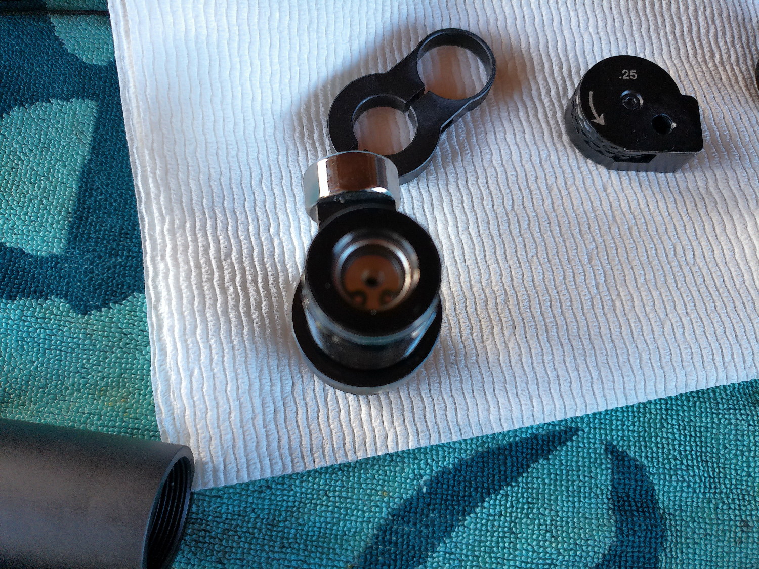

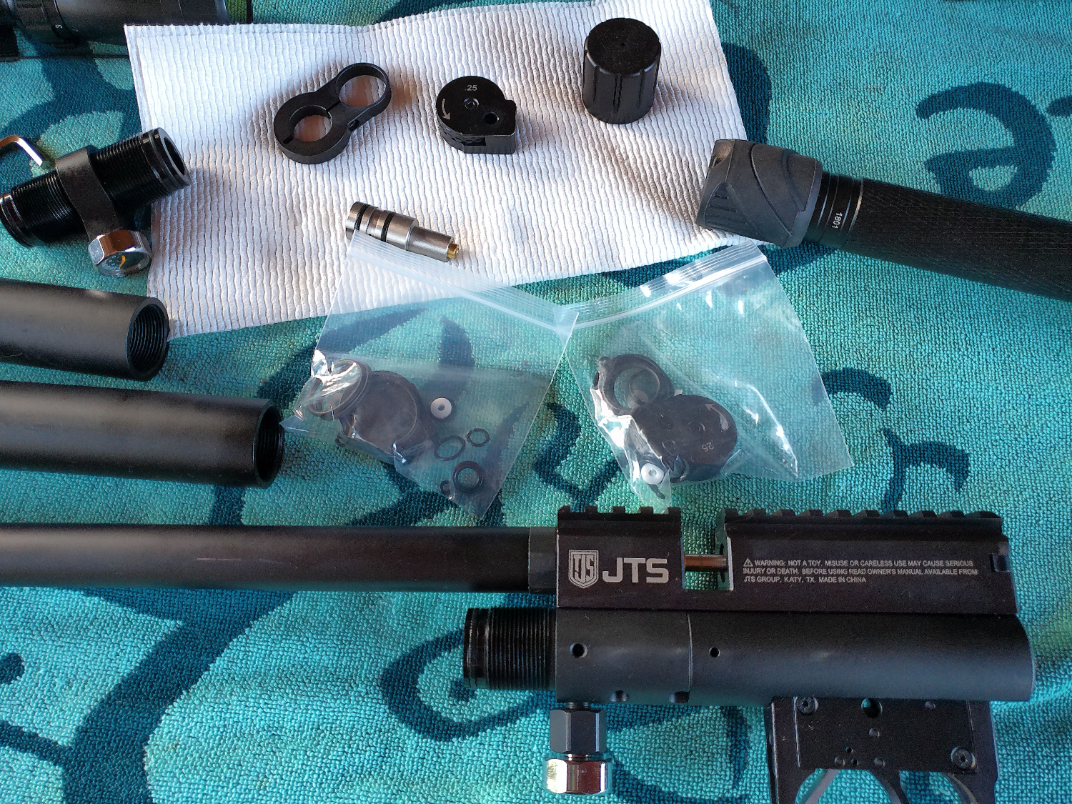

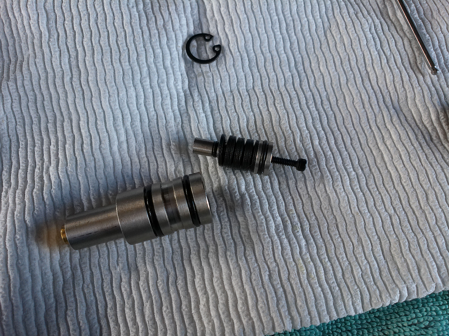

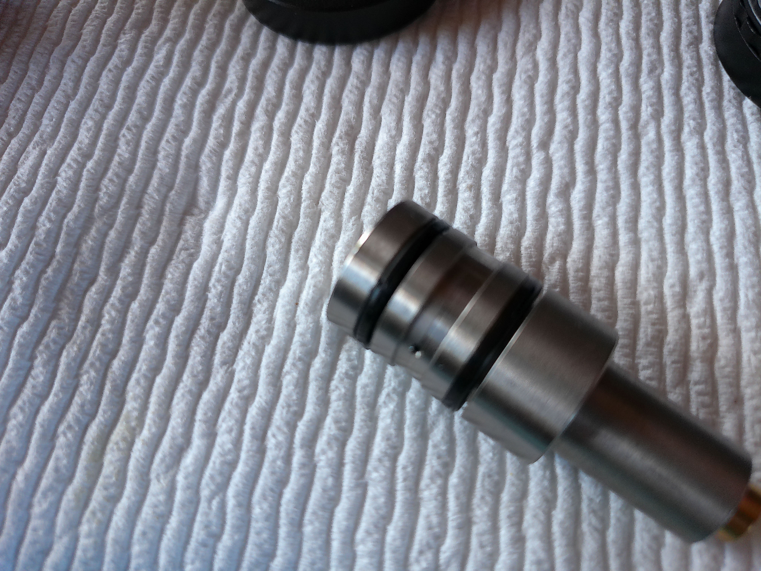

opened the regulator and of course half them washer just went flying :rolleyes: put them back how i figured they should go but I have no Idea, then I just could not figure out what else to do but grease the rings
Put it back together and the gun too, aired it up and of course the regulator gauge is the same as the airtube gauge again :ROFLMAO:

Not familiar with this reg but I bet there’s an inner o ring inside the main body that you missed, or like the impact one inside the tunnel that the regulator went into.
When fill pressure becomes equal to reg pressure that is most of the time a failed o ring that’s a part of the reg, or the regulator seat itself got crushed and now won’t seal.
When you turned the adjustment screw CW to close did you come to a soft stop?

Have you tried to search for a diagram of the bellville washer stack pattern in that regulator? I’ve only messed with taking apart one regulator and I’m unsure if the pattern of the washers differs from regulator to regulator.
As Scott said, that is a symptom of the O-ring on the adjuster.
