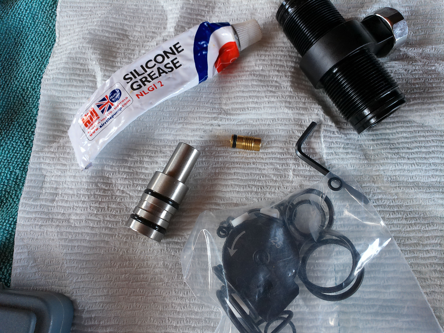

A Reg has an inner spool and it sealed via o-rings to the differing diameters within housing. Air pass's threw the middle of spool getting from HP side to LP side. Spool HAS TOO stay in place or air leaves threw the vent.
If wanting to BYPASS a reg ... Simply REMOVE the adjustment screw or omit the oring that seals it ( Your current issue BTW )

The gun came with a bag full of spare O-rings so I should be covered there,...would like to have a picture or diagram ....or even explanation of the staking of them washers
I don’t have the gun but if Motorhead says it can be fixed and the reg is not a flawed design and can be fixed with just some quality orings, fix it.

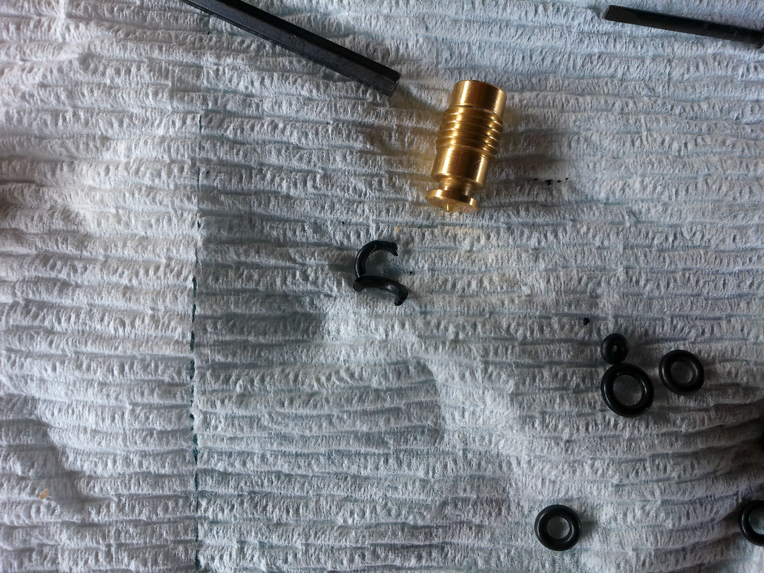

The O-ring in the brass thinghy literally cracked in little peaces then in half as I was trying remove it
Yup ... Their my friend is your issue, Tho REPLACE ALL the o-rings inside and out while your there.
Tho do understand the QUALITY of the orings that are hardening / cracking are the SAME as in the replacement pack sent with rifle.
Until such time as you source some better orings for EVERY connection within rifle the issues will continue.

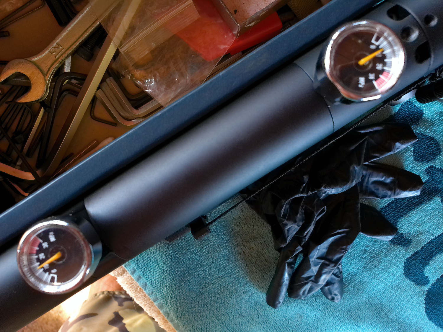

DANG !!!!!! looks like it worked, not thanks to me tho :ROFLMAO: ....thanks to Scott that actually took the time to explain in simple terms to an Idiot like me ;)
Filled the gun to 125 BAR and looks like the regulator sitting at 75-80 BAR,....now just need to go in and try set it around 120-130 BAR and I will be golden.
Thanks again to everyone that took the time to try explain to a dummy like me
