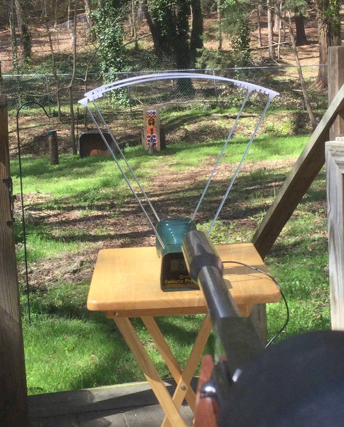

By understanding the operating principle of a conventional chronograph, you can adapt as needed. Light from above casts a shadow from the pellet onto the sensors. Being too close can potentially cause the muzzle blast (water vapor from rapidly expanding and cooling air) to occlude the shadow. Shooting too high may potentially produce such a diffuse shadow that it will not be reliably picked up by the sensors.
Thanks that's a great explanation (y)
