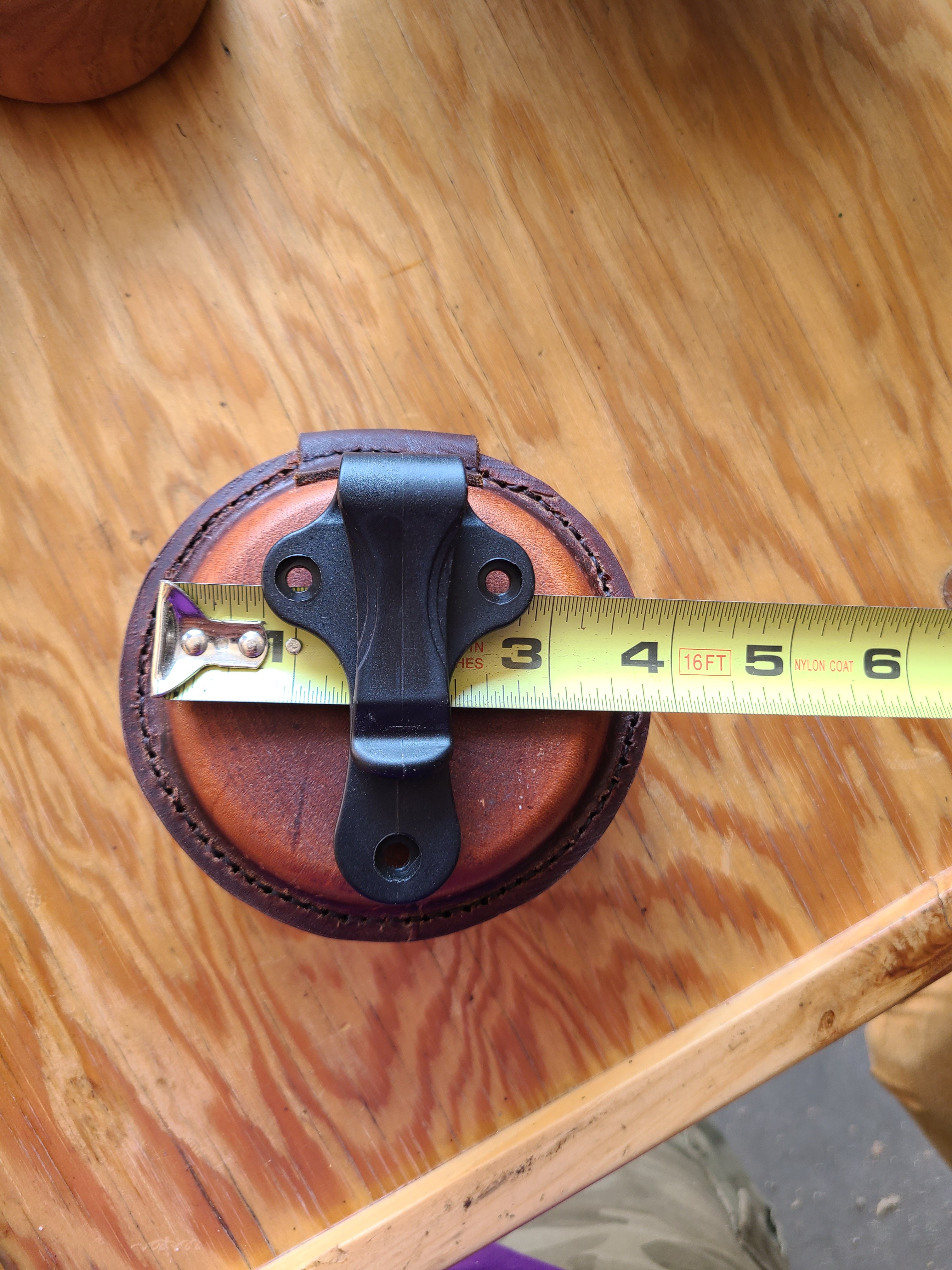

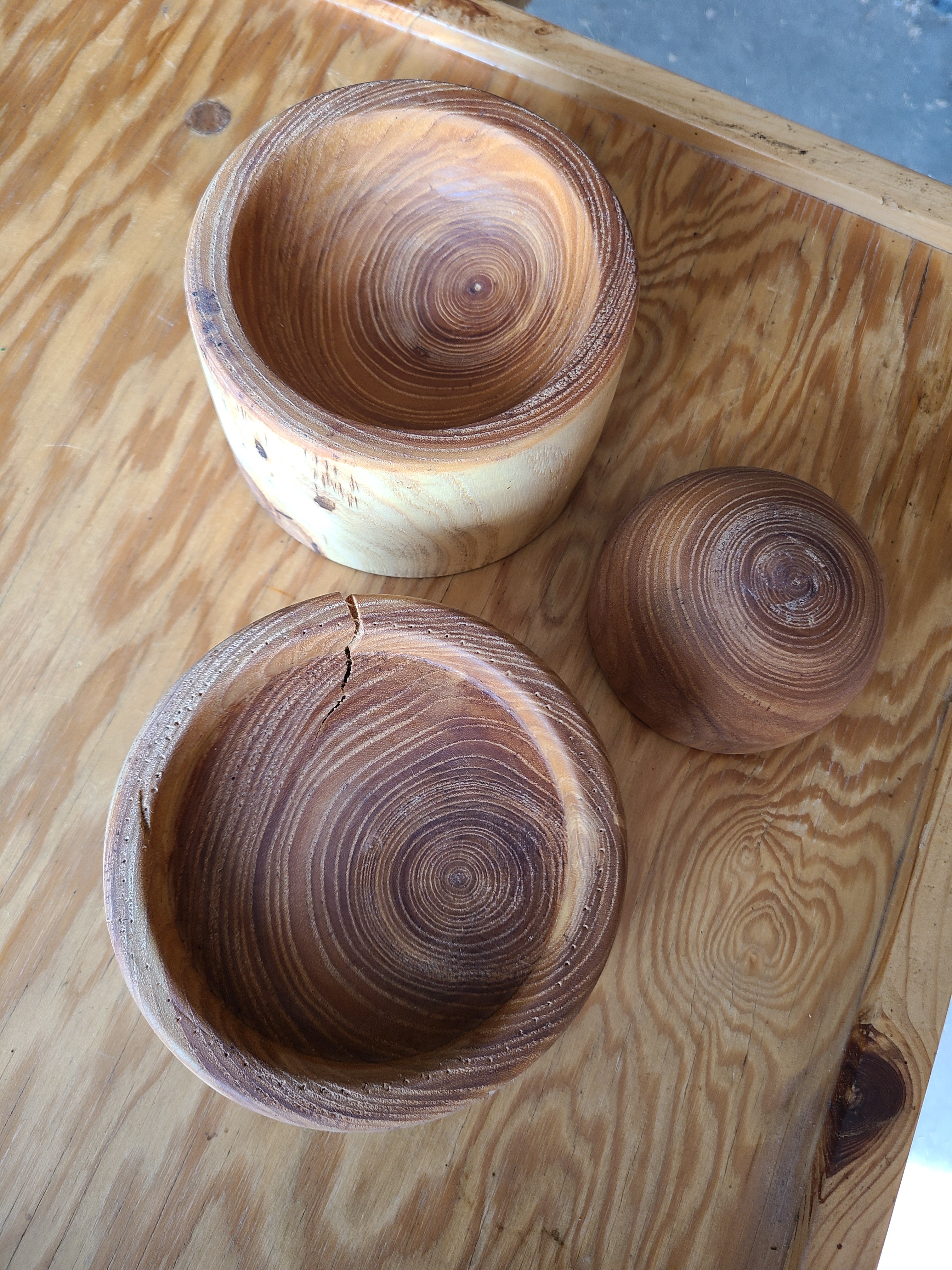

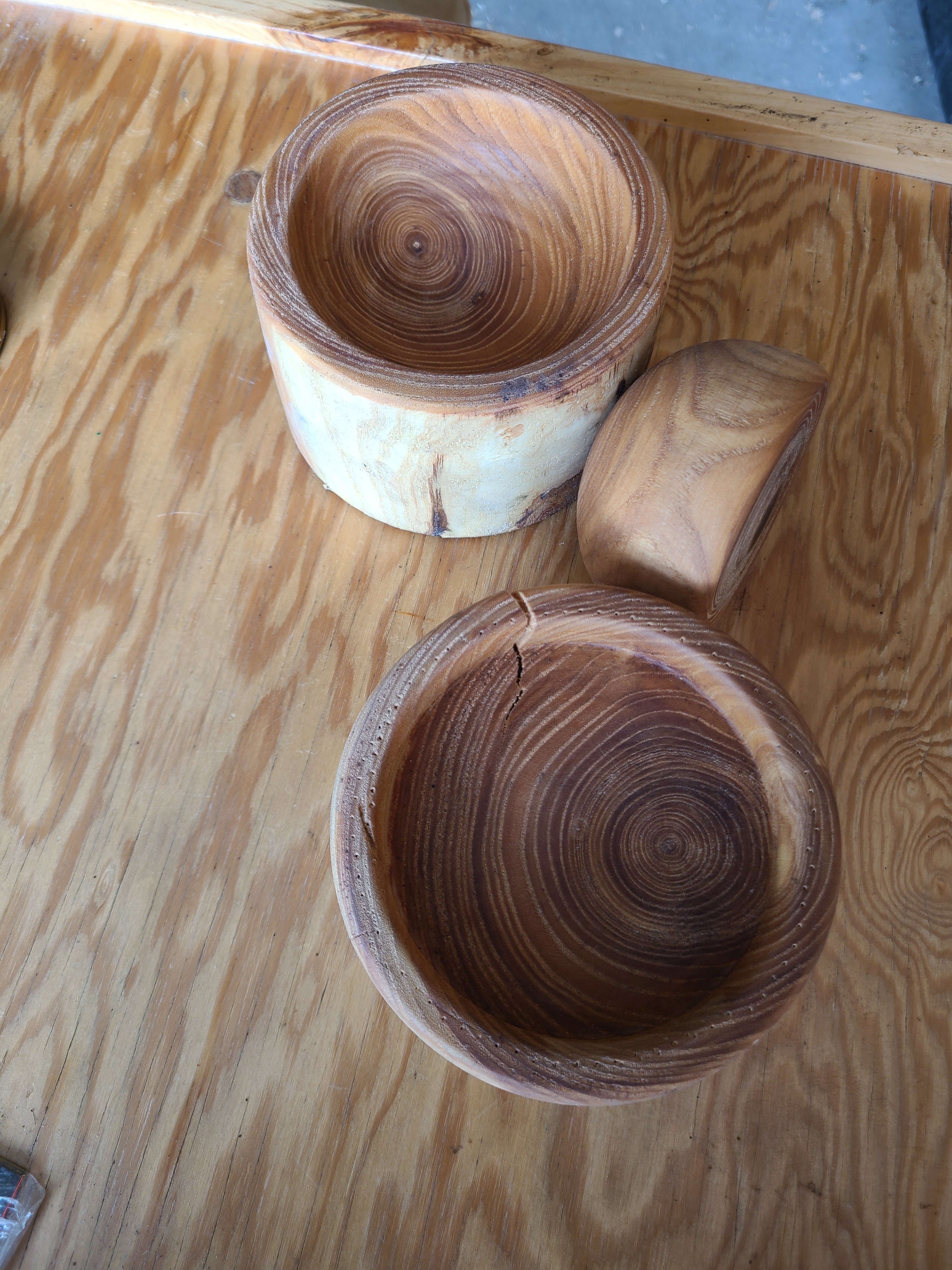

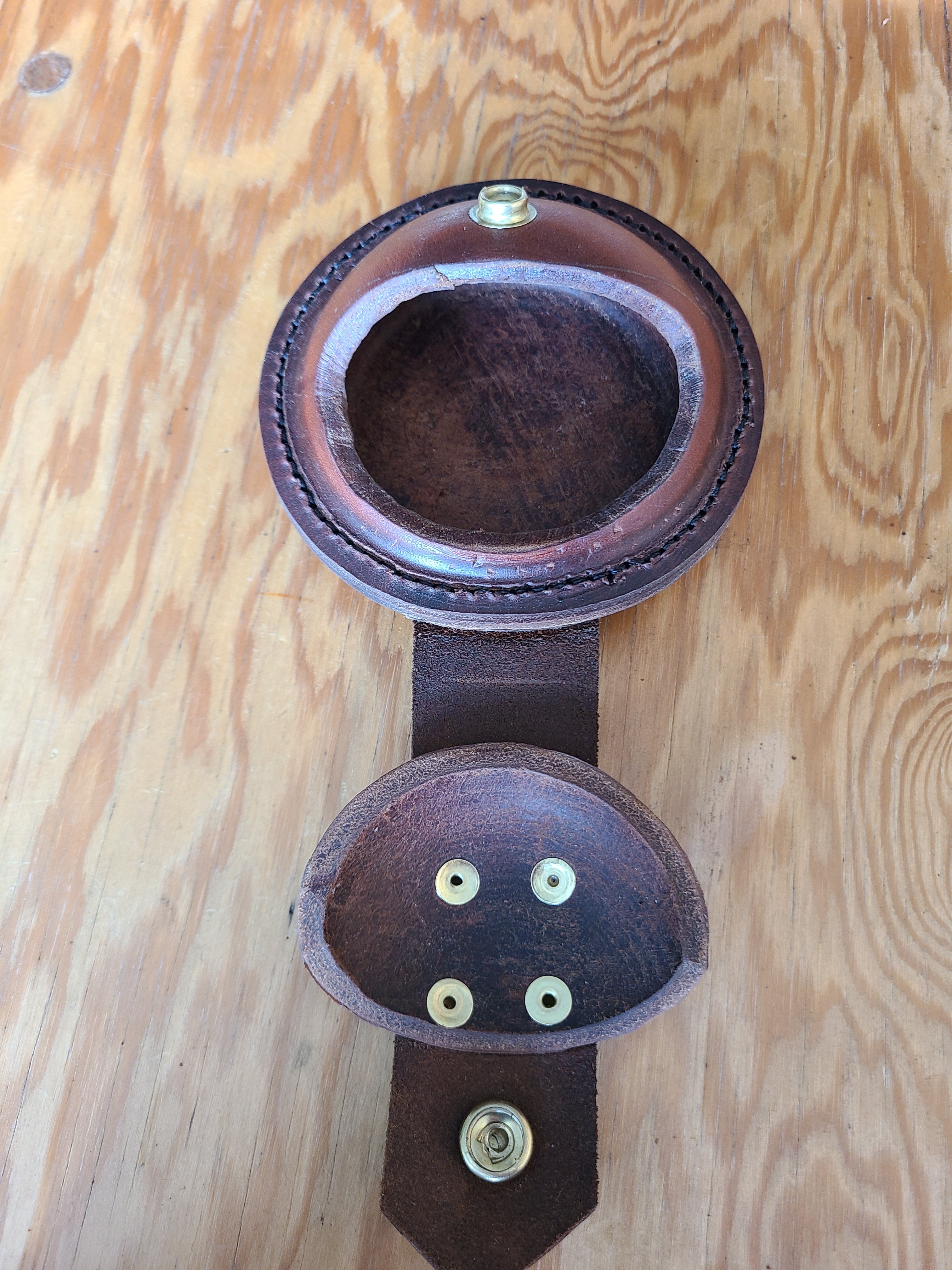

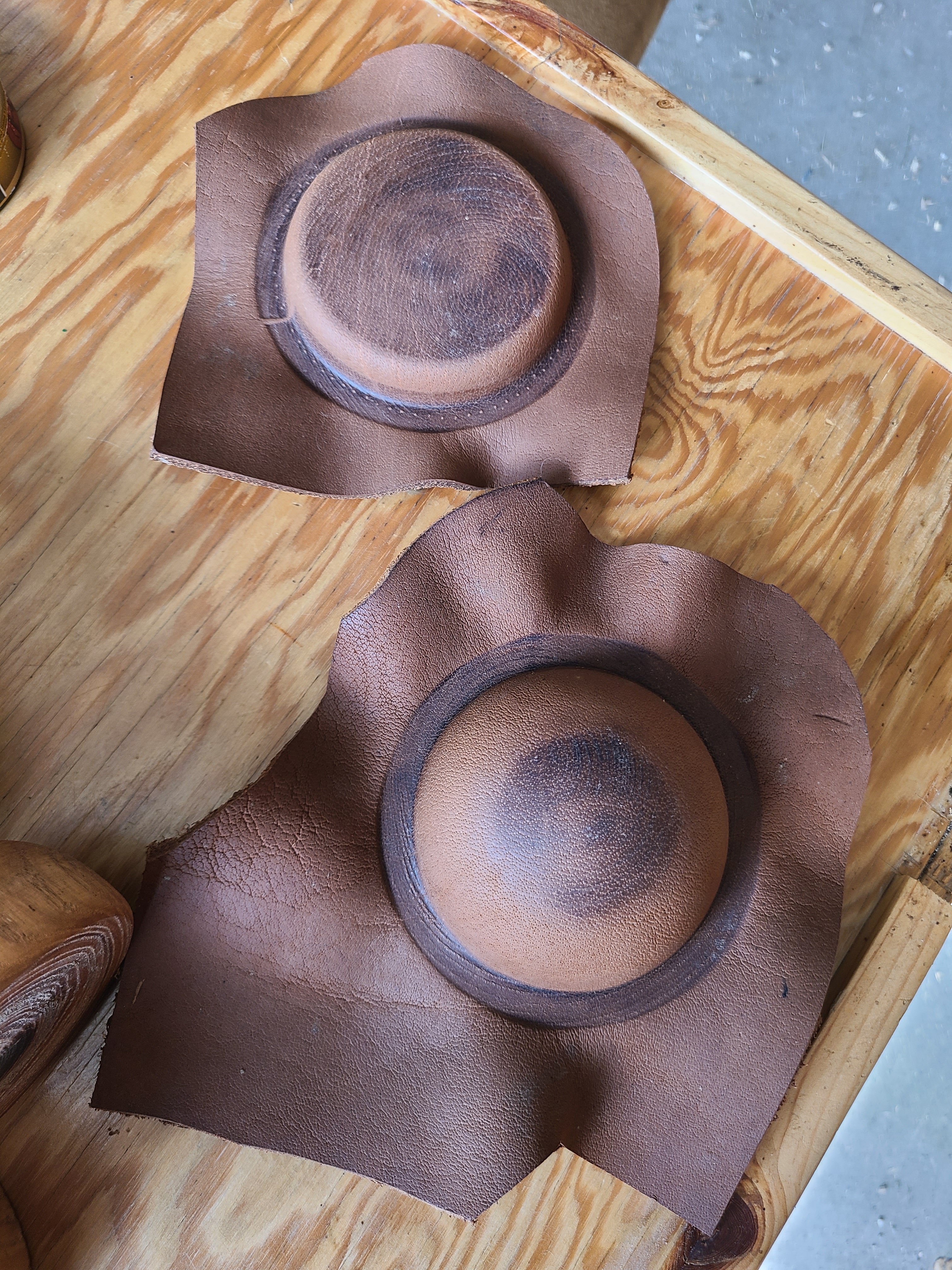

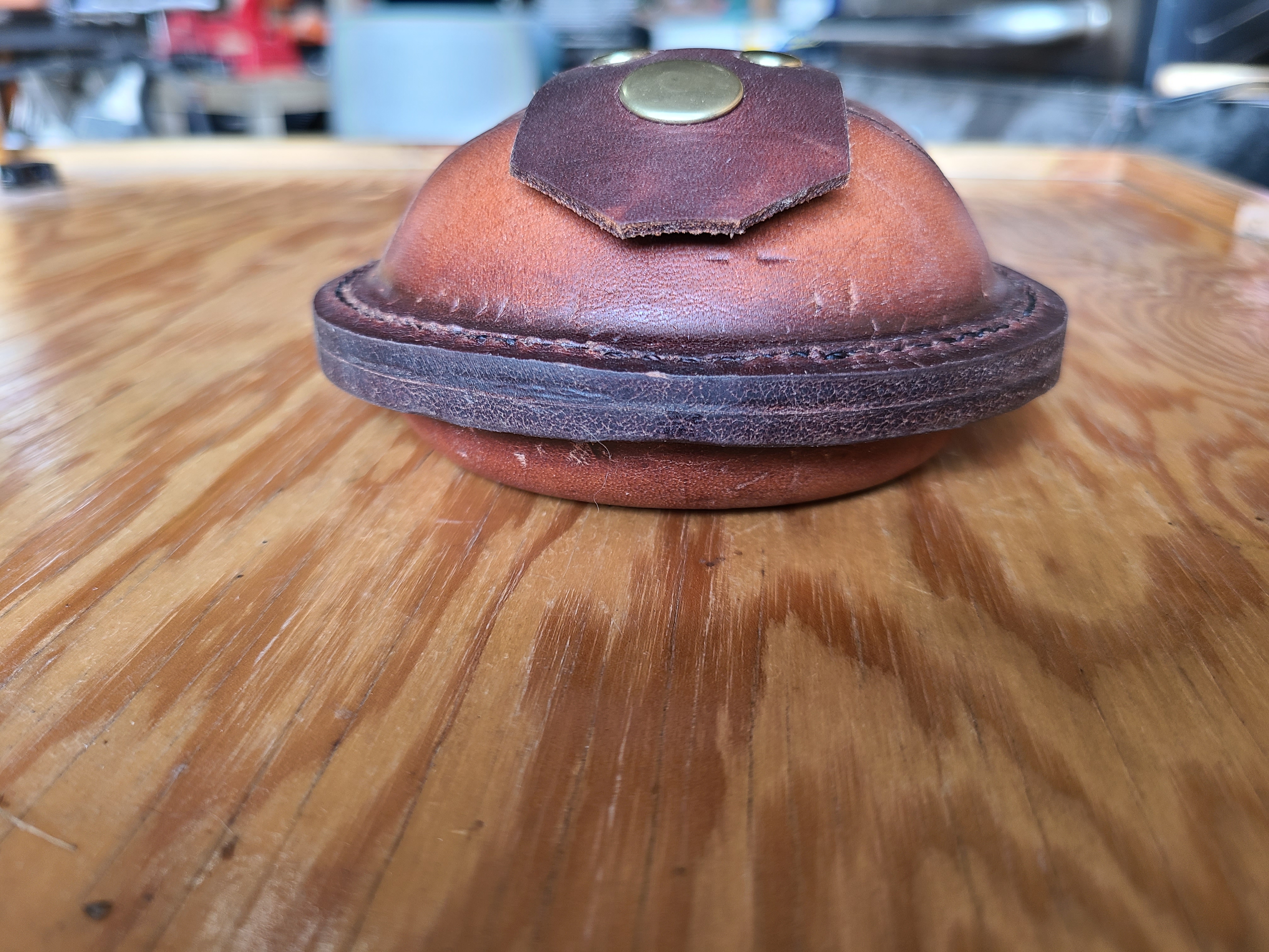

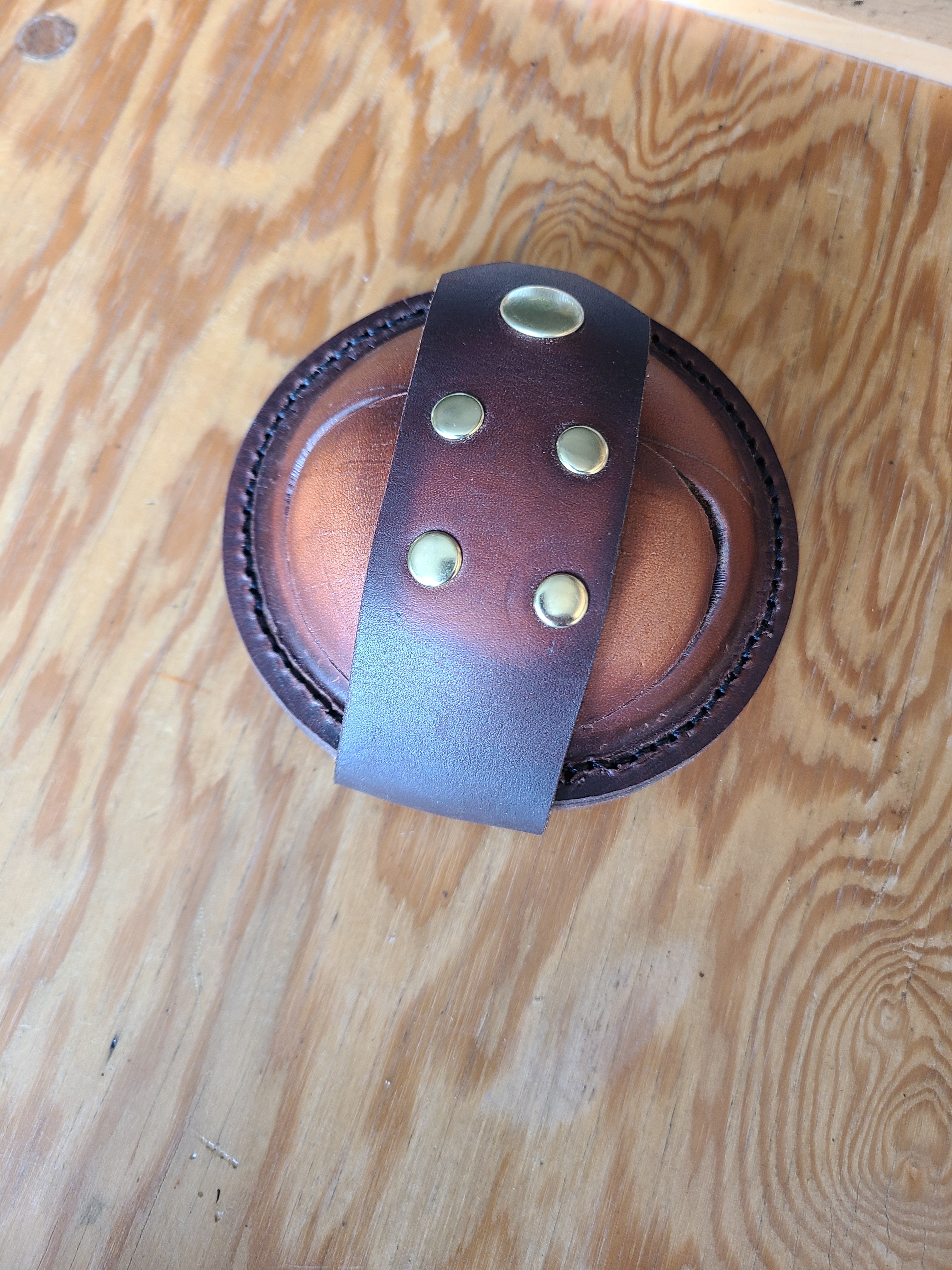

While reading fourms here i came across a thread on pellet holders. Ive been useing a chew can lol. One stood out as neat, a leather clamshell style. So I fires up the chainsaw to go get a log to make the forms. After i have said log fire up the turning lathe make the molds. Then get some leather scraps leftover from gun and knife holster making and press in form. Next stitch install rivits and snaps finish with my beeswax mixture used for sealing my handmade long bow. All in all it turned out decent... time for number 2 lol. I think the forms turned out better than the pellet holder other than the crack in one. So because of a new airgun hobby ive gotten to use several hobbies just so my pellets have a better home till i launch them at something.

nice
Those are nice, great work!

Somethink like this but i wanted mine to sit on a table so the bottom is flat
I was thinking of leather folded over but that is a lot nicer. Where did you find that clip ? I did leather craft in high school but that was over 54 years ago lol. Nice job sir 👍 👍

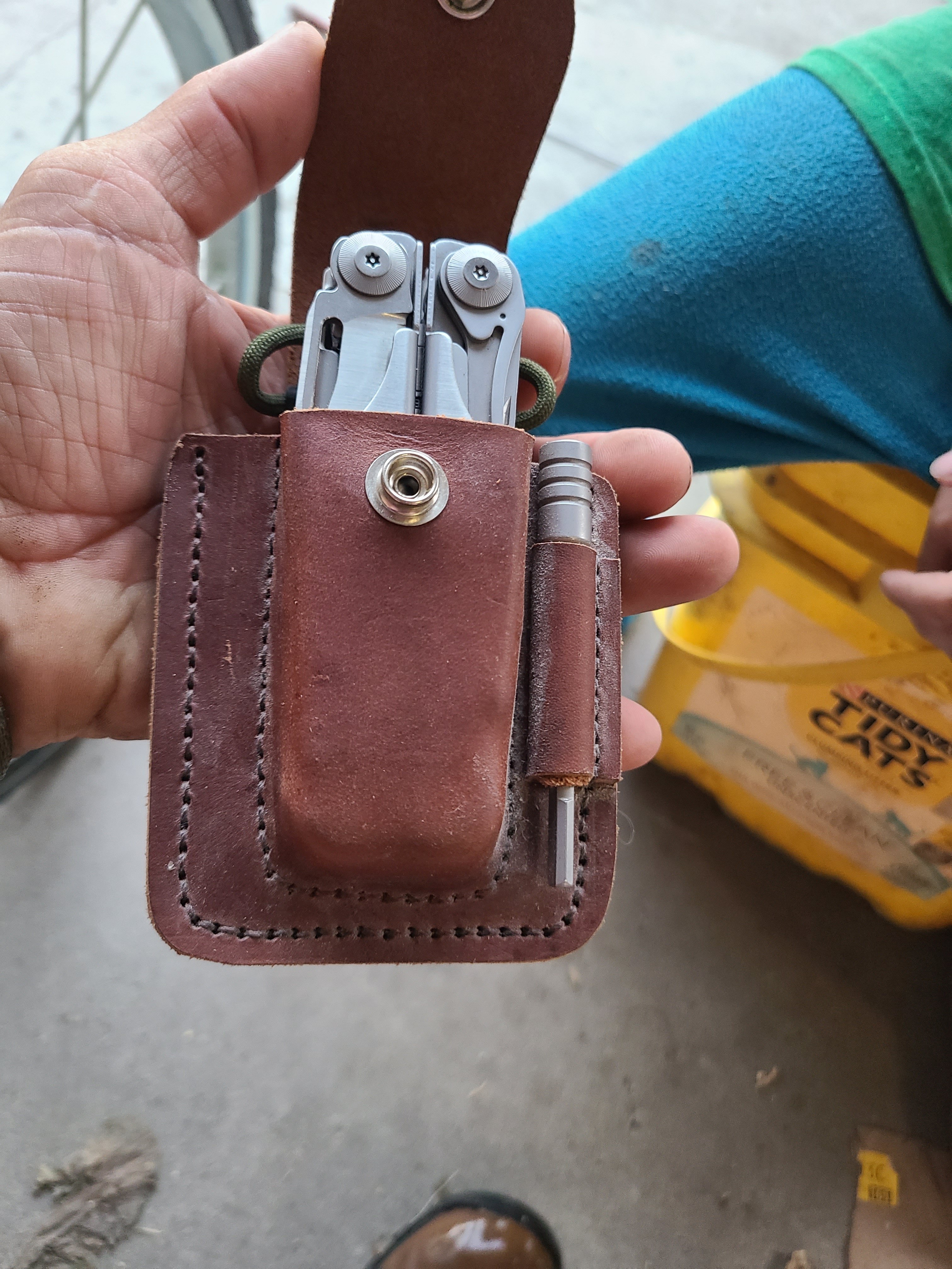

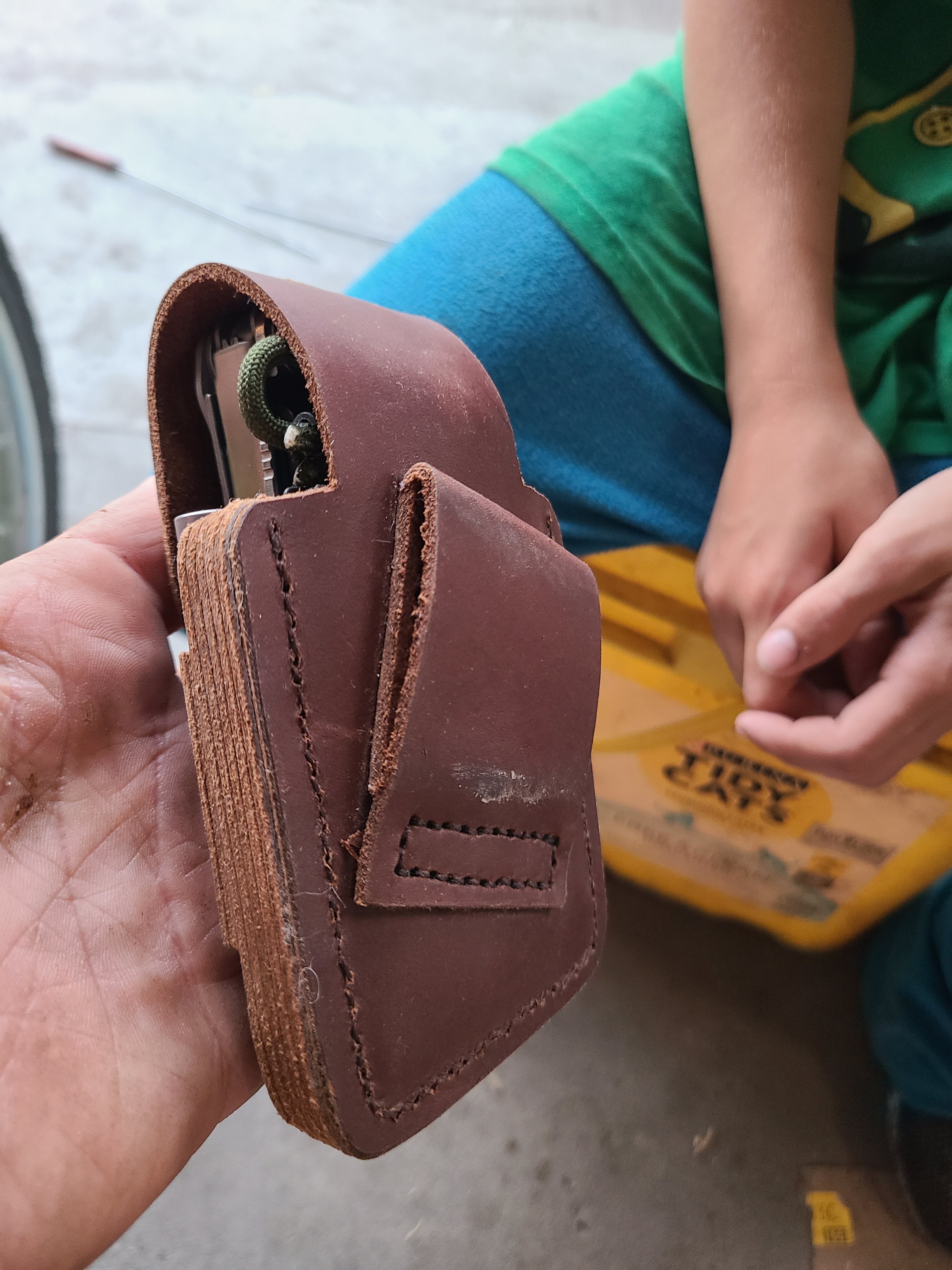

Another project with folded leather loop and as far as the clip i bought a bunch of supplies for making kydex holsters so i have several different belt clip styles they all came from a holster making supply site i dont remember the site name i still dabble in leatherwork its fun to make stuff the pics are of my leatherman sheath
And my leatherworking came from needing knife sheaths for my custom knives no classes for me in school 30 some years ago
