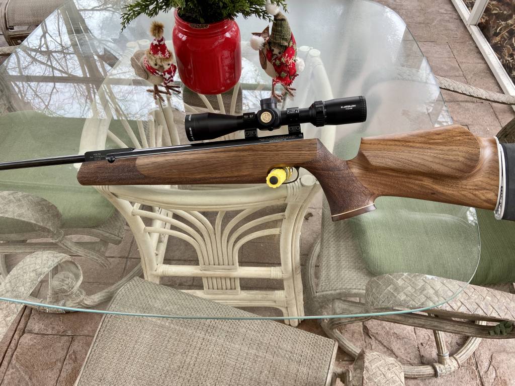

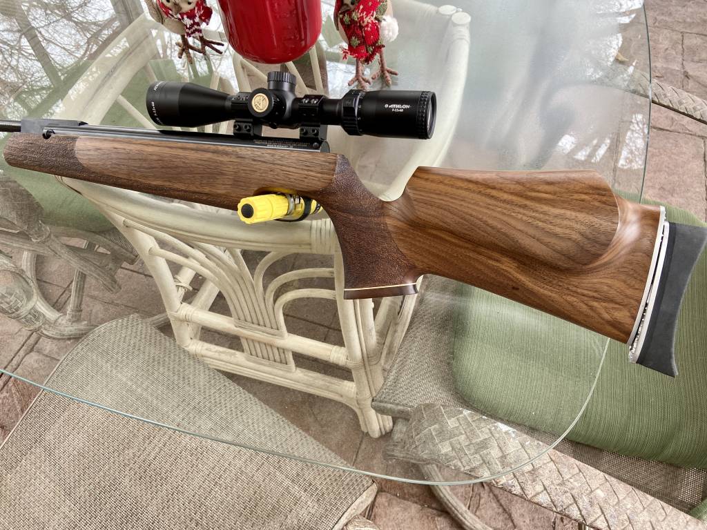

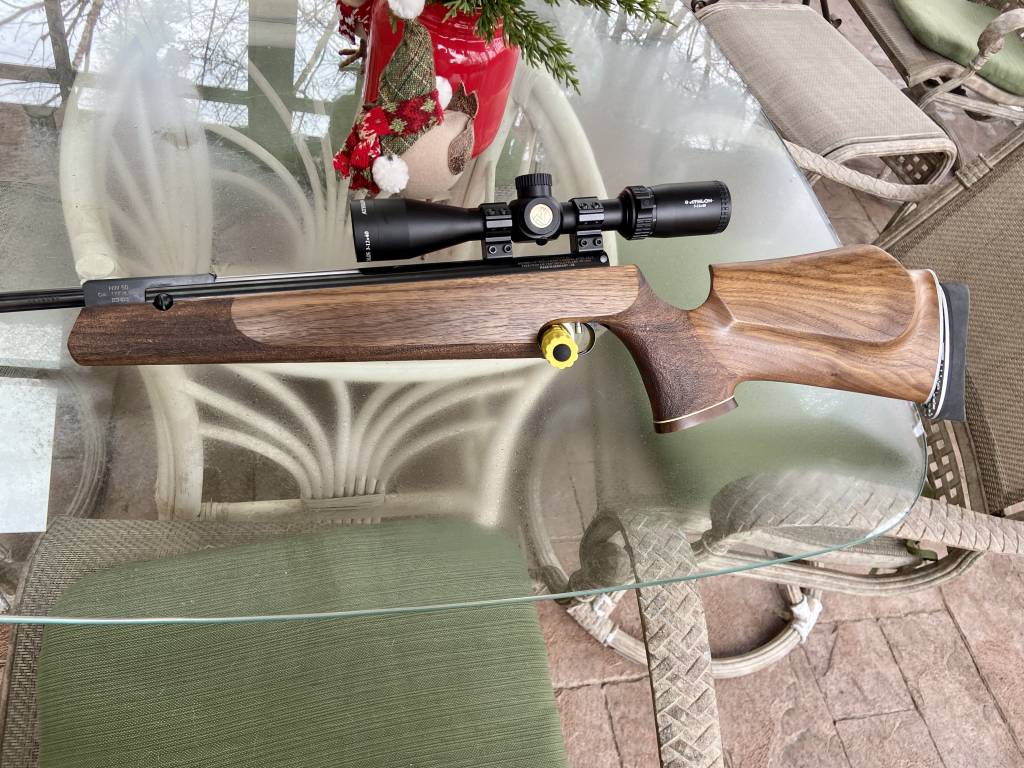

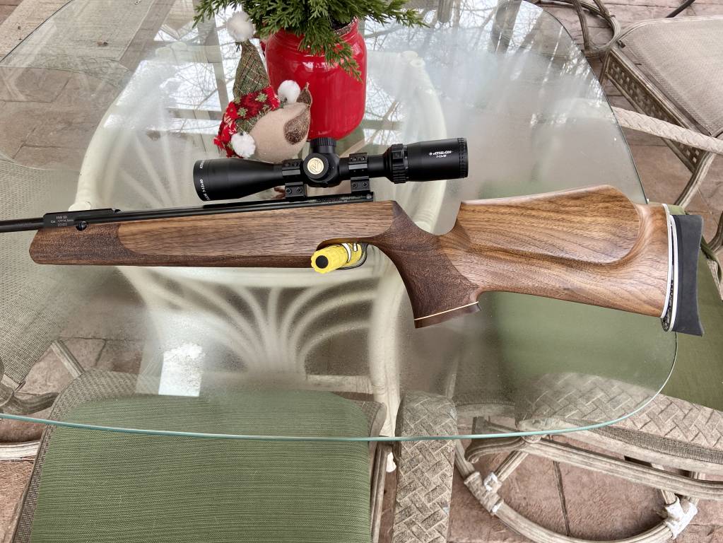

I also ordered a Walnut stock from Custom Stocks LTD and it came right before Christmas, it is beyond my expectations!!

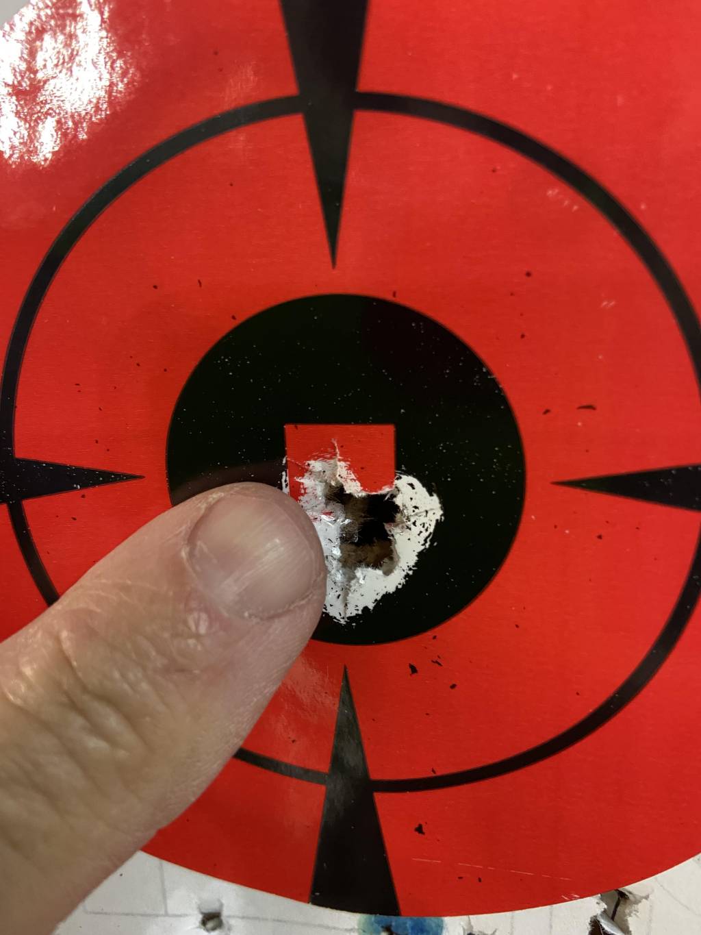

Target is 7 shots from my indoor range 17 yds.
The spring kit from ARH is a game changer, an amazing transformation!
Conversion rate to usd is at roughly $340 after shipping. https://www.customstock.co.uk/product/cs500-sporter-air-rifle-stock/  (HW99 overseas)
Wanted to note the light doesnt do the wood on mine justice. You can see towards the top more what it actually looks like. Pretty decent chatoyance on the whole thing.
Does the HW30 go by a different model name in UK like the HW50/99? It appears they don't have an option for the HW30?
I really like my HW30 but the stock doesn't fit me great. I can deal with the cheek weld and length of pull but the swept back grip is a bit much for me. The more vertical grip and thumb rest for your HW50 looks like it would be really comfortable.
I've been thinking about an HW50 anyways so the availability of this stock will likely just push me over the edge.
