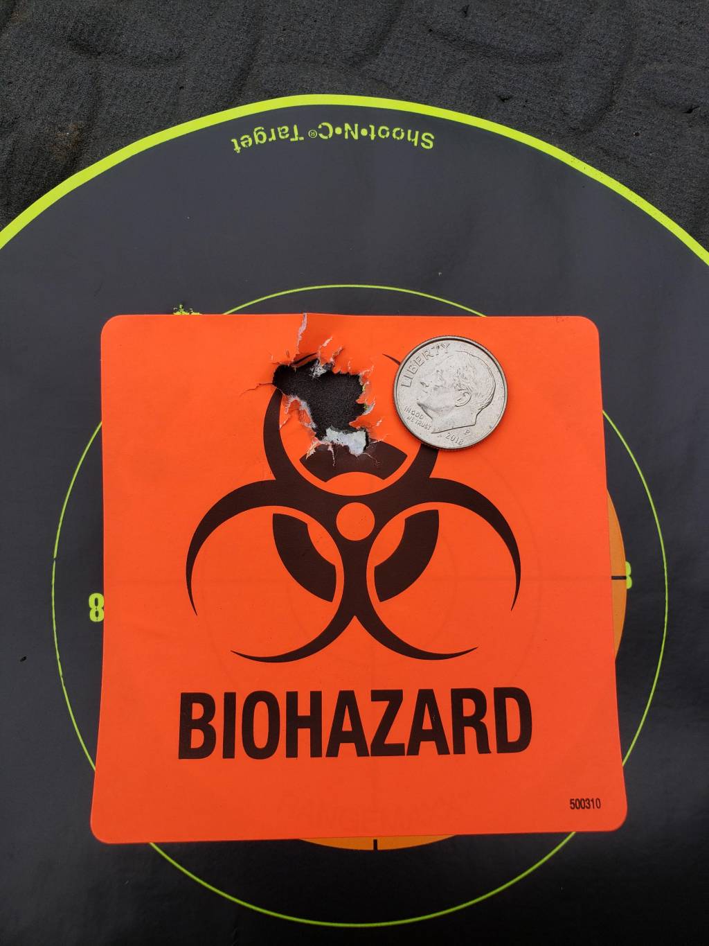

Long story short; bought a .25 skyhawk last year. The best it would do was 2" at 12 yards.
Sent it back for refund. Bought a walther reign. Same thing! Back to sender!
PA had a refurbished .25 cal skyhawk and I thought maybe I could win the barrel lottery.
I shot 10 shots under a dime at 40 yards. I can live with that.
I love the p15 and Skyhawk guns. They are light, handy and in my opinion the best ergonomics for hunting in my small blind. Unfortunately that barrel lottery is preventing me from getting one and spending the cash to put a LW on it puts me in a price bracket that would purchase a fine gun right out of the box. Maybe I will find one used with a LW barrel on it. Glad you got a good one. I'm super jealous.

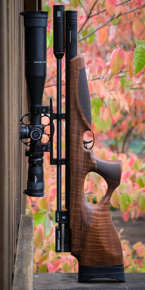

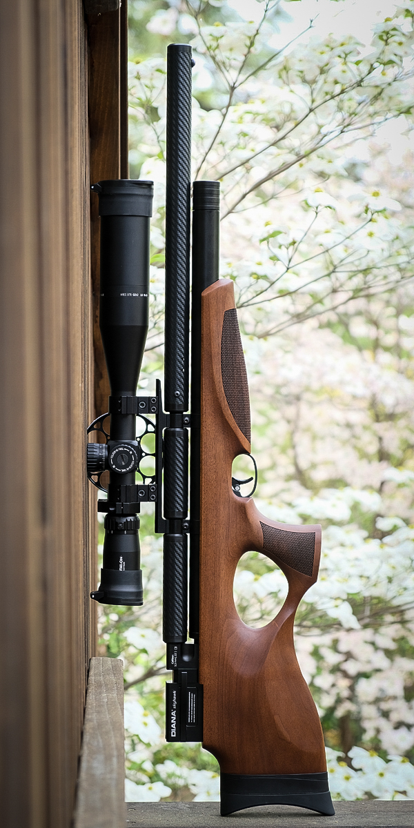

Congrats on the barrel lottery. I bought a .177 and .22 and they both had crappy barrels. I bought a known good .177 barrel from another member here and had a CZ barrel machined for my .22. I beefed up the trigger linkages in both guns, added HUMA regulators, and replaced the o-rings with better quality ones. Both guns are now very accurate and a pleasure to shoot. I also bought enough of the odd spare parts once I found out that these were discontinued.
