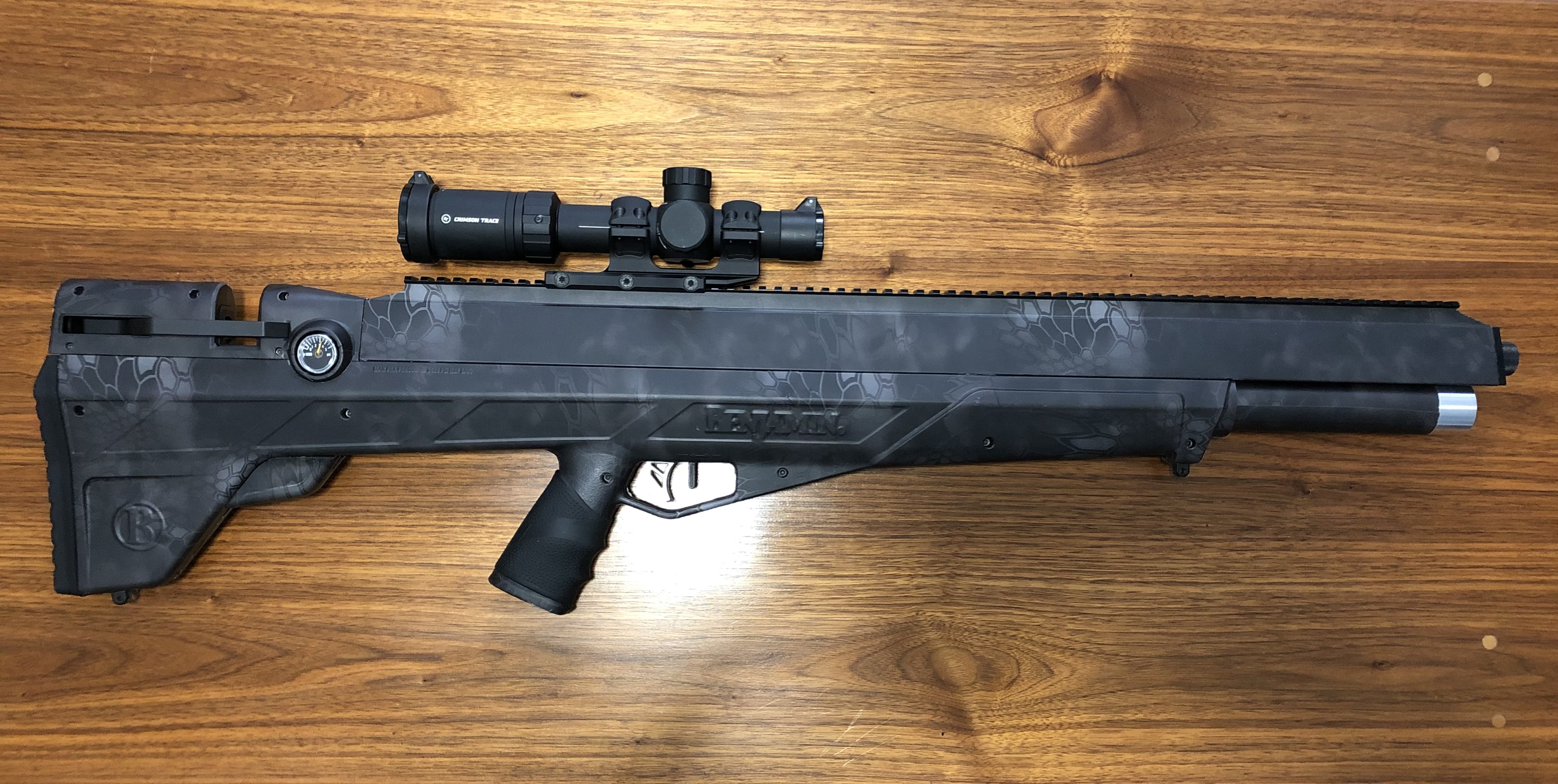

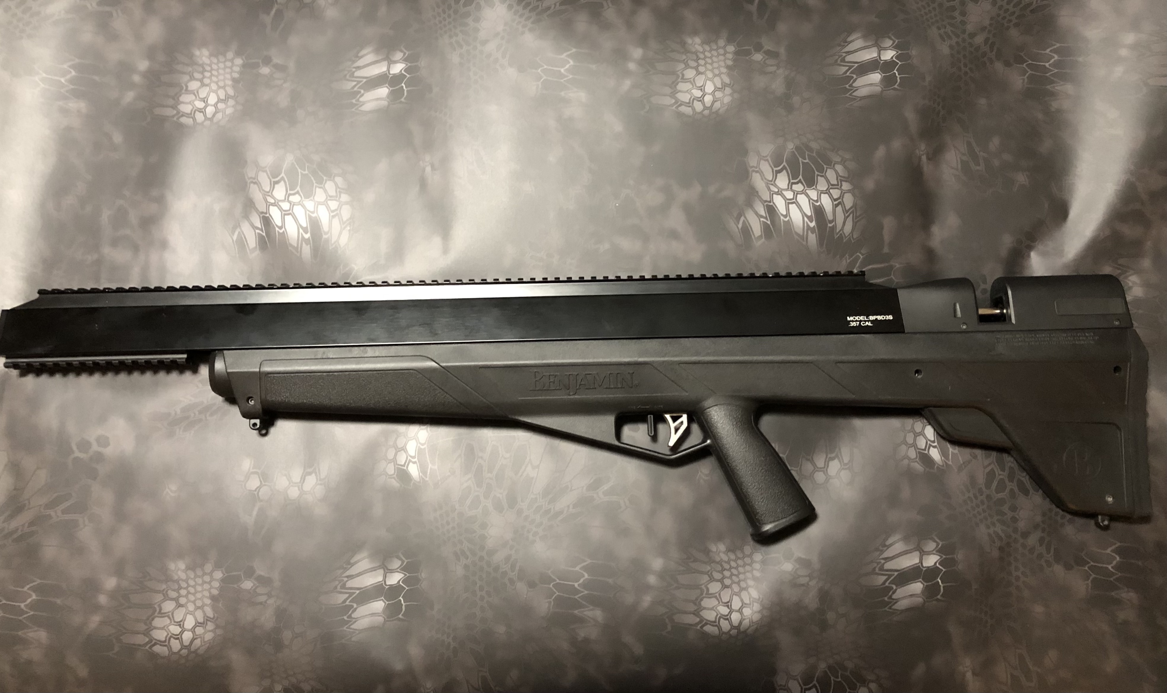

I think doing something like a wrap really helps the look out. They have a very noticeable two tone black in factory form that makes the shroud jump out when you look at it. Having it more evenly finished makes it blend together better and changes the look completely. I wrapped mine in Kryptek Typhon and am pleased with the results. As far as being reliable, I haven’t had any issues and you don’t hear of that many. I think Benjamin started making these back in 2015 so it’s not like it’s a new platform with bugs still needing to be worked out.
I agree the wrap is a definite improvement! Thanks for the side by side comparison
