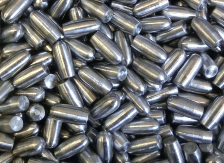

Top 6 shooters used Altaros slug at the S.P.A.W Slug-athon competition
Congratulations to all top competitor on the great results and especially to Bill Squillance on the top score of 246 points 👏
The message to other shooters is clear, if you want to win, you know what slugs to use, especially if it's windy🌬️
Our most used slugs in competition are for .22 caliber ATP King 40gr
For .25 caliber they are ATP Smooth 50gr and ATP Queen 60gr
