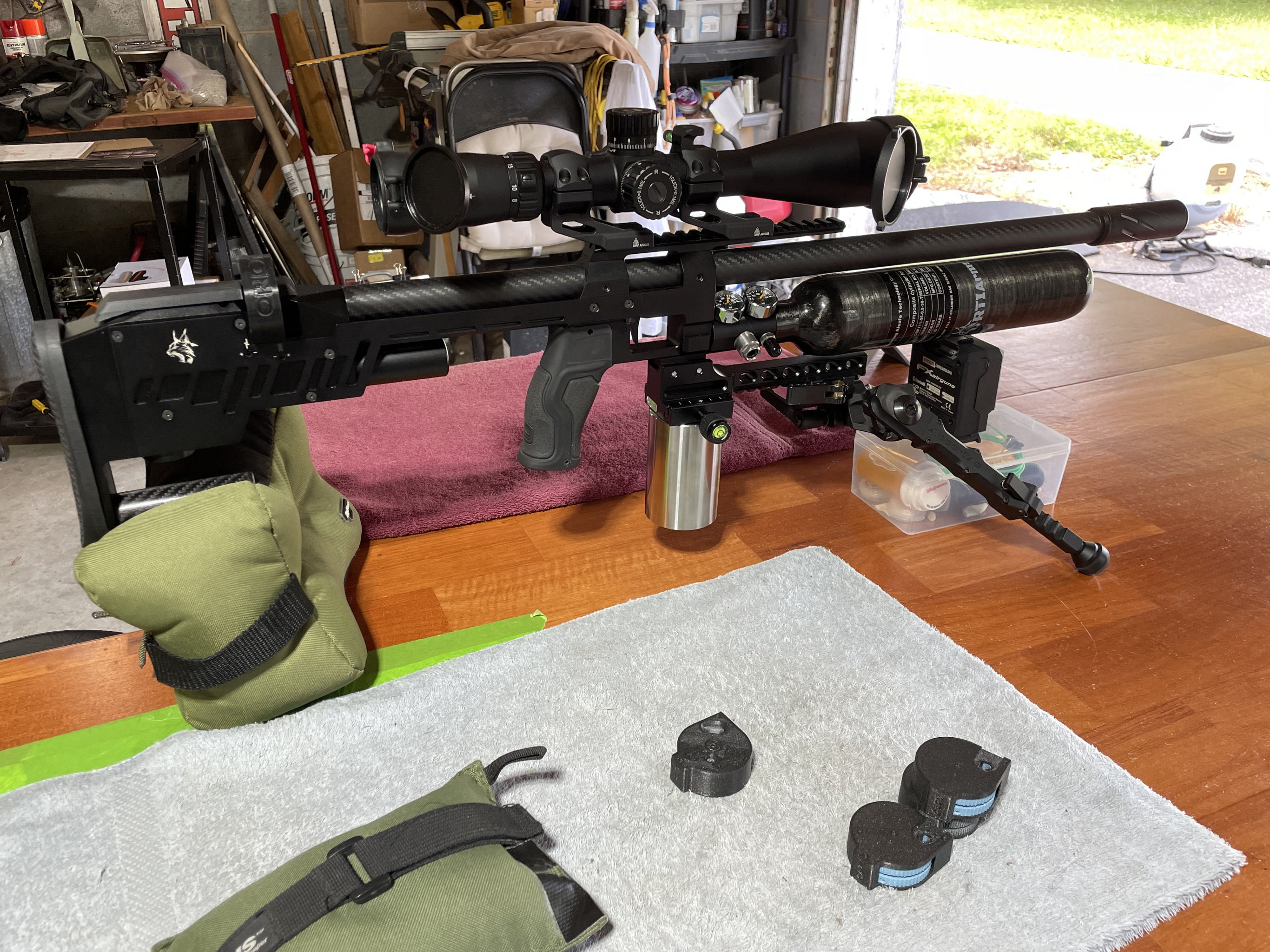

@beerthief - i've been thinking about how to create counter weights on my tube guns

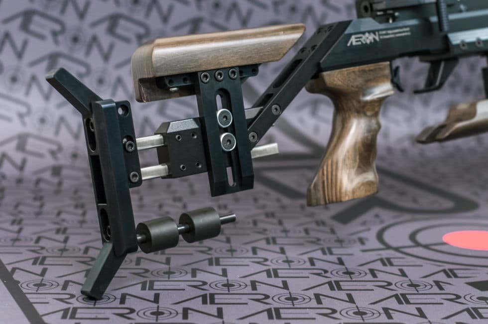

but just as difficult as the center of gravity thing is finding / getting a proper and consistent eye box. Thankfully some talented shooters at the AAFTA National event, showed me how to lower the butt as far as possible and then cant it outward to allow my eye to get behind the scope more evenly. Next i ditched my progressive lenses and re-did ALL my parallax wheels / scope ranging markings. All these changes together are definitely for the better. Yet i noticed that my bottle guns were easier to control in a forced position and didn't cant in the sticks as easily. I am all about getting the scope as low as possible... really helps with those close in holdovers. The picture posted show Aeron CZ's counter weight idea... not quite enough to stop the canting/tipping. Work in progress. Really appreciate the ideas from everyone... that's why we are here.
maybe these counter weights but moved forward on the front of the knee riser ? putting it right under the scope ?

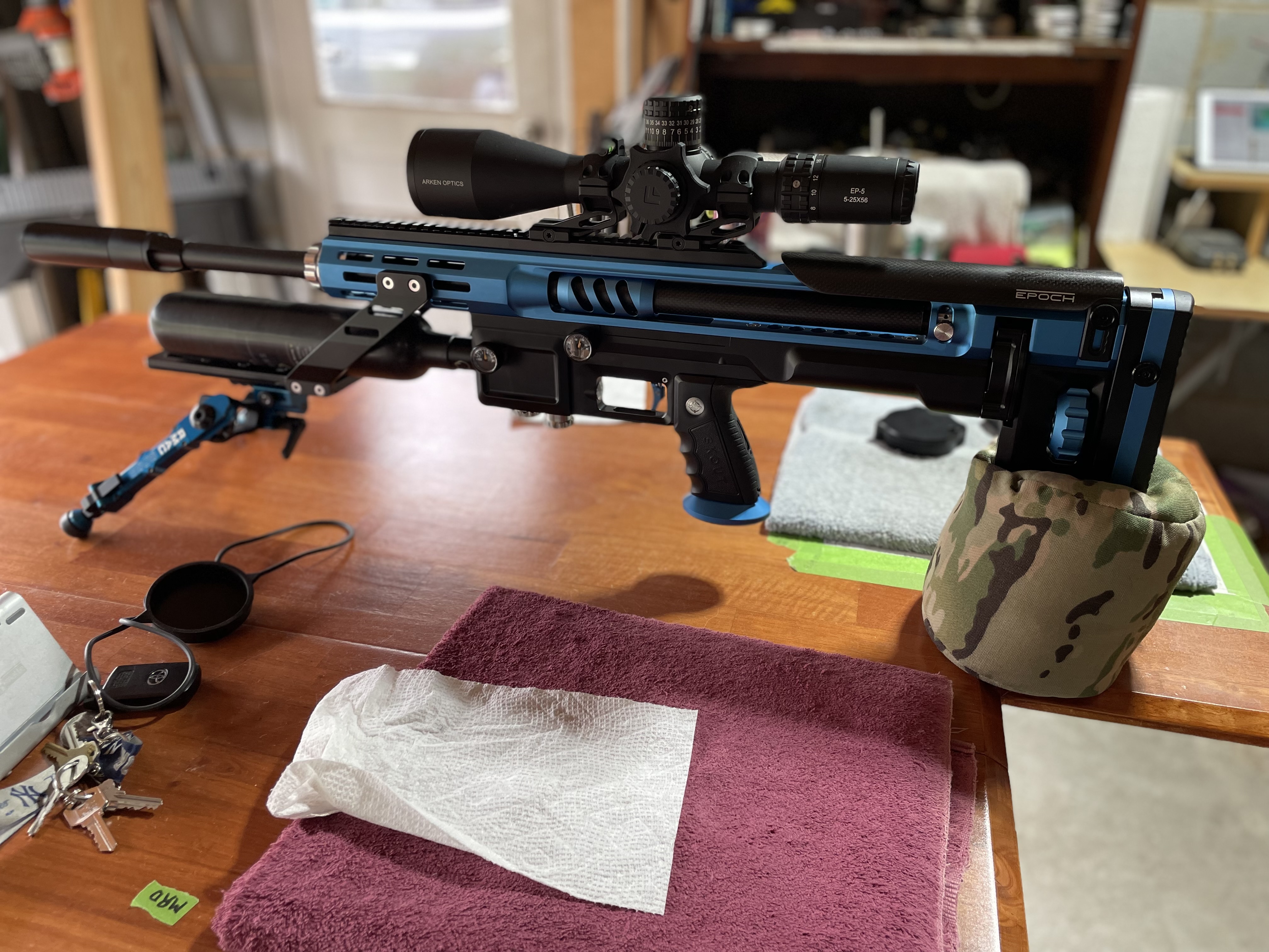

Traditionally, most old timers seem to prefer mounting the scope as low to the barrel as possible. That mindset seems to be mostly associated with traditional "sporter" shaped guns.
In this day and age of bullpups high scope mounts are simply reality, and again, not necessarily a bad thing. It certainly effects holdover/turret adjustments, but can be easily accounted for, just like any other factor.
That is what i learned simply by accident... the bullpups required a higher scope mount to get me "the shooter" into a reasonable eye box position. While the bulpups offer a lower center of gravity and more weight at the shoulder there are def. trade offs.

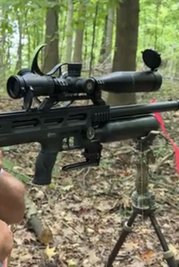

If you want to add weight why not just put it on the pic rail in front of the trigger similar to where this is. I use it for standing so its easier to get my elbow into my side

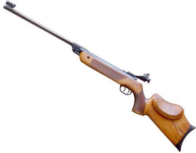

this is a tyrolean stock on an airgun... in case anybody is curious.

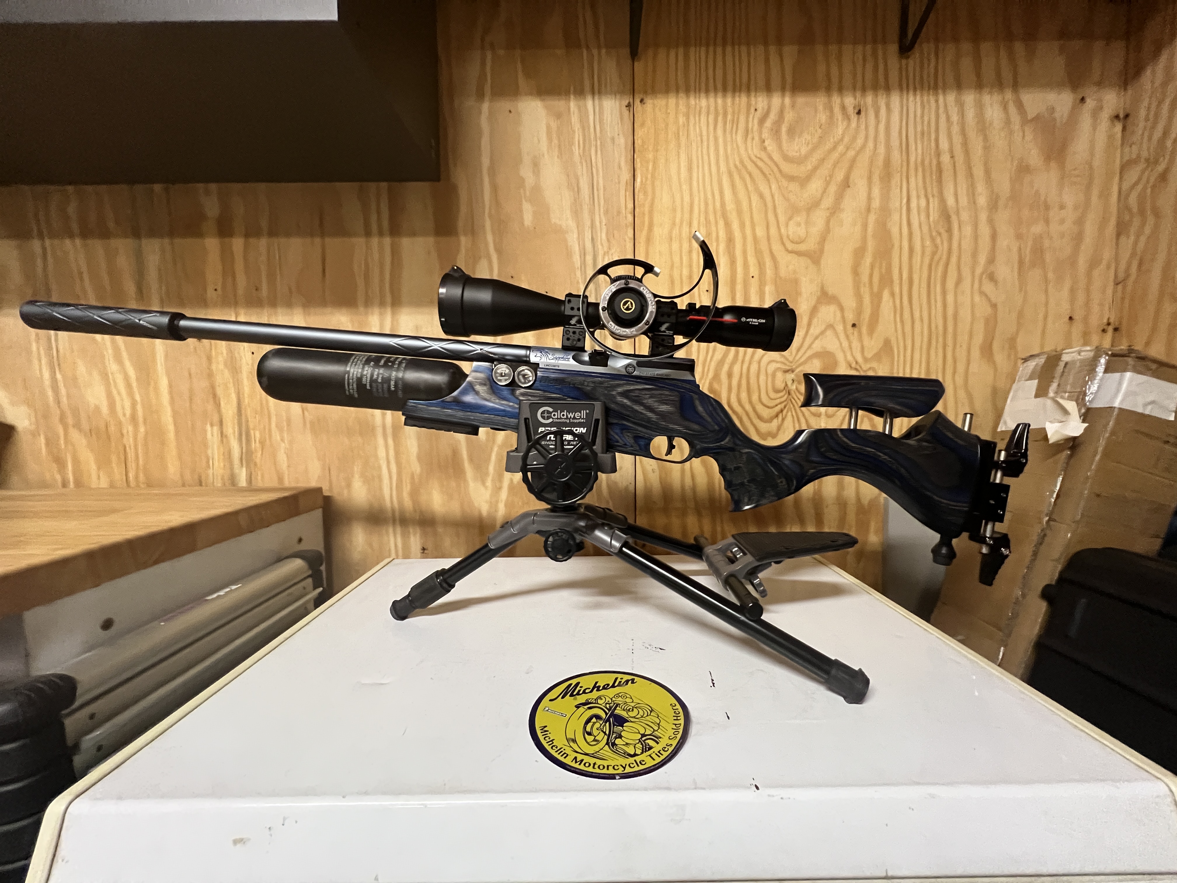

In the end the solution was weight distribution.
1) Air-bottle type guns seem best, especially in a shorter bottle configuration
2) lightest scope possible
3) position scope as far rearward as possible and still have a good eyebox
4) use a butt pad that grips the shoulder capsule
5) use a knee riser pushed as low and rearward as legally possible.
6) use a stock with a highly adjustable comb
The below setup would be absolutely perfect if it had a 330 cc bottle

Nice synopsis.
I think you just enjoy teasing me with that Sapphire.
