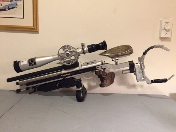

 I managed a win in open class at the 2016 FT Nationals using a 15” barrel. Jim Stanis and I had a shootout for first. Jim was also shooting a 15” Thomas .
Greg Sauve won the 2017 FT Nationals WFTF division with a 15” barreled Thomas. I took 2nd also with a 15” barrel.
Greg won again in 2018...still using a 15” Thomas. I didn’t shoot last year due to a torn ligament in my knee...but I think there were 7 other Thomas’ in the top 10...most of which were 15” barrels.
Here’s a pic of Greg’s rifle.
The 15” barrel shoots quite well....and you are not leaving anything on the table.
