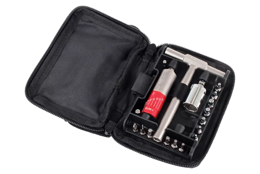

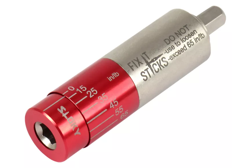

If I get a Fix-It-Sticks, should I get the 6-25 Inch/LB or 15-65 Inch/LB model?
Thanks
Most cross bolts for the scope mounts usually require up to 65 inch-lbs so I would go for the 15-65 inch-lbs version so you don't limit yourself. Anything above 65 inch-lbs then you might want to move on to a traditional torque wrench in foot-lbs for more leverage. Anything below 15 inch-lbs, then you might want to get the individual torque limiters from Fix-It-Sticks but that's just my opinion. One of my Nightforce scopes requires a 4 inch-lb limiter to set the zero stop so I picked one up and added it to my kit. One of my only gripes is that the kit doesn't come with all the 1/4" allen hex bit sizes so I added the following; 1.5mm, 2mm, 6mm, 9/64", 7/32", 7/64", and 1/4".
