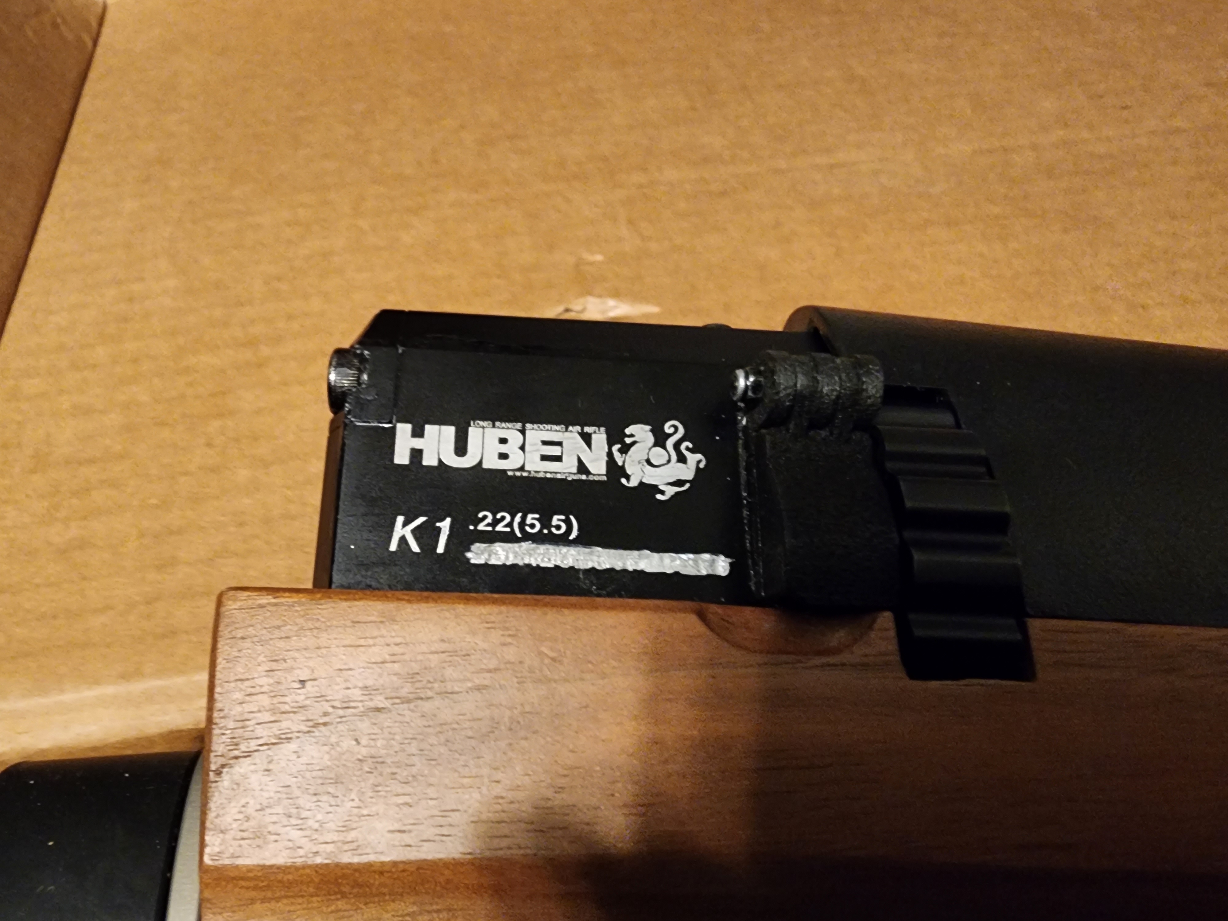

Now that I have my stolen huben back in my possession thanks to @jbull again for doing the right thing and kelly for getitng it tip top shape and back after being mishandled. The clown scratched out the serial number it seens to be just surface deep as I ran my nail over it and it's not very deep. I was wondering if anyone has found a touch up that works on this types of parts as I don't want to strip and redo the entire part. I bought Oxpho-Blue Professional Grade Cold Gun Blue (Cream Formula) which looked like it would work but it had no reaction. Any ideas would be greatly appreciated.

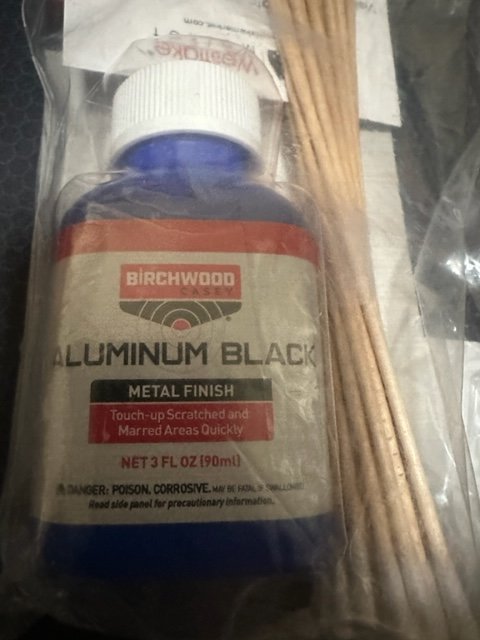

Cold blue only works on carbon steel. Being anodized means your Huben receiver is aluminum. I find Birchwood Casey Aluminum Black works well for touching up small areas like on your gun. It works just like cold blue, but for aluminum.

I've tried Aluminum Black and it didn't work that well for me.
Looked more dark brown than black plus it rubbed off pretty easily.
Just my experience.
Maybe you can have better luck with it.

I tried sharpie and it looked purple, wonder why yours rubbed off. I was thinking a paint pen but that's a little tougher to match. I was also thinking about having my laser engraver clean up that spot with a nice clean rectangular shape and than etch the serial number in and touch up with black paint or something. Luckily it seems it was just scratched off and not dremeled
