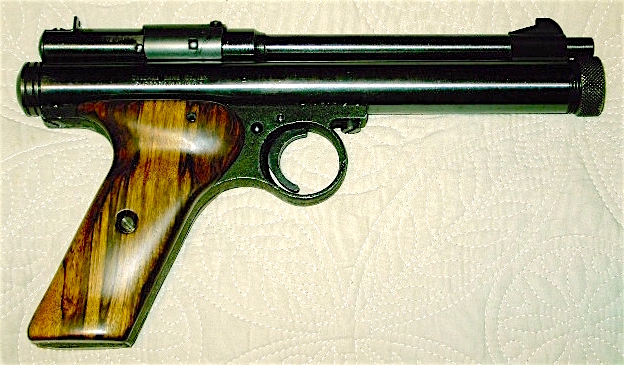

The most power in the smallest, lightest package is a first-generation, two-piece barrel Crosman 150 (.22) or 157 (.177) that were produced from 1954 to 1956. Just as powerful and accurate as the later, one-piece barrel versions, at 9.5" x 5", just 27 ounces, and capable of 6 foot-pounds in .22 (and hot temperatures) they are capable of small game to farther distances than most shooters should attempt. They fit and carry nicely in a blue-jeans back pocket, and will shoot rings around larger, more expensive and CUMBERSOME choices.
More details and a nice photo as excerpted from Airgun Chronicles
