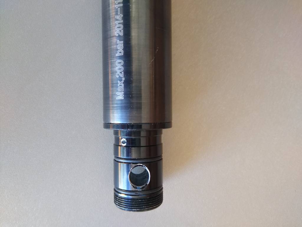

Hello everyone. Looking for suggestions on removing the Fill probe housing from the Air Tube. Aluminum housing with a Steel Air tube. Seems to be seized up cause it's not budging. Any tips or tricks would be appreciated. Tube is off Evanix Sniper-k. Thanks in advance.
Most important fully degass before proceeding otherwise it will be impossible and extremely unsafe to unscrew it.
Wrap that tube in leather like use a belt then put into a vise then proper sized drill bit smooth end as a dowel through fill probe fill hole use a long skinny metal pipe for leverage.
BOOM! Problem solved! Thanks!
