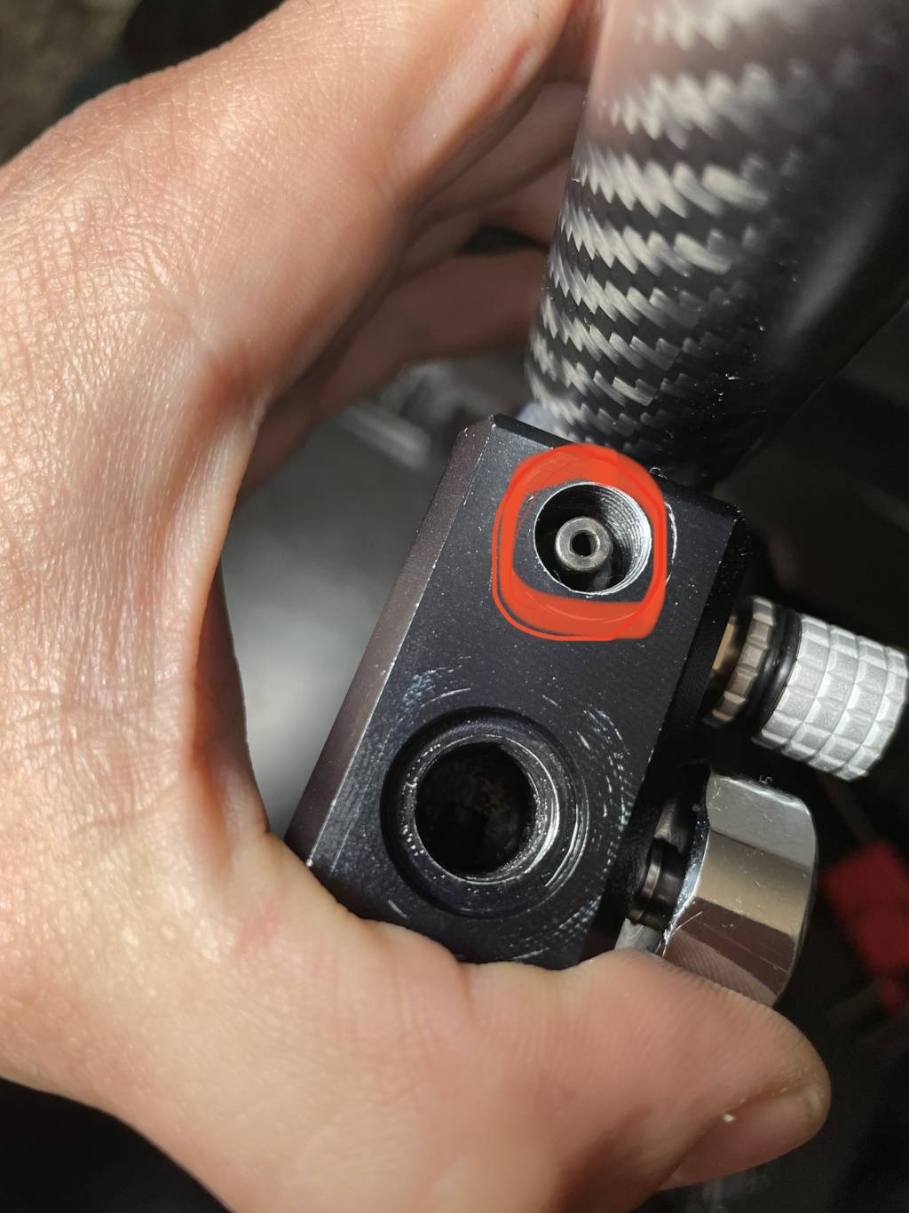

One night I wake up at 2 am and can’t go back to sleep. I pull out the sk19 and just stare at it trying to think of a solution. A thought pops up to push down on the piston that connects the reg adjuster to the reg. Disassemble the reg and press down on the piston and voila it’s pops out. Sure enough it had an o ring that was damaged. After swapping it out it now holds air perfectly.

@legionair I’m just getting into reg repairs and I’m not quite sure I understand your explanation of the problem. When you mentioned “the piston that connects the reg adjuster to the reg,” which part are you talking about? I don’t have an LCS rifle so I’m not familiar with the type of reg they use, but I’m interested in learning. Do you have a photo of this piston?

There’s a spring loaded knob(*external adjuster) above the bottle. The knob controls the reg pressure by turning it ccw or cw. When it is turned cw It presses onto the piston showed in the pic. The piston then compressed the Belleville stack to decrease reg pressure. Vice versa for ccw.
Got it. Thanks for the clarification.

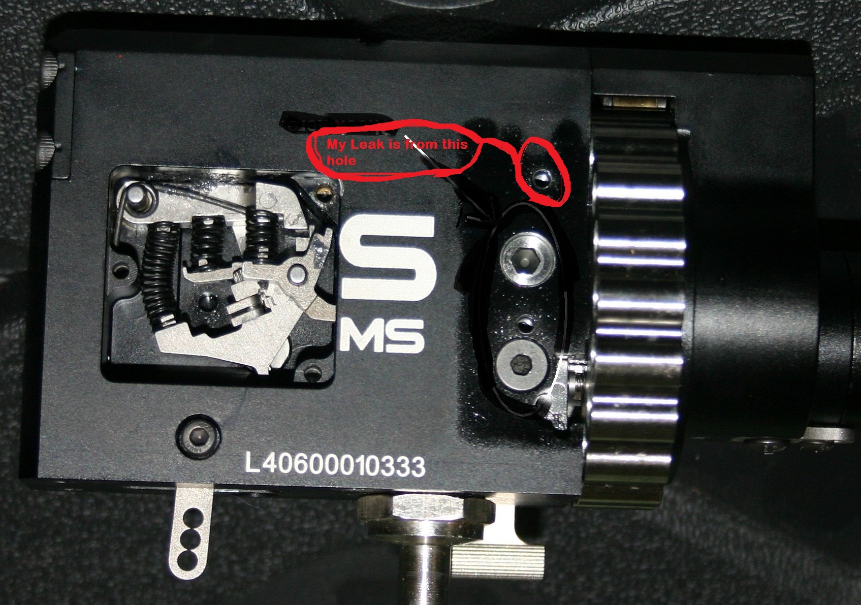

Wish my leak was that simple to find and repair. I have a leak somewhere in the back of the rifle blowing air somewhere near the magazine. I took it down as far as i could and replaced every o ring i found in there. Put together and.....leak. SUX !!! Guess i will break down and send it to AoA for repair. Just hope i didn't void my warranty
