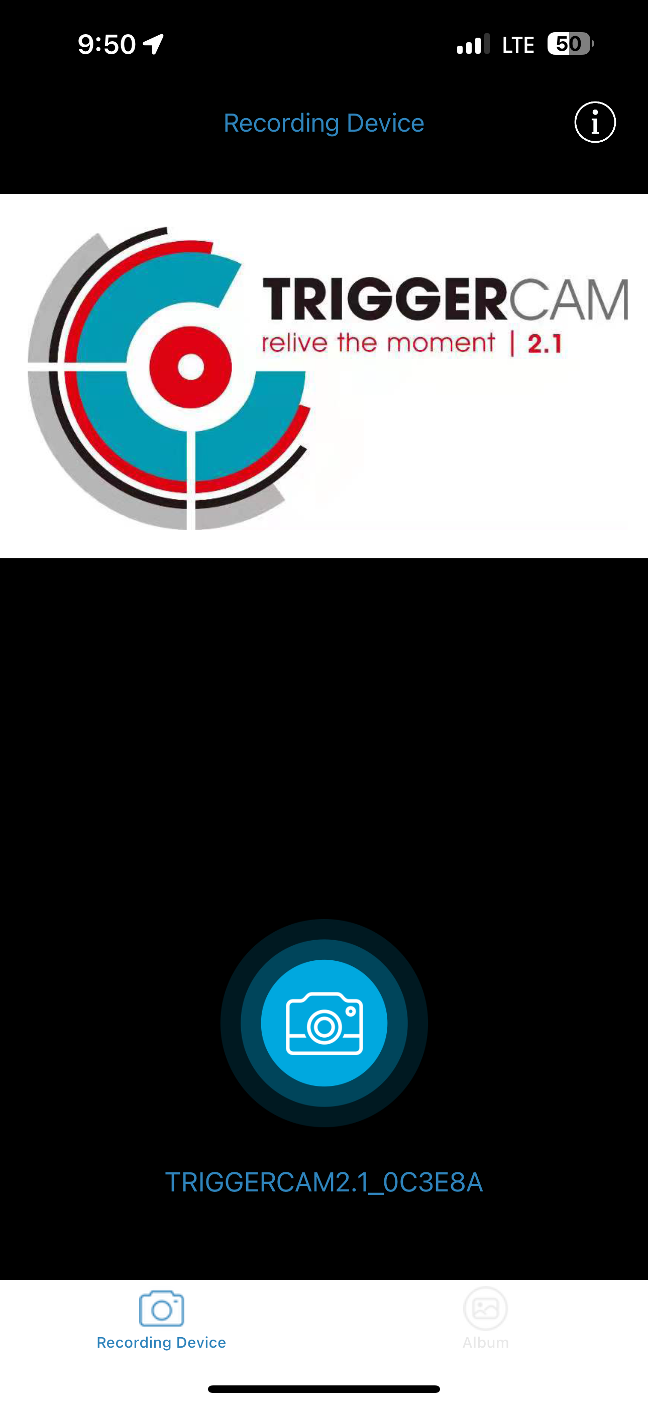

Got it, thanks, works on the the iPad and the iPhone. I was recording for close to an hour today and still have 67% battery. According to Savannah, you can use a battery pack at the same time, haven't tried it yet. I got my reticle sharp as heck but apparently my parallax was off a smidge or the lens in my Titian sucks, it was a touch foggy,s
What resolution and frame rate is yours set at? I could get mine close to that at the 4K@30FPS setting, but when I switched to 1080@120FPS it's not nearly as clear. I prefer the 120FPS speed for post processing slo-mo, but the video quality in this setting isn't near as clear and crisp as I get from my ATN 4K Pro using the same resolution and frame rate.
