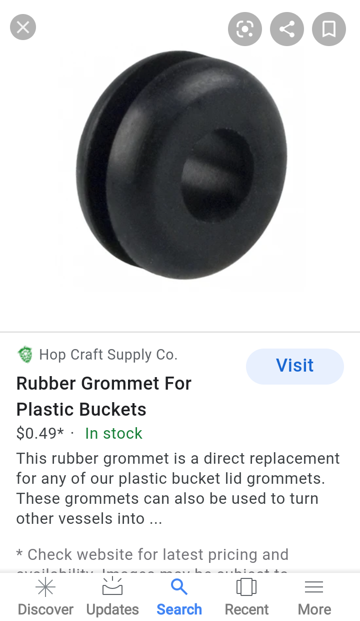

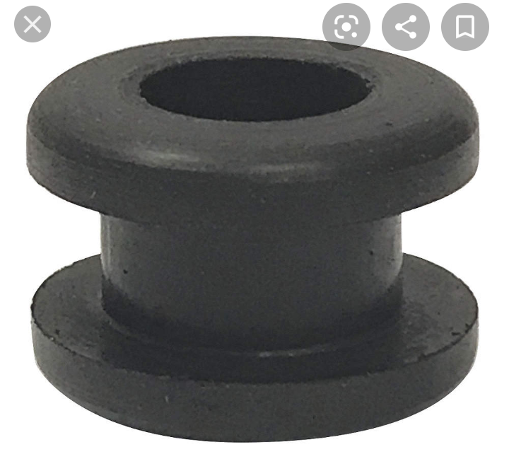

save money go to ACE Hardware and buy 2 or 3 that LOOK LIKE these only A LOT BIGGER to fit snug in air tube.
Or one of these whichever comes out cheaper and whatever you buy MUST fit snug in the air tube for them to work!

Looked at lows and Home Depot employees don’t even know what a rubber grommet is let alone what it might be on FML HA GOING TO ACE TODAY LITTLE OUT OF THE WYA BUT SO BE IT, atleast last time I went every one I asked working at ace knew there stuff in there section
places are going down hill
seem like they fired all the older knowledgeable employees from Covid and Hired the do nothing say nothing but go Uuummmmmm maybe uhhhhmmmm try tools ..... yes ok there I’ll try a rubber gasket in The power “tools” Section lol I broke down and just asked customer service and they had them in stock but the only ones I could buy were on a pack of 1000 So like if ace doesn’t have it I’ll just get it online like everyone else lol I just didn’t want to wait 5 days to get it but oh well it’s been about that long by the time I’m gonna actually he able to do it and if I can’t find it today I gotta wait another 5 days anyway haha
