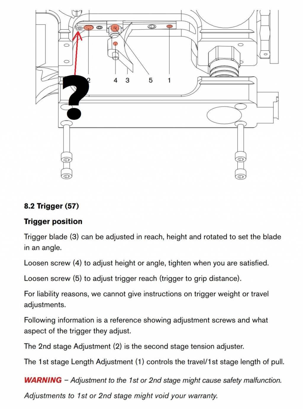

I have a couple questions. It says in the manual they don't want you messing with the trigger, but it also tells what each screw does. My trigger is at 1 pound 2 ounces, a good hunting weight but not the best for bench rest shooting. Has anyone adjusted thier trigger to a lighter weight? If so, how?
also, this screw I have to back in and out each time I adjust the rear regulator #2. When it's screwed in, the trigger won't fire, back it out and it fires again. What is it?
From looking at the parts drawing online, this trigger appears to use the same spring-and-ball arrangement for trigger weight adjustment as other FX rifles. It is an odd duck, and you're limited in weight adjustment. I installed the Boss match trigger in my Royale, which replaces that arrangement with levers, but I assume it will not work in this rifle. As mentioned above, you can try removing the first stage movement, making it a single stage trigger, which might help with a lighter adjustment. But that's not a setup I would trust for safety in a hunting situation.
